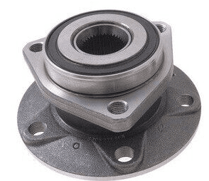

No - you can't re-drill the hub.
112 to 100 is only 6mm less in radius and would half over lap the existing holes, and you can't add extra holes 72 degrees in between as there is extra thick section where the wheel bold threads are.

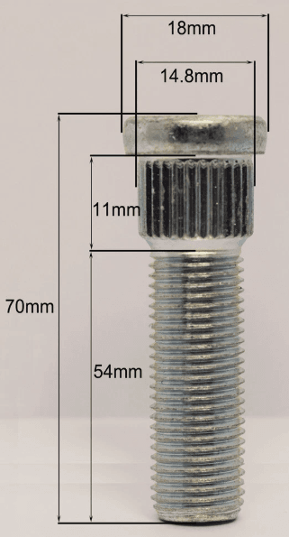

'maybe' you could re-drill 72deg apart and convert to a stud and wheel nut, rather than a bolt?
Would need to do some research on hub thickness where wheel studs are used? to see if there is enough 'meat'
I would guess it would be a thinner requirement than a threaded hole?
edit#
for example - does the thin section of the hub have 10-11mm thickness?
