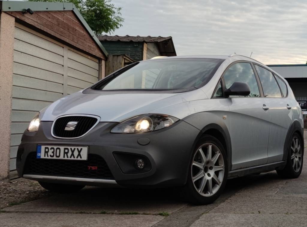

You have a very nice car (especially as it's a TSI) i've looked at a "Audi A3 TDI Quattro Sline car" and your rear has a lot less arch gap compared. As you have used standard xl springs at the front - It is definitely lower than a standard Freetrack. It's probably bouncy at the front due to the "spring rate". I think it's a great idea fitting "Eibach Pro line springs" and look forward to the results of: stance, comfort & driveability (y)
Are you planning to get Skoda Yeti 4x4 Eibach Pro springs?
Hi Mendez, yes nice to meet a fellow Freetracker! Thanks for the compliments btw!! I'll add a few more pics in a bit. Added some PFL xenons most recently which look great IMO.
Yes planning to get the Yeti 4x4 Eibach springs. The Sline springs I have fitted (rear) normally take 25mm off compared to non-sline ride height on the A3s, so a 35 lowering spring should theoretically take me approx 10mm lower at the back, and 35mm lower at the front which should be perfect.
When I fitted the std XL springs to the front they did drop the 40mm expected (as the Freetracks are 40mm higher from the factory). Tbh the front spring rate is fine, it's the rear that bounces more. I still reckon the A3 quattro springs are not quite man enough for the fatter rear of the Freetrack.

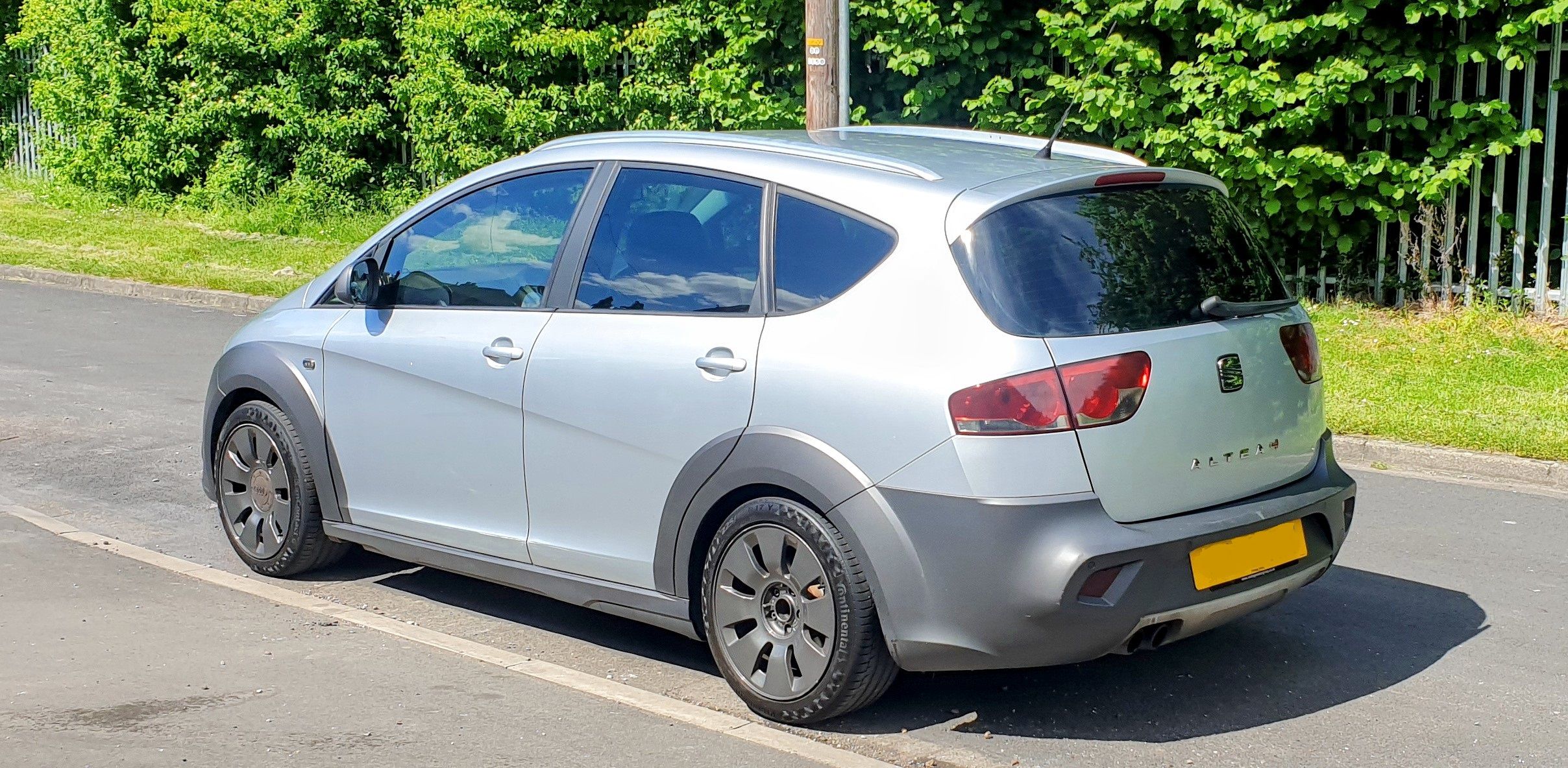

I've had a light smoke film applied to the rear lights and reflectors & replaced all bulbs with LED (including canbus decoders). I used red bulbs for brake lights, side lights and fog light, as white bulbs made everything look pink :sick: Side indicator/ repeaters have been converted to LED. I'm undecided whether to go ahead and do the same at the headlights. Last time i changed a front indicator - it was a bumper off and headlight out job faff...So it would be cool to see what your "PFL xenons" look like (y)

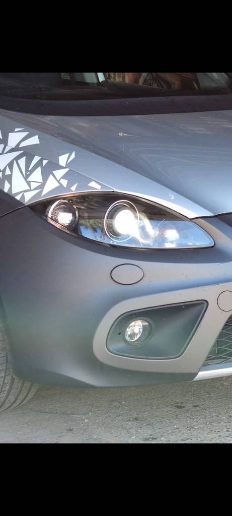

Here's the PFL xenons:

Those lights are epic!!
How long have you had them installed? How are they at night compared to OEM? Any adjustments needed? MOT passable?
Prob about a year, I have a friendly MOTer so never had a problem, but the car has washers so on the surface looks OEM and I dont think you'd have an issue. They are genuine Leon/Altea pre face lift xenons. I prefer them to the chrome dome normal versions you see on most cars. Much classier and look like they have been Joey-modded from the factory- and they seem to be cheaper than the chrome ones. They are Bi-Xenon but I haven't wired that function in yet.
Needed Kufatec loom adaptors as the connector/pinouts are different from Halogen clusters, and also if you don't code them properly in VCDS the bulbs will flicker. 6k bulbs fitted. Would prefer some 5k's but less places seem to do E marked ones in that colour.
Light output is ok, not as wow'd as I thought I'd be - could be colour temp though. I have a 2004 Touran that I also retrofitted xenons to and the output of those is definitely better comparably. These are Lumex bulbs as they are only £30 a pair for D1Ss, you may find OSRAM or Phillips are better for output.

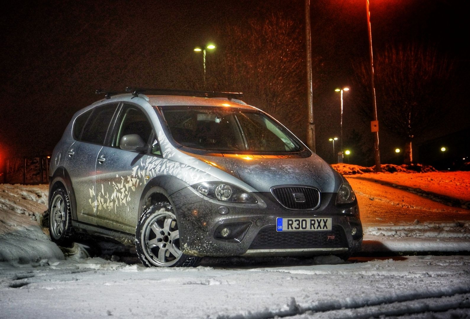

So the correct tyre profile for the Freetrack is 225/50/17. I decided to go with 225/45/17 as seen in my original images when I replaced them (way cheaper) but my latest tyres are 225/50/17. Slightly less arch gap and with he springs settled, looks pretty level
Until recently I was running 10mm spacers in the rear. There was the slightest of rubbing on offside rear tyre on tight corners at speed. Removed them because i had to do a "tip" run with a load of weight in the rear. Didnt think it was wise to kill brand new tyres. I will be getting the camber adjusted (probably need around 1-2mm to prevent rubbing) I recon if I had stayed with 225/45/17 tyres, I wouldnt have run into this issue as the tyres are less bulgy

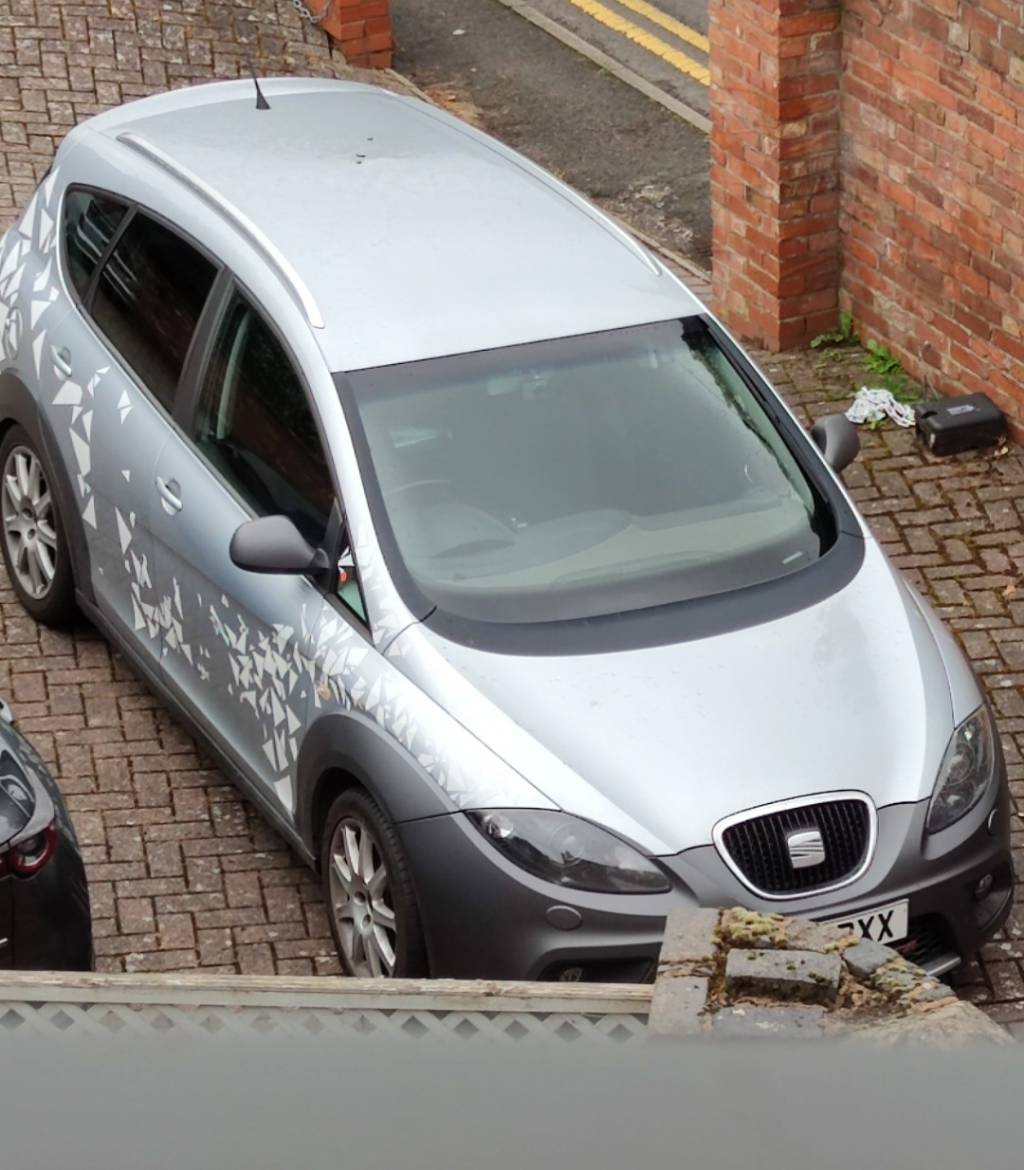

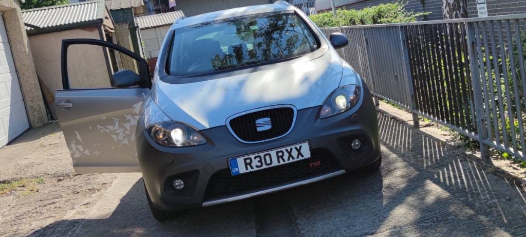

sorry for my late reply, I kept thinking about your request for most part of the previous week, but I struggled to find an entirely flat spot to measure the heights on.. The numbers varied between 65 and 65,5 cm in the front and 66-67cm in the back, but when I found a spot where left and right heights matched (for each axle), it read 65 cm front height and 66,5 cm rear. I neglected to take note of these heights prior to spring change, so I am hoping you could tell me your measurements on stock springs?
POV photo:
The front is lower than the rear (that is, with unloaded car), but I am happy for this, as this should help the car "follow its nose" while driving, thus improve the handling sharpness of the car..
Ground level photo:
