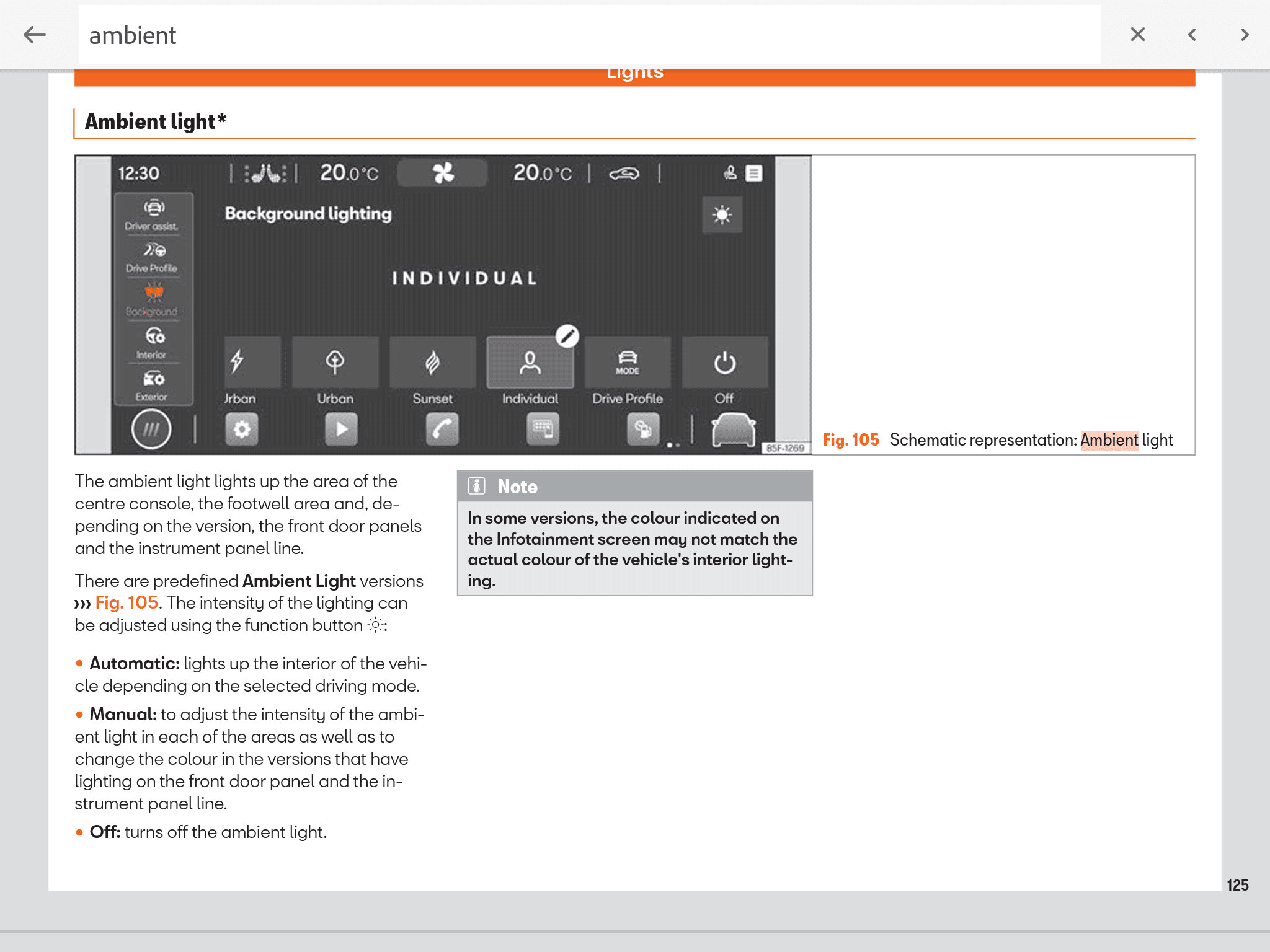

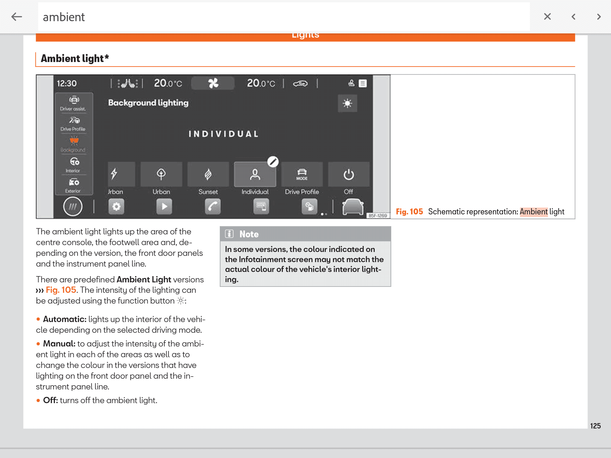

Page from the Leon 4 manual. Try this.
Is the car red ?. If the colour can't be changed the ambient light matches the colour of the car. Least in an Arona.
Page from the Leon 4 manual. Try this.View attachment 18477
Thanks. The car is grey so can’t be that the lighting is matching the paint colour. I’ve been in that menu in the car and no option to change colour, only brightness, must just be how it is ??‍♂️

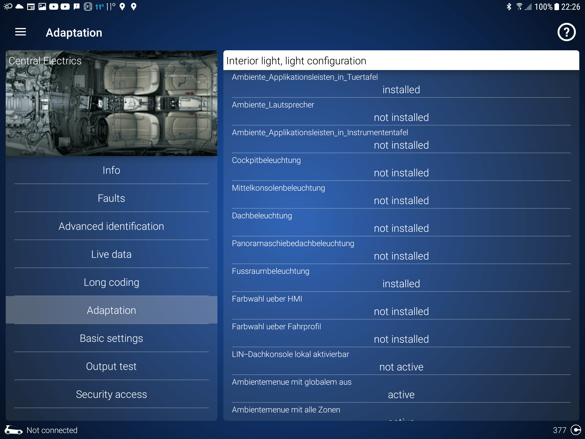

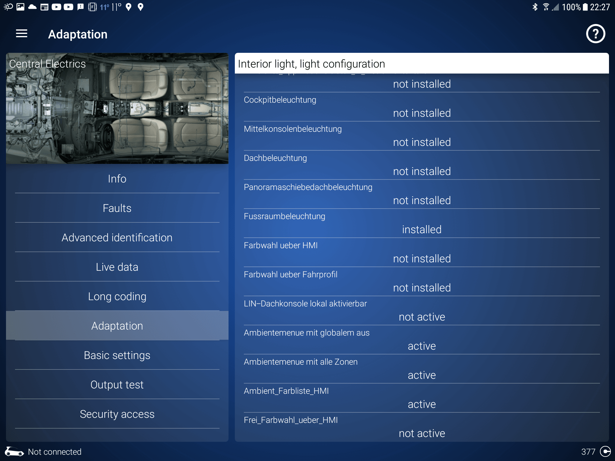

For what it's worth here is my ambient multi colour settings in Obdeleven on an Ateca you could check them with what you have or anybody else for that matter.
Build codes
185 QQ9 VWGROUP LCP Interior ambient lighting, type 2
Reckon that is the Led strip type above rather than the software programming. That's below.
You probably need the two to get it to work. Different build code and you probably have the single colour light. May also need the infotainment unit VCDS perhaps changed as well to enable the correct menu ?. Probably look at that if the build code tallied and the ambient light unit toggled....
The Arona with the fixed colour has this build code
181 QQ8 VWGROUP LCP Interior ambient lighting, type 1
Anyhow given this is posted on the Leon 4 thread where VCDS is currently locked down not a lot you can do. Browsing the build codes of a foreign Leon 4 I see they still use type 2 so I'd say type 2 is your fancy LED assembly, type 1 is fixed. I don't believe there is latent hardware sitting in there that just needs programming even if you could, but you can't on the Leon 4.
The hardware basically seems to be a fibre strip going into a LED light. Whether the multi colour ones are red green blue with three fibre strips or bonded into one fibre strip pass. Let those that rip their panels out find out :). Studying a parts catalogue may also inform but basically if the build code
QQ8 VWGROUP LCP Interior ambient lighting, type 1 it's fixed
Ditto type 2 it's multicoloured.
The run in code might vary but its the type 1 or 2 that's important.

Sure you haven't got it on automatic as per post 2 above which shows the page of the manual. Automatic tallies with the drive mode, manual you set the colour. The latter is the mib2 way of doing it with the multi colour display. Least with the firmware I got in my high unit... although there is a more recent one I note that might have introduced the automatic functionality of the mib 3.
So yes, if it follows the manual I would go into the manual method, automatic reflects the drive mode, manual you select the colour if the car is fitted out with the multi colour fibre internal door lights. Going to be that I would guess if it's kitted out with multi colour ambient light in the doors.
Failing that try rebooting the unit. Traditionally that was a long press on the on/off button. Touch panel. I did get the FeC up on a mib3 so long hold on those buttons or on some is implemented. That was the menu button, you want the on/off if implemented the same. Just touch for 5 seconds or so and see whether it reboots. Then go back into the menu and have another go.
