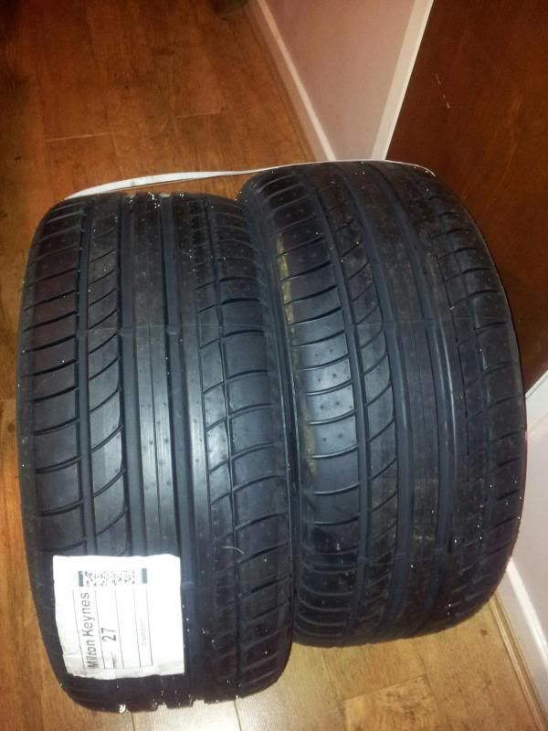

Finally had my new front tyres fitted today, Replaced the almost bald Pirelli tyres with Avon ZZ5
First impressions are the road noise is alot less!

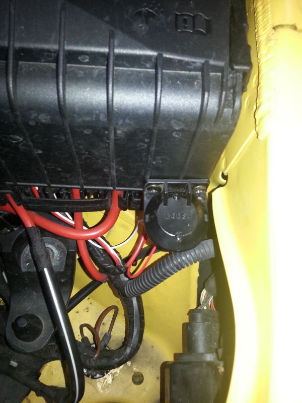

So i popped down to APR today to pick up my APR Boost tap and while i was there i got talked into the APR HPFP (Ready for stage2+)
APR HPFP

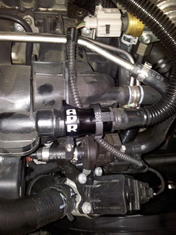

APR Boost tap
Changed GOAPR.com stickers to UK ones
Because i have have the APR HPFP they also flashed APR Stage1+ on which gives me more mid range power, Changed the Cam follower while i was there aswell
Rolling Road tomorrow night!

Whats happend to the original pump? it is still working good?
And what do these boost tap i cant figure it out
Thanks :)
APR keep the original one

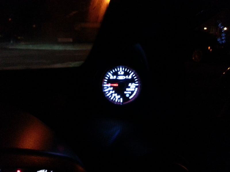

Boost tap is to attach a vacuum pipe to for a Boost Gauge. Boost gauge will be fitted soon

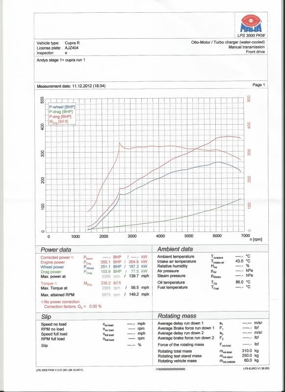

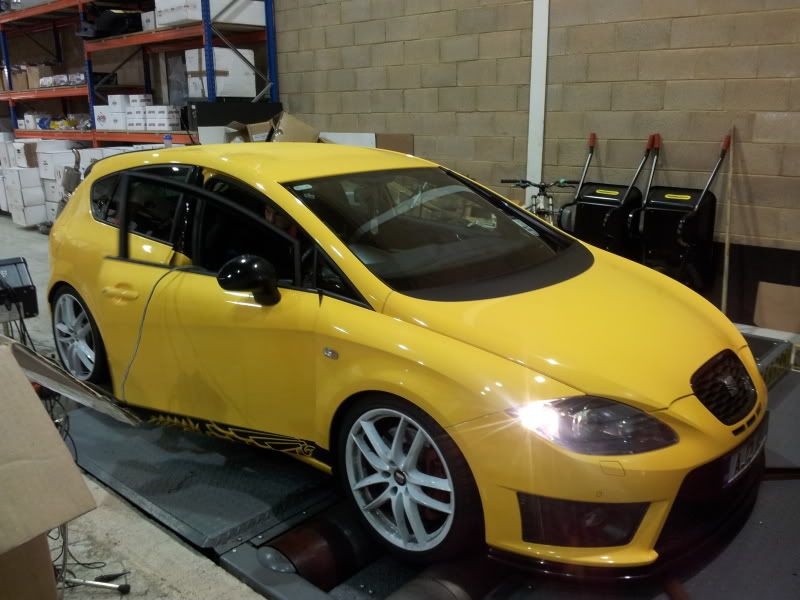

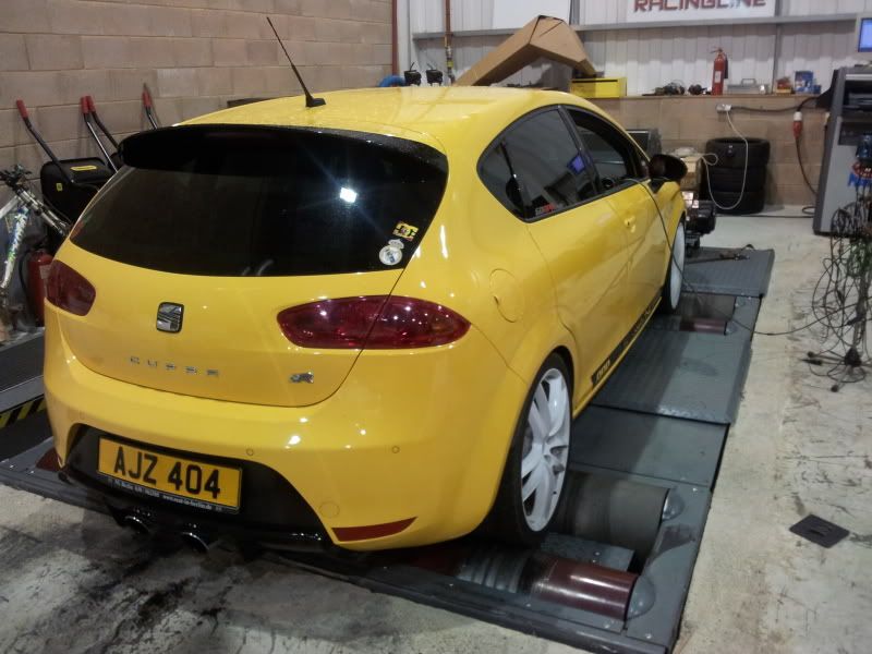

Finally had the car on APR/Volkswagen Racing's Dyno tonight, its a MAHA Dyno used to calibrate the VW Racing Cup cars
Current Spec:
APR Stage1+ (The + is to take into consideration the HPFP)
APR HPFP
Neuspeed P-Flo
Here's the graph
Now the Wheel Horsepower is very low so i put the question to Keith @ APR why? his response was
It's a MAHA and we see anywhere from 70-120 on these platform cars depending on wheel/tyre combo, strap tension, tire pressure, etc but the calculated bhp is always the same regardless of the difference in whp and bhp.
We calibrate for vwr cup race teams and they have to certify their power at other dynos and even though the other dyno reads whp higher and losses less, the bhp is always the same as ours.
I would say the explanation for such results at stage 1+ is that turbo cars love the cold weather.
Also to explain the spike at the start of the graph
It's the load being applied by the dyno during spool. It typically won't happen on the road.

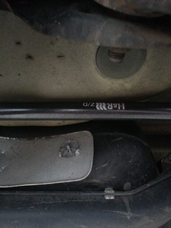

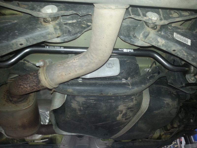

First thing was a H&R Rear-Anti Roll Bar (Front one is to be fitted at a later date)

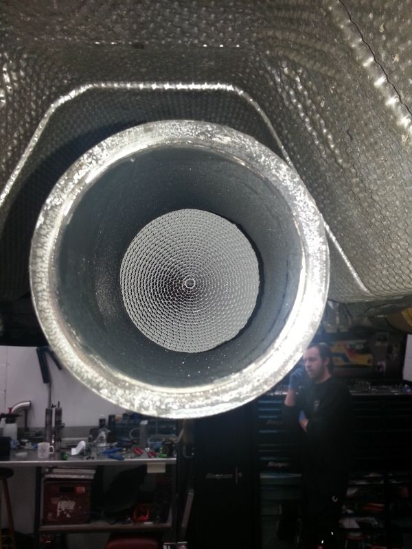

Notice how bad the OEM exhaust looks after nearly 3 years

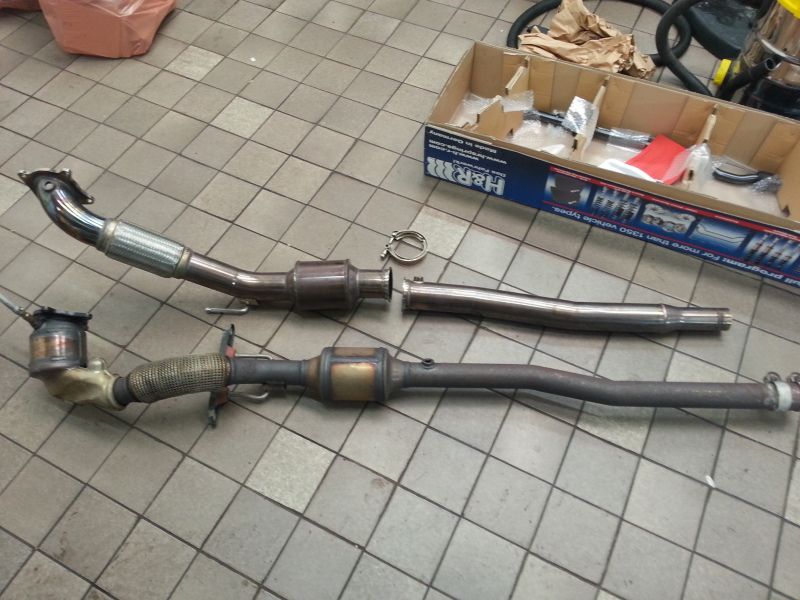

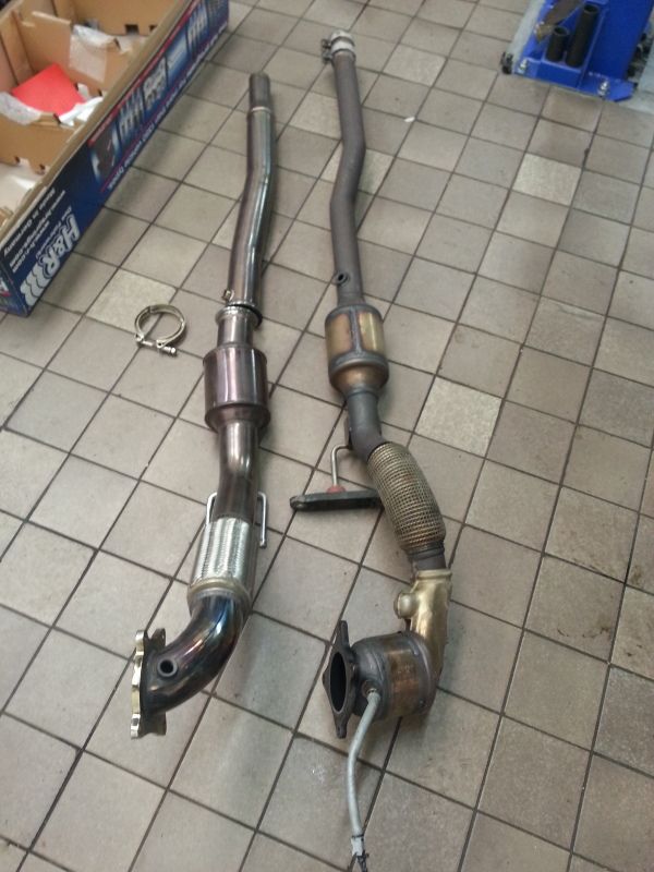

Next up was my Ebay special downpipe, 3" with 100cel sports cat, I took it to Alex and he has rewelded it and fitted a bigger and better flexi hose

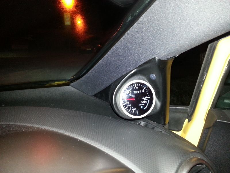

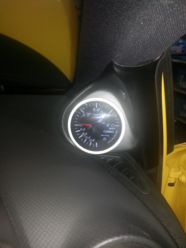

And finally Boost Gauge and Pillar Pod

P0420 Emission Code came up this morning on the way back from work, basically the 100cel sports cat is flowing to much and ECU doesn't like it
The Stage2+ map would sort this issue but the extra power would make the car completely un driveable due to clutch slipping on stage1+ so gonna have to put up with clearning the light every few days for a month or so
