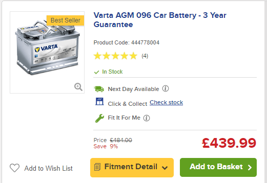

I have just looked up the price of a Varta AGM 096 to fit a 1.5tsi Leon with stop start from Euro Car Parts. The price they offer is a staggering £439.99 GBP, (474 Euros), reduced from a full price of £484.00 GBP.
Someone above described the cost of AGM batteries as "eye watering" they are not kidding, that's over four times the price of my first car a stunning 1976 Chrysler (Simca) Alpine in metallic gold with a chocolate brown vinyl roof !!!!
The Bosch one at ECP is even more expensive at £454.99 GBP !
