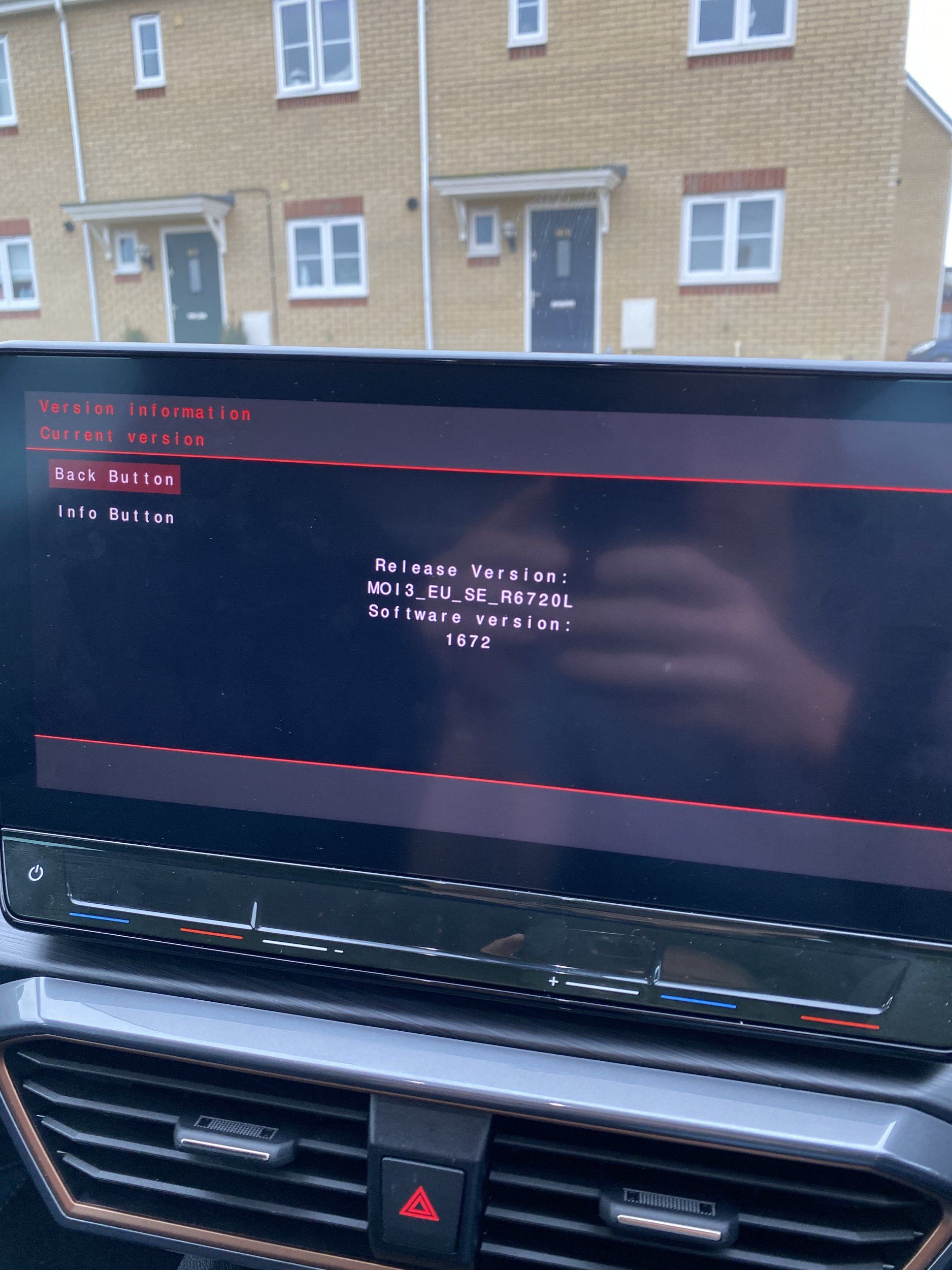

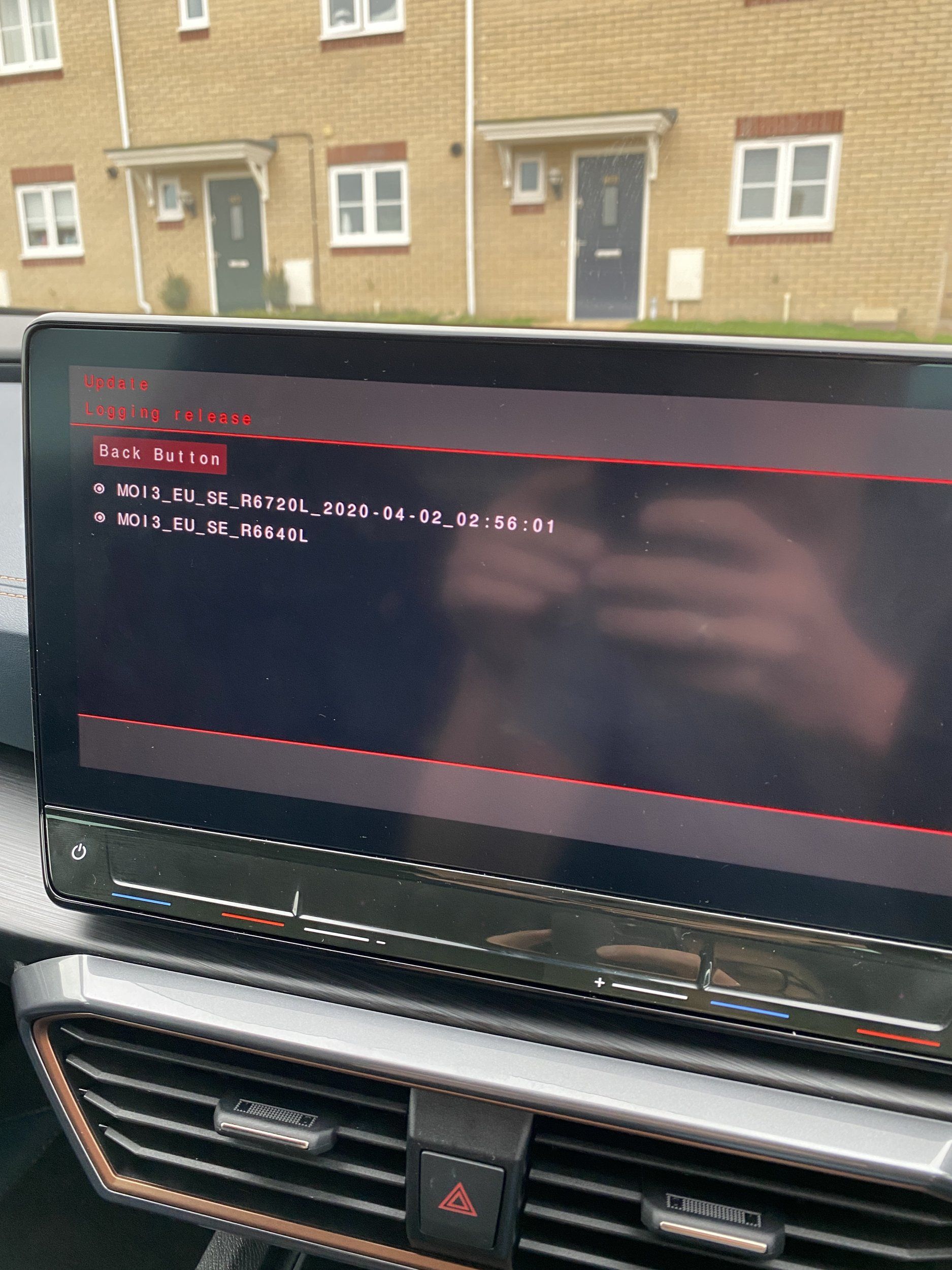

I'm a proud new owner of vz2 310 and a brand new member of this forum :)
I've picked my Formentor on Monday evening and noticed that whenever I'm using apple car play with yt music and reversing, the camera shows a black picture - do you also have that in yours or is it my software version?
When hooking up to Cupra connect this morning, I've somehow entered the service and maintenance menu and below are my software versions. Any help is appreciated before I'll come back to the dealer :)

To me that looks like an old version of the software .
But someone's with better knowledge will confirm

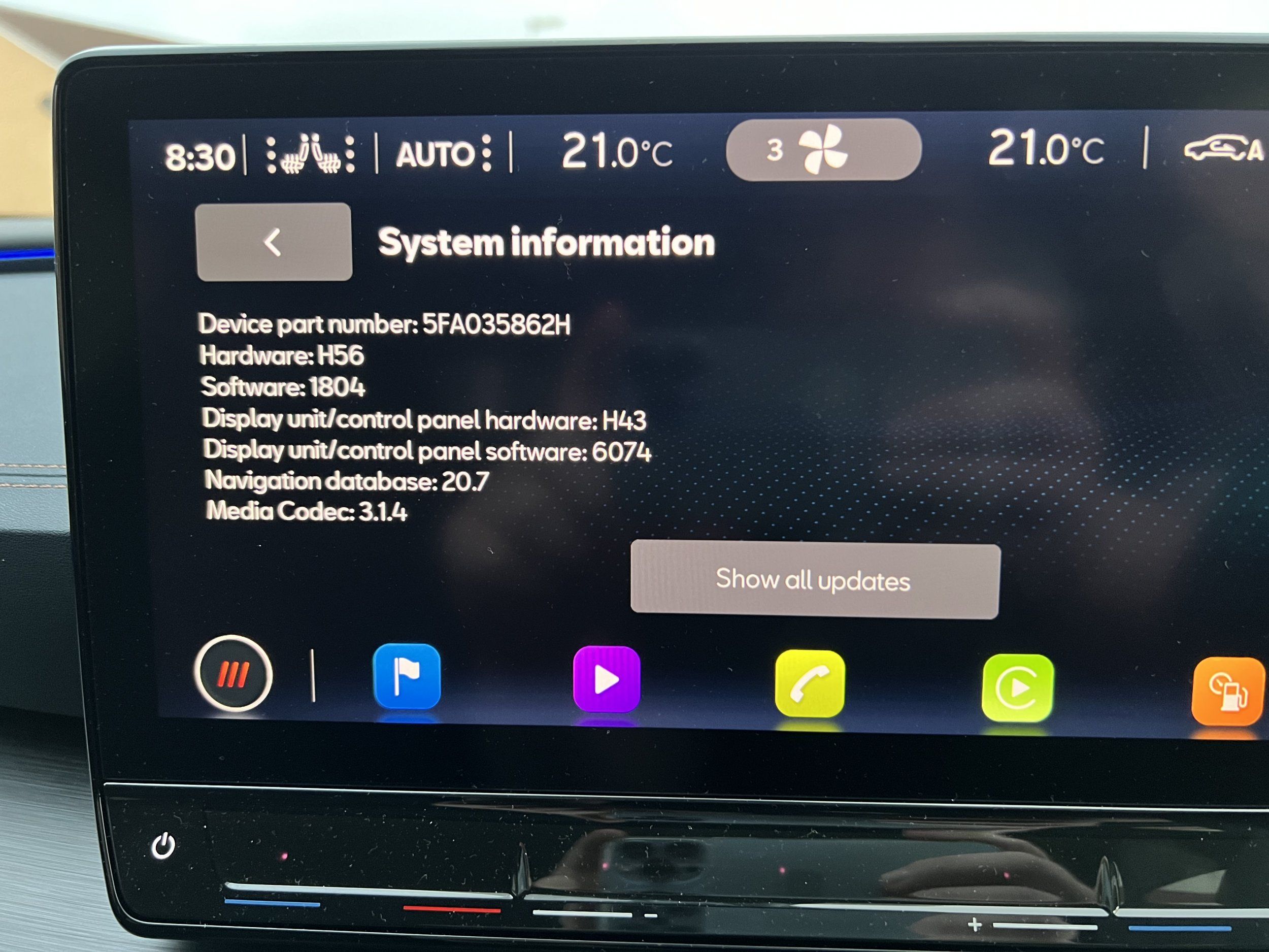

I picked mine up last Thursday and I have Software Version 1802 (I think. Definitely 18**)
Picked mine up on 1st December and all works as it should with Apple CarPlay when put it in reverse.
I have version 1804 on mine.
Reactions: Barykada
I have 1804 on mine, not had any issues so far. Touch wood!!
Yeah 1804 here too! Just checked.

Currently no update for this Infotainment unit. 1672 is the latest 16xx. Eventually they'll release an update to take it to 18xx or maybe even 19xx if it's been released by then.
There's a TPI for the reversing camera, however it should have been carried out before you collected the car as it's been out for nearly a year
