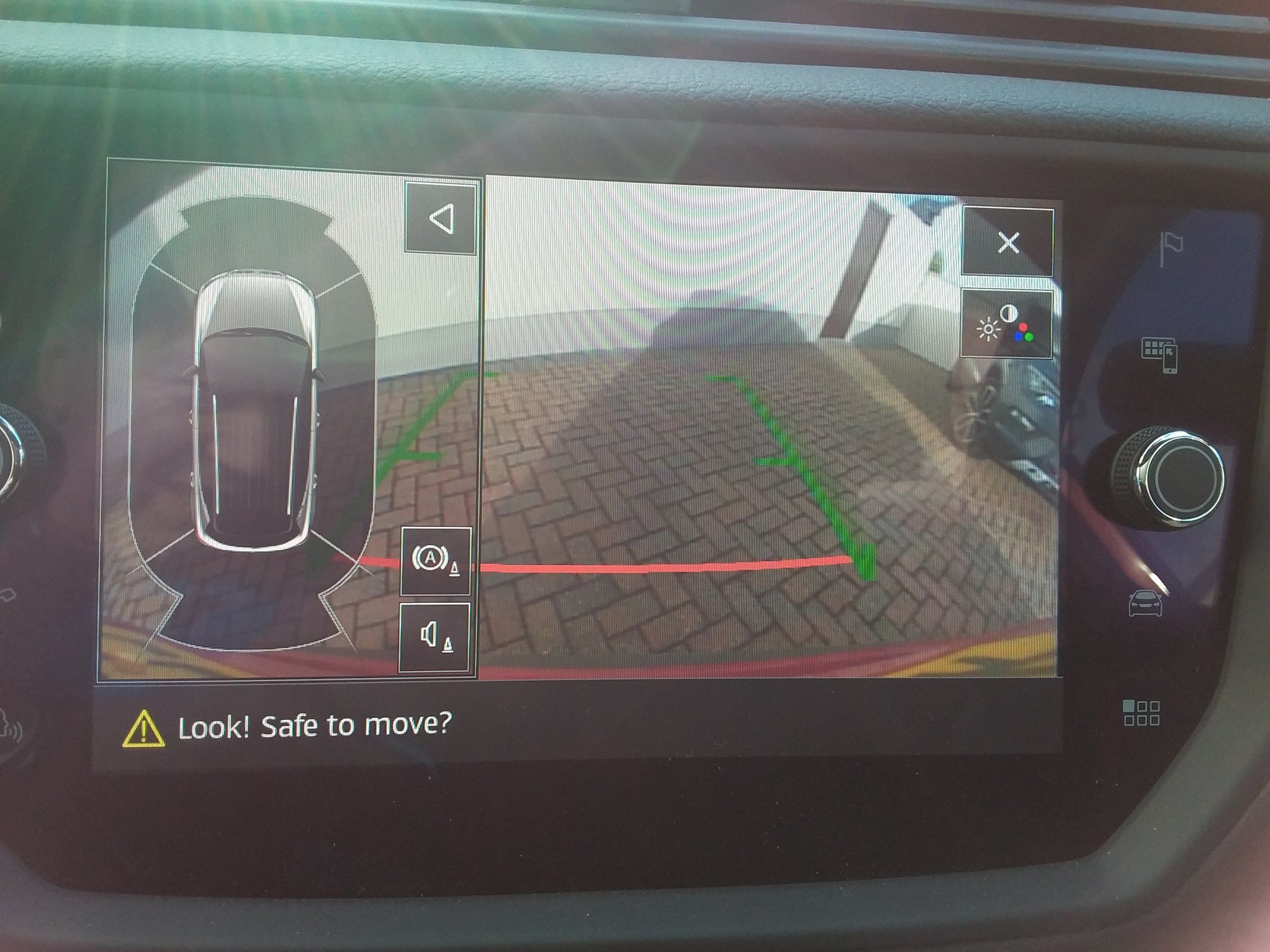

What the 2019 Arona Xcellence Lux looks like. Line doesn't bend with wheel. (the car image on the left is the full ultrasound view which the Arona Xcellence Lux also supports)
Maybe they successfully coded it this time. I'm not an expert in how the camera works but it feels to be like the guide lines are generated within the infotainment system.... rose to the occasion the key word is this:

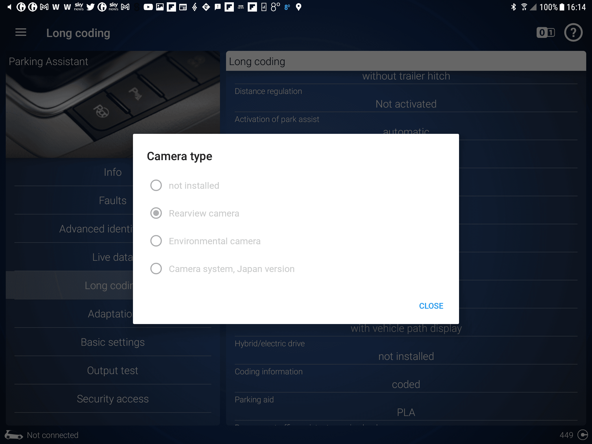

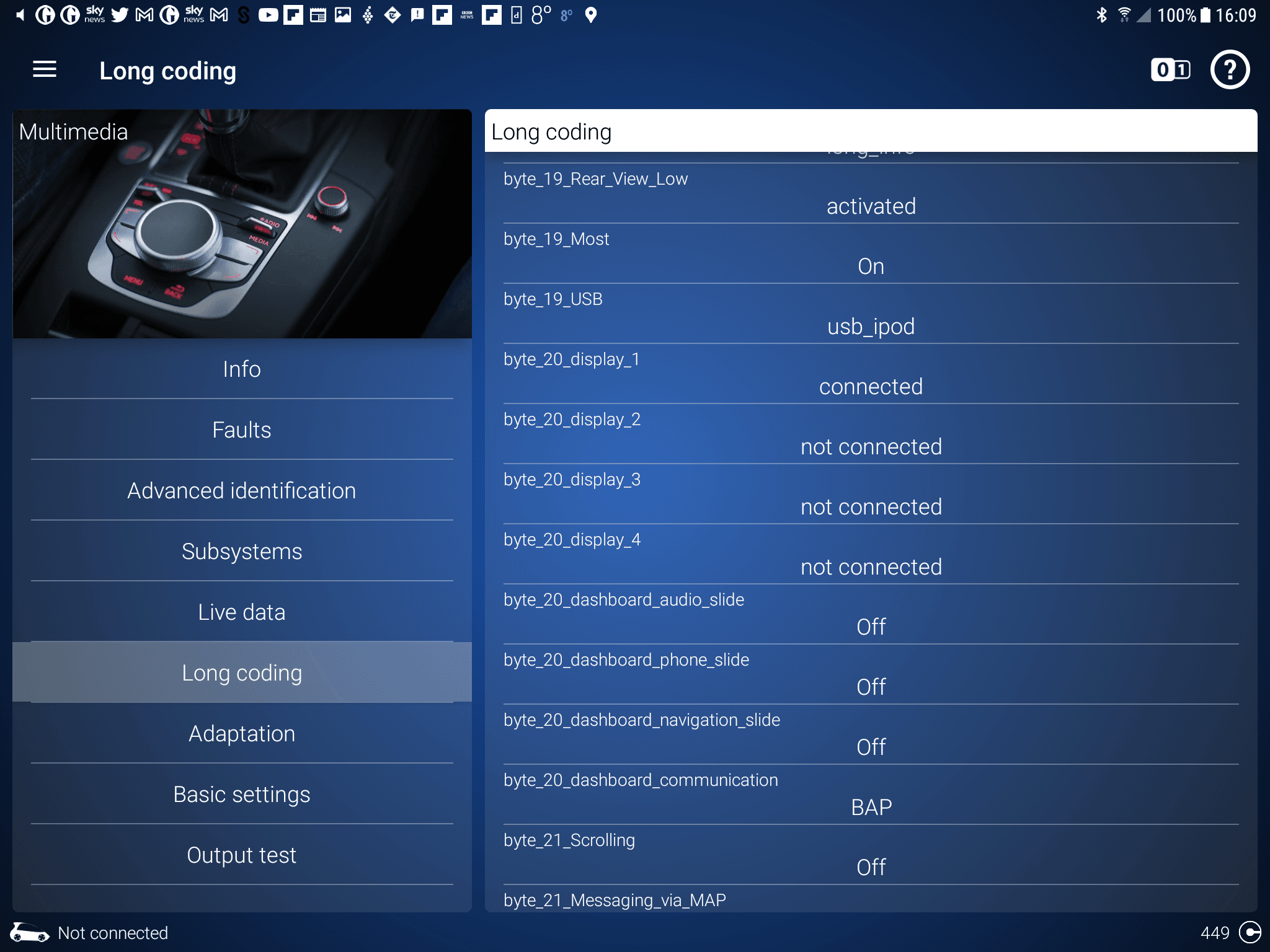

I followed Mr Fixit's coding on the camera which he'd installed using a dash camera in the rear...
Cross checking his settings with the factory fitted one tally.
So nothing special with the coding... so it means it's done in the camera or in a camera unit. With the Google's got that. As you say miss wired or left out the black box.
View attachment 28697View attachment 28698

You will need the coding as in post 8 since they won't have left the car prepped with that I'm sure. I don't believe the Arona does the bendy guidelines just the fixed as per the picture. Whether dynamic means bendy or fixed ?. My Ateca they bend with the steering wheel position to give you a view of where it's heading (dynamic trajectory), it does have top view, that might be a part of that or more enhanced systems. I'd probably find that in the coding by digging into the other systems and Googling. The 2019 Arona Xcellence Lux factory fitted camera as per the picture (fixed lines), don't bend but are still useful.
We'll await @lustucry to say how easy it is to fit and the coding they did. Reckon it's post 8... but I could be wrong. Dynamic lines will be more coding and whether the Arona is up to that not sure. You do find people having issues fitting the more fancy cameras doing to Google.
