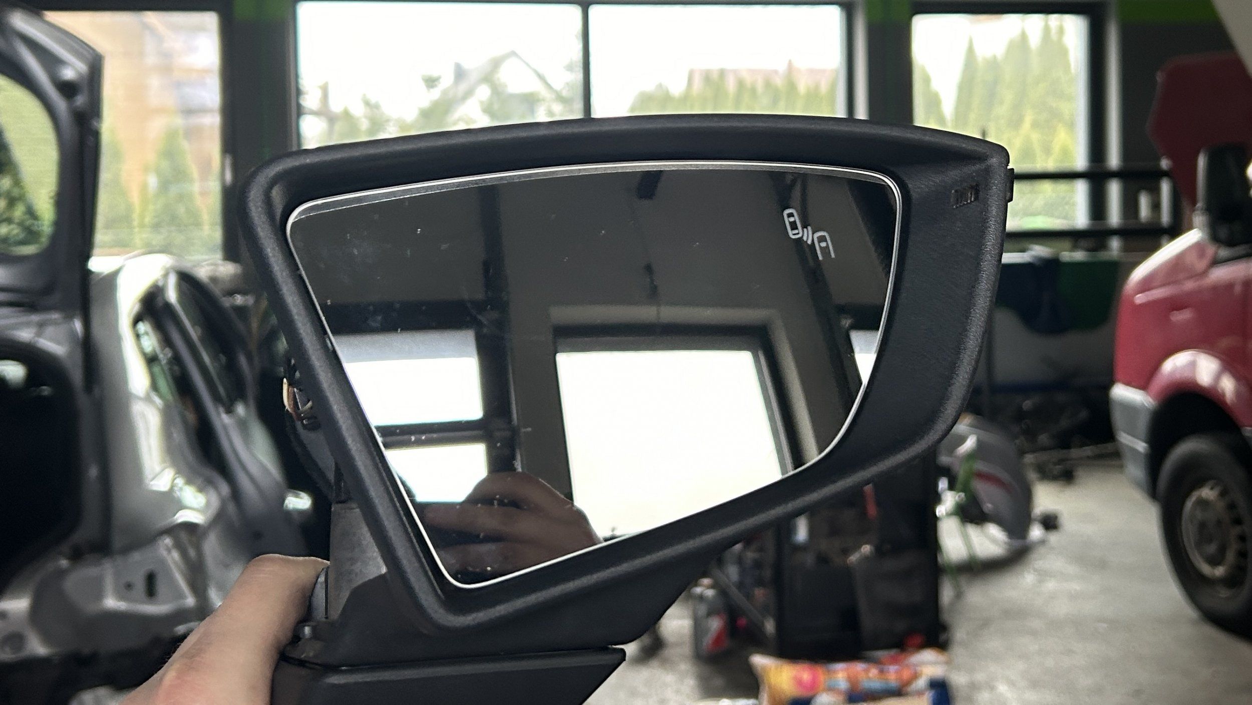

Hello.
Im Just wondering, does Seat Ateca exterior (door) mirrors fits Seat Leon MK3 Face lift model?
Just thinking about future retrofits to my Leon, Ateca's mirrors have memory function, blind spot assistant, and camera in mirror base.
Just want to know does Ateca's mirror base fits Leon's door, and does it look ok with it?
Also, cant find information does Seat Ateca (or Leon) have anti dazzle exerior mirrors at all?
Thanks in advance.

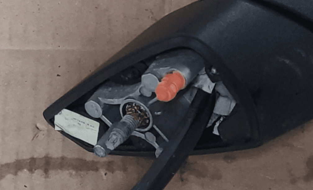

Hi, unfortunately they does not fit to Leon 5F because of different mount mechanism. Also Ateca mirrors are much bigger than in Leon so it might look silly.
Leon​
If you are interested in retrofitting Blind Spot Detection assistant then you can use mirror inserts from Arona: 6F0857522 and 6F0857521. On polish forum about Leons I am documenting my adventures with retrofitting this assistant (probably you might want to use Google Translate): https://leonclub.pl/forum/viewtopic.php?f=90&t=69822

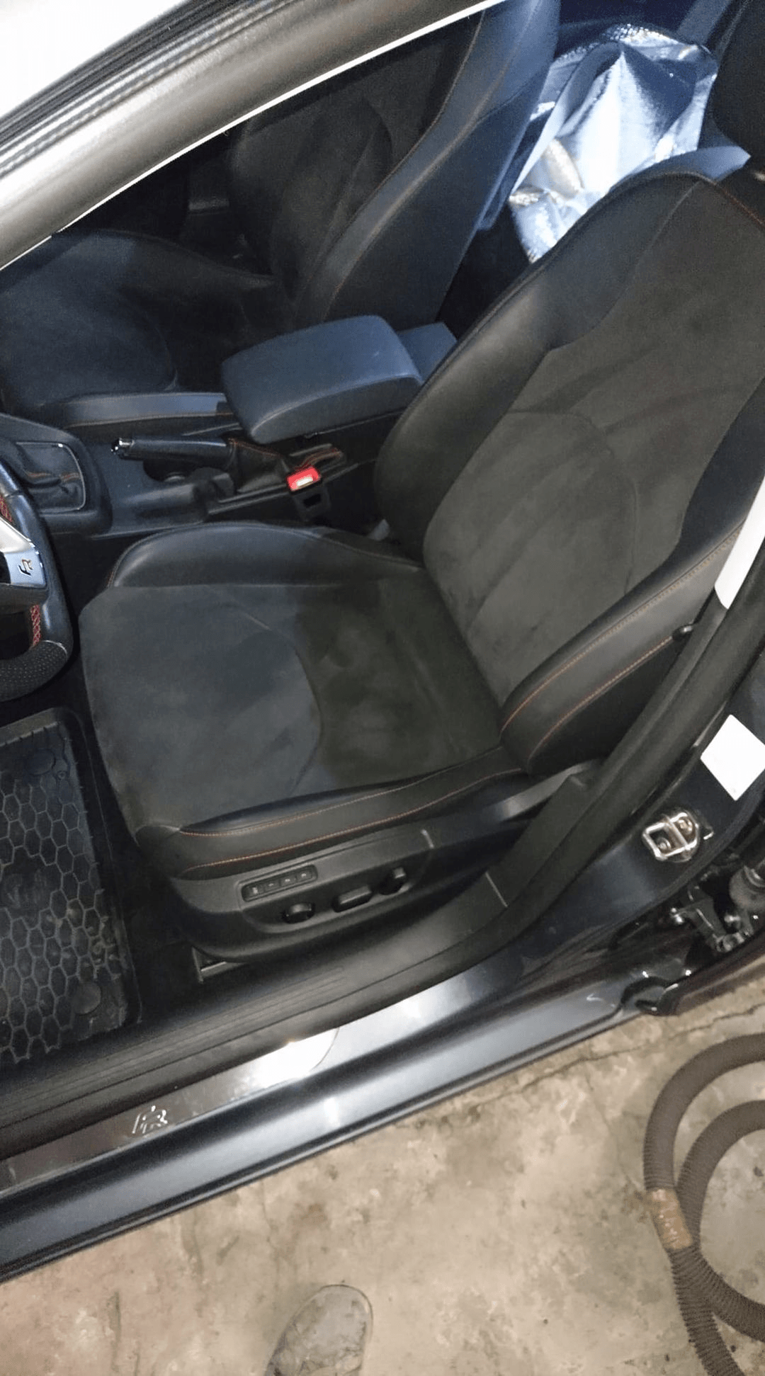

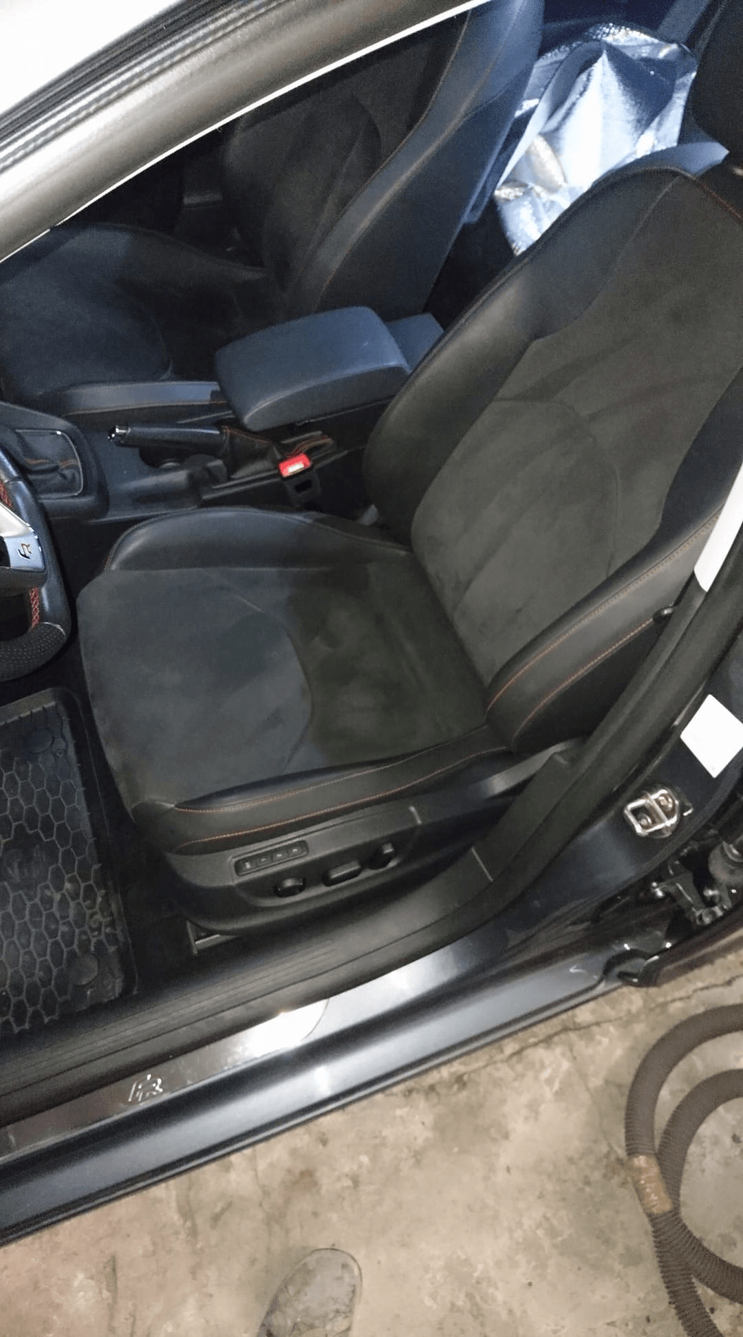

Fun fact about Leon 5F: it does have position memory, but only in the passenger mirror - it is used to dip it down with reverse gear. So if you are going to retrofit something (e.g. from Octavia) you only have to do it for driver mirror. Here are some (translated) info from guy how did this after retrofitting seats memory:
After successfully adding the driver's seat memory, I moved on to the mirror memory. A pleasant surprise was that the right mirror already had memory. I bought an Octavia 3 15-pin mirror for a harness and a mirror control motor. Unfortunately, the Skoda harness has different plugs and had to be cut and soldered, and a piece of the harness responsible for memory had to be added.
He also stated that the "joystick" for adjusting driver mirror works in reverse after this mod (up is down and so on), but memory works as expected. If cables were connected otherwise then memory would work in reverse ;)
Here is his front seat with memory buttons:
Beautiful seats! :love:

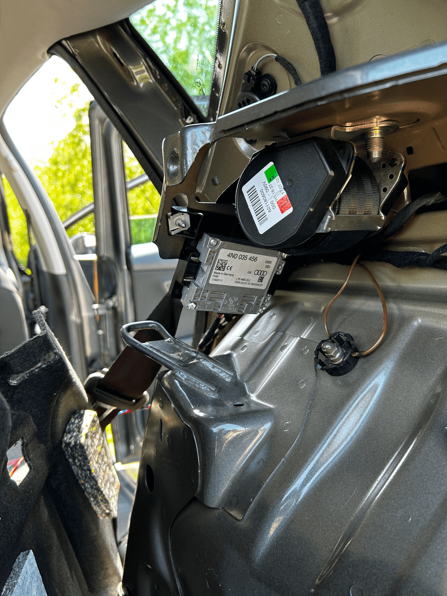

Yes, I am still in progress, but hopefully I am going to connect everything this or next weekend. Fingers crossed everything will "just work" ?
About that amplifier... yeah, I know the pain ;) Also you might be interested in 360 OPS (PLA 3.0) with Park Assist (additional 2 wires to the back of the car) and TPMS (additional 5 wires if I recall correctly). I might be wrong but with my knowledge that's everything that you are able to retrofit on the back of the car, assuming that you already have rear camera.
Here's how that amplifier should be mounted in the hatchback. I was not able to find any photo on the Internet so with some trial and errors after 30 minutes I have found its placement ;)
