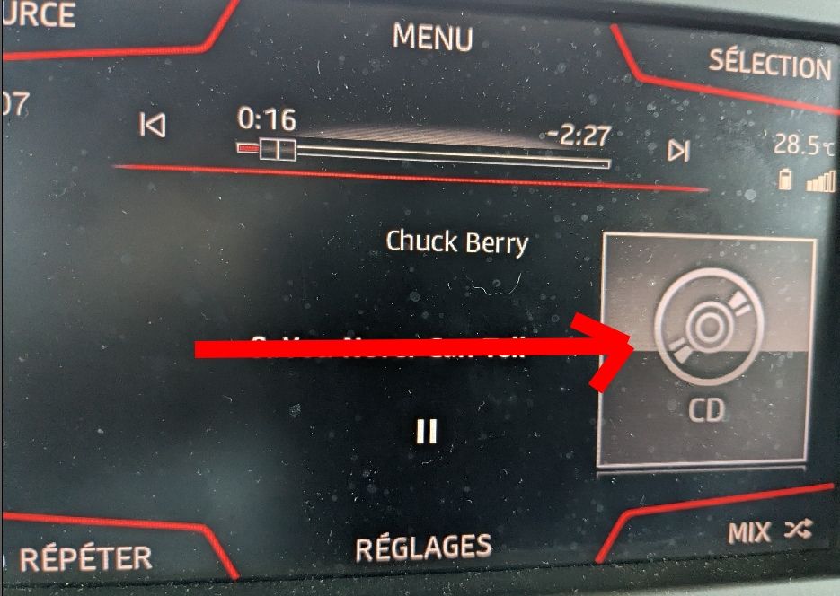

Hello everyone
I have made an audio disc with "tags", the artist is displayed
the title too, but no image of the cover, is that normal?
the mib2 can't display the image?
thank you

There are tricks to get it.
It uses the fairly standard media player process. If you have your music filed by folder then you can add a jpeg with the dimensions of no greater than 500x500 and call it cover.jpg. That way it shows the cover for the album. You use Google image search to find the album cover. You can downsize to 500x500. You can also use clip software to grab the image and resize.
This technique is useful if you haven't got embedded art in the music file, flac or mp3 etc. With embedded art it needs to be in the 500x500 size if not it can cause strange things to happen like the unit rebooting. That was last week's problem for me. I covered it on this thread:
This was a rogue embedded cover but using mp3tag I deleted the embedded one and used the external cover.jpg one. People with large mp3 collections using mib2 standard units use those tagging programs to adjust the covers. I have my collection in flac and use the external directory cover method, but as said a rogue Flac file had an embedded one that blew the system up to crash it. Took a time to identify the issue. A few days of testing permutations but always the same new tracks put on the SD card . Examination in mp3tag showed the embedded one on the file was pretty large, 1,500 × 1,500. I found a VW thread of people moaning about strange behaviour on their mib2 standard units, same as these but different firmware. Keep with in the cover jpeg limit and the limits to numbers of tracks and albums and you are fine.

I'd just bring it down to one mp3 to play with on the SD card. The cover art in a folder with it no more than 500x500, as cover.jpg. See whether you see that. Inspect any embedded art with mp3tag. Embedded art does work but needs again to be not too big.

You should note that all mib2 units aren't the same. Mib2 standard and mib2 night. Then they can run on different releases. Embedded art is the issue if it exceeds those bounds but ofcourse there could be a bug with any specific firmware release that has been resolved but unknown to us. So you get a bug but can only be resolved via the firmware update.
Keeping the graphic limit at or below 500x500 in the embedded files or a cover.jpg file is a requirement but you can go above that some times. Suck and see or just keep them at that magic number.

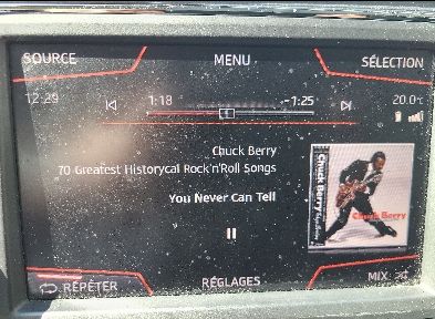

Bonjour
enfin résolu !
après avoir lu vos liens, désolé, ce n'est pas ma langue)
et après plusieurs essais toujours le même problème !
pas d'affichage d'image.
J'étais sur le point d'abandonner, mais ensuite je me suis dit : et si j'essayais de copier/coller ?
tout sur le CD, le mettre sur une SD ?
après test, OK !!!!
problème enfin résolu, merci à tous
