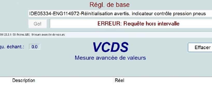

contact launched VCDS
-select
-03 ABS brakes
-04 Basic settings
in the drop-down menu: Reset tyre pressure indicator warning .....
answer error below !

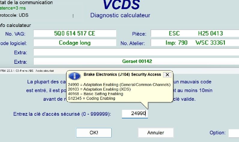

yes, I tried 20103 and 24990, same thing, same error.
maybe it's what I did before that's no good?

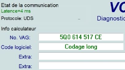

1)selection
2)03 (abs)
3)16 (security code)...???
seriously, you do a basic setting and then use access codes for something else?
I'm not “familiar” with vcds, I had a peugeot and often used diagbox, vcds is new to me.
well, you seem to have understood my mistake?
I'm listening?
Please don't misunderstand me, if you don't know anything about it, you should stay away from control units like the ABS... You just need to read what it says. Why don't you set the security code for basic settings if you want to carry out a basic setting?
