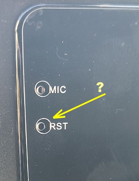

but when I look at it more closely, something catches my eye...
when i look at the androidauto, i see two ‘holes
one that says ‘MIC’, I think it's the internal microphone for the phone? ....car I've installed an external microphone (more sensitive), but if it's a button, why write ‘MIC’? the other underneath seems more interesting, if it's a button, and if it's the reset that's causing me problems? I'm afraid to try, because if it erases all my configuration, I'd be in trouble!
it says, ‘RST’ ...for...reset I suppose, but what????

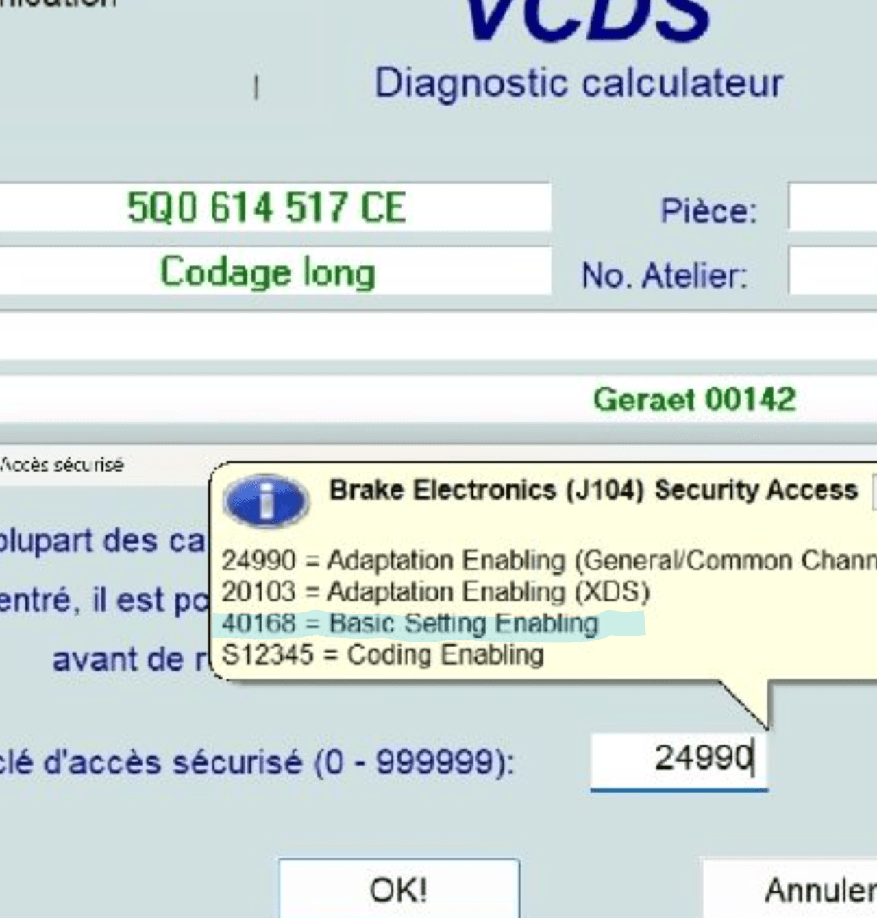

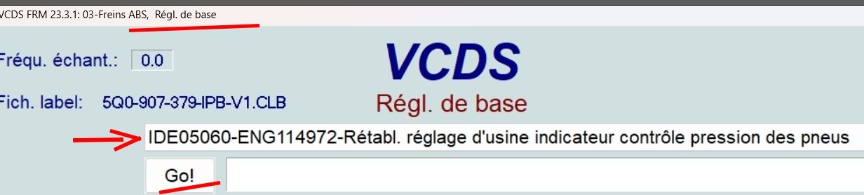

problem solved!
I hadn't understood your comment (post 12), in fact it was me
who didn't write in the post, in the right order, which is what I did!
I've just done the same thing again in the same order, but this time with the code ‘40168’ and it's accepted! fault cleared

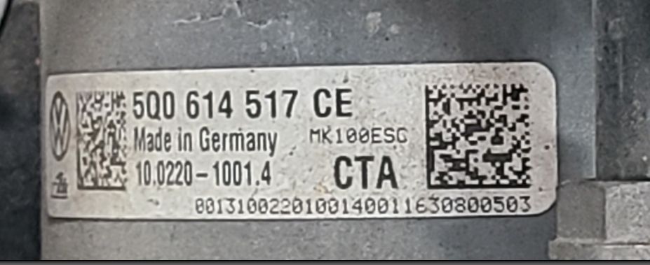

but I have just looked at my ABS block it seems well disposed of a connector 45 pins so compatible with the possible wiring of a rest button?
I had the same problem last week, change of 4 tires from a different brand (continental contact6)
after 10km display tire pressure error!
I erased the defect with vcds , but it is not very practical to "take out" the pc and the necessary tools for each tire pressure problem!
question: below my ABS block , compatible ? thank you

I retrofitted it myself. But that's the PQ platform... the ABS control units of the pure mqb platform no longer have an input for it; it only happens virtually.
