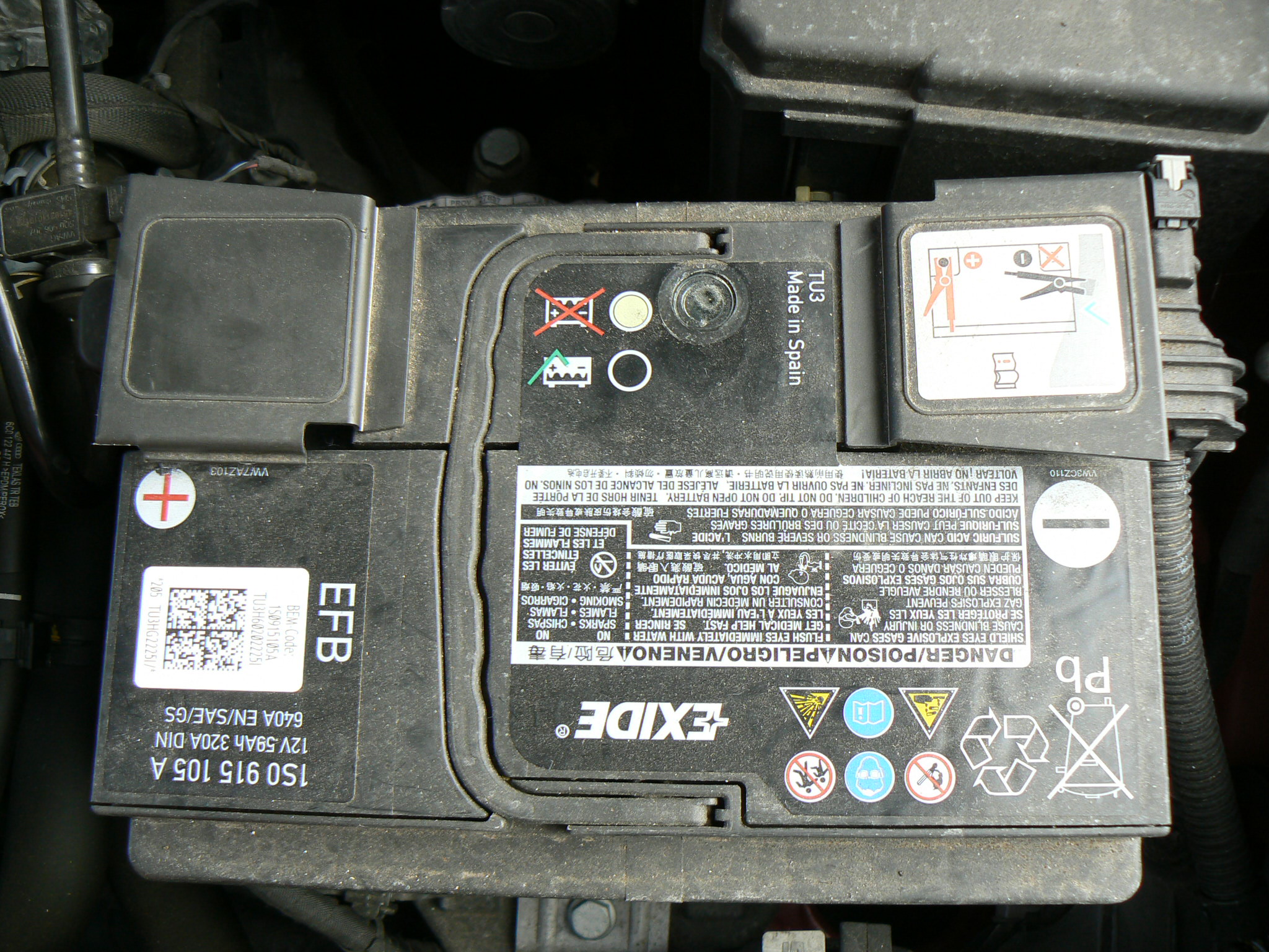

I'm going to try to post a picture when I'm finished, so let's assume that works? then the first thing to say is you can see that my battery charger is a "smart" charger which is suitable for connecting to batteries which are still in circuit with the car (says so in it's brochure/instructions.) I seem to remember in the previous post that a recommendation was made to connect the negative charger lead to that domed nut you can see just above the negative crock clip and I've come across a pdf for the Ateca which actually tells you to connect the negative charger lead here (positive clip to pos battery terminal).
The big question is though, has anyone tried doing this. I'm an "old school" mechanic so modern electronics are all a bit "smoke and mirrors" to me and, despite having read the Ateca manual I don't feel all that confident. - of course my car is not an Ateca, it's an Ibiza, but the setup looks visually the same. I noticed that my Ibiza manual says to connect the negative lead here if jump starting as does the Ateca, so I think they are the same. By the way, for those not "in the know", (and assuming I manage to post the picture!) if you look at the right battery terminal - which is the earth - can you see a black plastic thingy which is part of the cable terminal ? it's got a wee connector coming out of it's top. That's the sensor. Worth knowing too that if you try a jump start by connecting to both battery terminals (as you could, but would be best not too, on the old cars) you'll almost certainly be shelling out for a new one! The general info on jump starts now - if you dare? - is to go pos to pos on the two batteries but then chassis to chassis with the negative lead (I go engine block to engine block - when I'm feeling brave enough to try it, which isn't often) I believe this ensures that the sensor is not subject to a reverse current.
So, after all that, will I be Ok to connect my charger's pos crock to the battery pos and charger neg crock to that big domed earth nut on the inner wing - you can see it in the picture just above the charger's neg crock connector. Thanks in advance for any help.

In short, yes, that is what I do when topping up my wife's 2015 VW Polo, also on my Audi S4 which tends to spend most of its time asleep in the garage, I'm effectively doing the same thing, I'm saying that as with car that have the battery in the boot, jumping postings are supplied under the bonnet and the +VE is a heavy lead taken from the battery +VE and the -VE is screwed to a stud on the chassis.

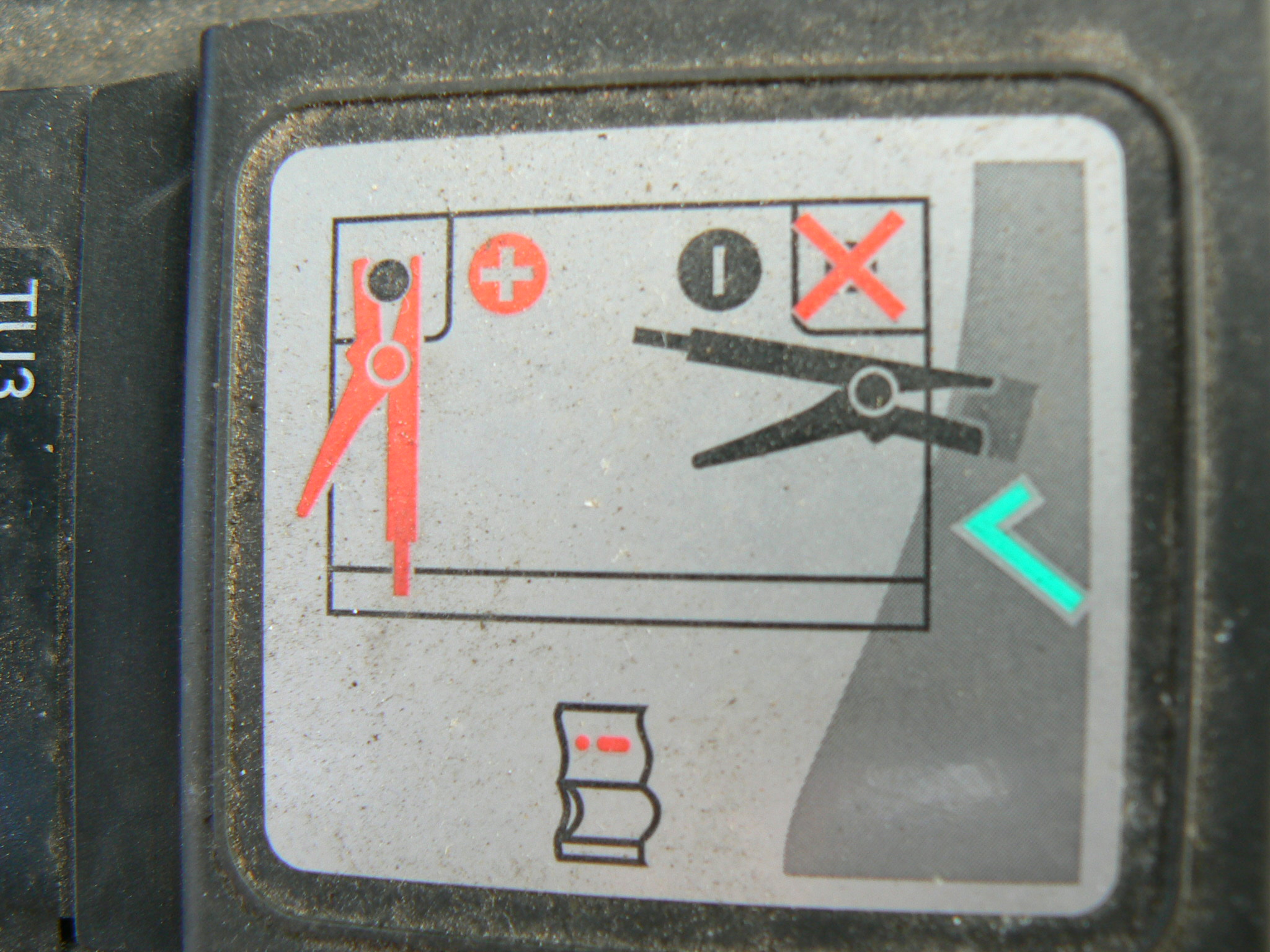

I think, only think, that the windows re no longer an issue on these cars, nor the radio, you will lose saved fuel computer data for the present tank full and the final thing is the electric steering will lose its acquired data and so I believe that the dash might light up like a Christmas tree - well slightly, until you have driven a short distance and the electric steering system has relearned things.
One thing on the issue of where to connect any -VE side of charging or jump leads, is the -VE battery post should have a "don't connect to this point!" notice on the cover for the -VE battery post, and the +VW post should also have a plain cover with nothing on it other than a + my wife's 2015 VW Polo 1.2TSI had no covers on the battery posts - which in my mind is not on, so I bought suitable ones,, these cars should come with these posts covered, the +VE one because it is not at metal work potential and the -VE to bring to everyone's attention that no charging or jumping leads should be connected to that battery post.

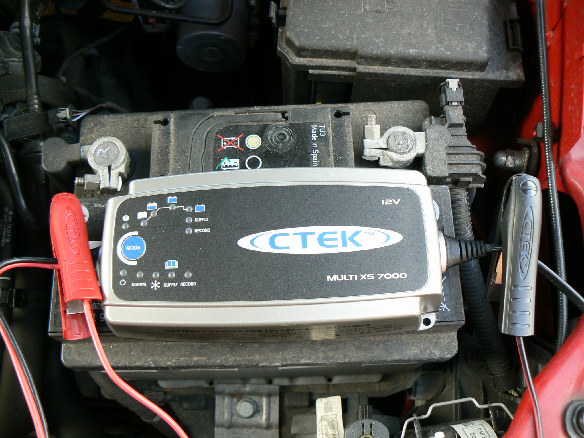

I'll attach a picture, maybe 2 if I can figure out how to do more than one, at the end of this post showing the guards installed on my battery. I removed them to show the negative terminal sensor in my previous post. The illustration is very clear to me that you must not connect to the battery negative terminal and it shows the connection is to be made to the domed earthing nut. However it shows a, very recognizable, jump lead type clamp - don't you think? So it left me feeling very uncertain if it applies to the likes of a charger. Reading the owners manual, if you look in the index at the back - Page 236, - it actually lists "charging the battery" and tells you to look at page 52 where it gives very detailed, and welcome, instructions as to how to connect for a jump start (different depending on whether you have stop/start or not) but not a word (either here or elsewhere in the manual) about charging. You could make an educated guess that connecting the negative charger lead to the domed nut and positive to battery positive is probably the way to go (and that's actually what I saw in the Ateca manual PDF I found on the internet) but I'd feel more confident to see it in print in the Ibiza's manual.
It'll be very interesting to see what the reply from SEAT's tech people is. will they give a detailed recommendation or will they "fudge it" like our politicians, when asked an "awkward" question and push me to the dealer? Bets anyone?

Thankd again RUM. This is very much what the advice was in the pdf I saw of the Ateca manual - For stop/start, charger pos to battery pos and charger neg to domed nut body earthing point. Didn't see a non stop/start recommendation, but they probably don't make a non stop/start version? So I think this is how I'll be trying it but I want to have a chat with AVW first. I've had another really thorough search of my Ibiza manual and there's definitely no advice on battery charging, only jumping.
The jump starting instruction I find interesting. For vehicles without stop/start connect pos to pos both batteries then neg on "good" battery to chassis/engine block. (pretty standard advice for jumping anything in my experience) However if it has stop/start and you are jumping from another stop/start vehicle then the positive leads are connected as normal (pos to pos) but the negative lead doesn't go anywhere near the battery on either vehicle, it gets connected chassis/engine block on one to chassis/engine block on the other - Connecting to the chassis/block on the "good" (donor) vehicle is new to me.
I've had another email from SEAT and they are sounding quite "nervous" saying they are unable to advise me further as they are not familiar with the charger I'm intending to use. I'm not really surprised by this, can't blame them really, but it would have been refreshing to have received a more "grown up" reply. Still awaiting CTEK to reply.
So, at this point in time, I am feeling moderately confident that connecting that neg lead from the charger to the domed nut will be the way to go.

Had a reply from CTEK. First off they apologized for not replying more quickly but they have been snowed under by an "enormous increase in mail requiring support due to these extraordinary circumstances" (the use of words is a little amusing so I think it's Sweden who are replying). I have a vision now of droves of immobile vehicles with flat batteries languishing at the side of streets all over the country. Golden opportunity here for the "wide boys" to sell lots of batteries to people who don't need them?
Regarding how to connect the charger, they first advise that connections should be made according to the vehicle manufacturer. That doesn't surprise me at all - it's called covering your back! They could have stopped there but impressed me by going on to say that when "no other recommendations are available connecting the red clamp to the battery positive pol (presume they mean pole) and negative connector to the chassis is not only for common safety reasons" (something slightly lost in translation there I feel?
But they didn't finish at that, going on to say, "Vehicles with BMS system (Battery Monitoring I'm guessing?) can be tricky to place connectors correctly but you will always be on the safe side when you connect to an earth point on the chassis".
I'm quite impressed with their reply, they could so easily have "hid" behind "connect as the vehicle manufacturer says". I'm now feeling that this advice, coupled with what I read regarding connecting to the Ateca, supports connecting that negative charger lead to the domed earth nut - as, I think, you've already recommended RUM? - on the inner wing. and I'm feeling quite confident now that I should do this.
