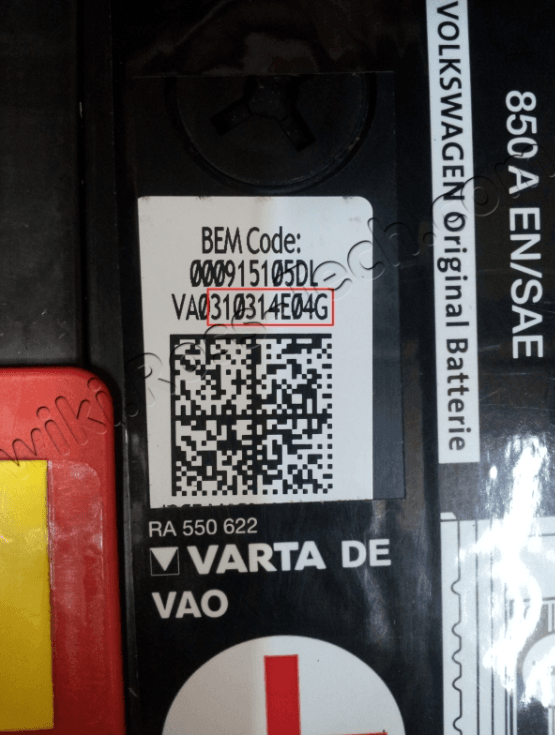

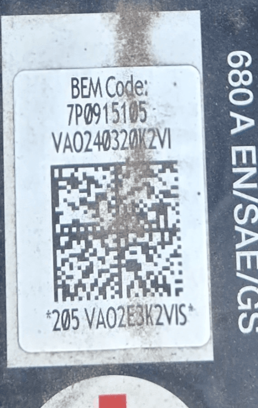

This is exactly what's puzzling me. I've been told, by more than one source, that without the info on the BEM code label it's not possible to correctly align the battery with the electronics on the vehicle.
It is, you just need to change the serial number to something else. Any 10 digit serial will be accepted. If the capacity is different, you can code it (see the link posted earlier).
Reactions: adam davies

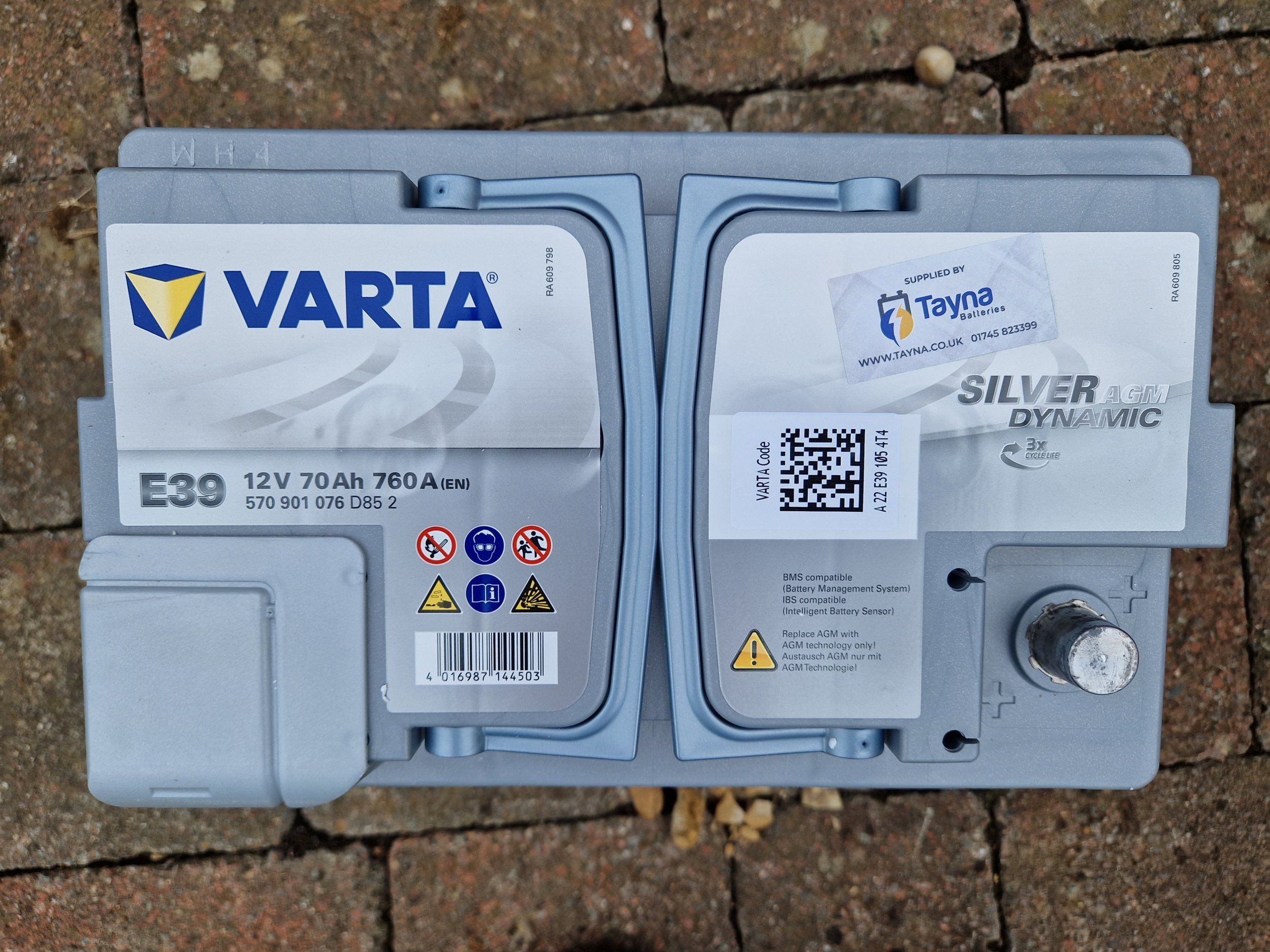

Yes, but, one battery is VW Group part and so has BEM labelling on it, the other is an aftermarket Varta battery with a product identifier QR label on, reading that label using a QR reader will not reveal much of interest/use when coding it to a car. That battery is what I’d call a “post BEM” product, from the time after VW Group and others had been told to stop that restrictive nonesense!
