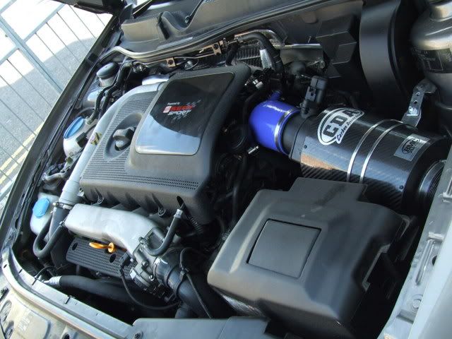

Sorry its been a while since ive fitted one i think you are correct the lcr dosent require a breather filter as the oil breather goes into the intake hose! The sp-02 will fit the car but its 60mm longer so the cold air feed is a b*atch to fit we have done a lot of development work with bmc in the uk,but the italian manufactorer are a little differcult to deal with,so there is confusion which one fits what all the info we gathered we posted on here!
Anyway here is pick of the sp-09 as fitted by us to a customers car a while back:
I have an lcr in tommorow so i will check that car just to make sure!
