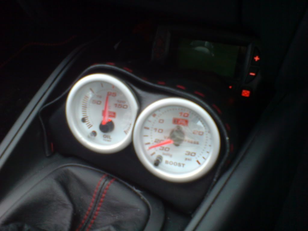

fitting a turbo timer is a PITA due to complications with the immobiliser. I have mounted my gauges in a pod infront of the gear-stick angled at the driver (i made the pod out of fibreglass and covered it in leatherette)

The one I made looks like this:
However your best bet for a pre-made pod is the A-pillar replacement from Nomad Racing ( a google search will bring up their website ) Most people on here use these pods

Out of interest whats the '+' and '-' above the pods for? Havent got that in my car. Home made pod looks good by the way.
