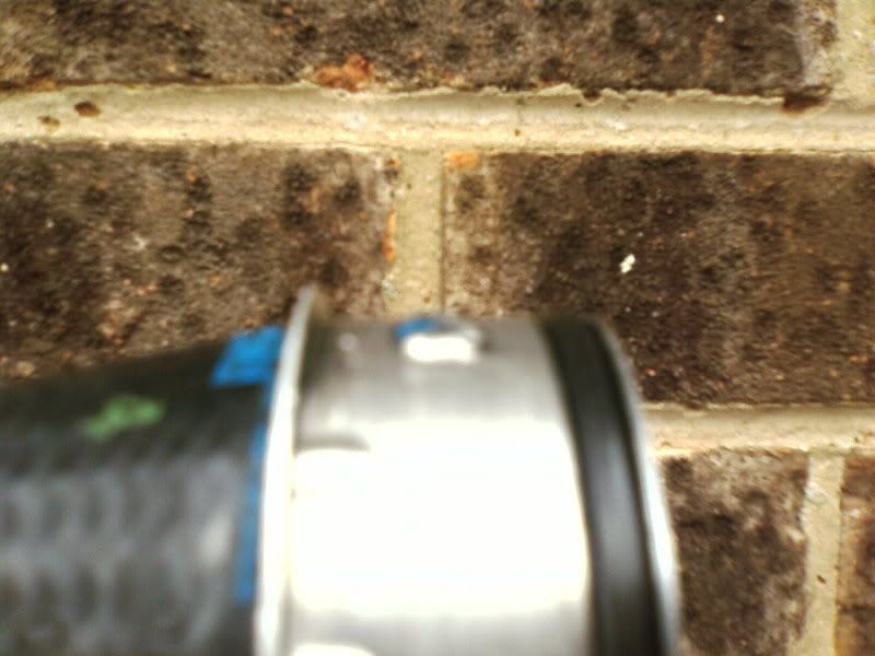

Looking at those photos, I suspect the two metal lugs on the pipe end have probably worn down, which means the horseshoe clip won't have anything to hold onto.
The lugs are quite weak and wear easily.
I suspect you need a new pipe. If you do, put a new clip on as well so you know it hasn't been weakened during previous removals.
Make sure the pipe is *fully* pushed home before putting the clip on, otherwise the clip will sit "on" the lugs rather than behind them (and this will wear them down).
And I'll echo what Nic said - there are 2 or 3 different sizes of clip, they all look pretty much the same but it's important to get the right one (IIRC when I was looking at ETKA a few years back for clips on mine, even ETKA had some of the clip numbers wrong!).

Yes its exactly as stated above, however its just the rear 'lug' thats shot, the front is fine.. which sucks...

Last week I had a problem with this :
The top boost pipe that joins the EGR valve had popped off slightly, I reattched it but it just came off again, so I took the pipe off with the idea of cleaning it up and then making sure it was all the way in and on correctly.. however...
What it looked like
What it should look like :
Bad times! As the lug had become clean cut... however I had a cunning plan, not that I needed to do it as I could jsut get a new one, or better still look at custom pipes which I intend to do now, however I was bored it was friday so I thought why not... bring on the modding...
Found this the garage and figured, ohh looks hard core :
So on it went...
Looks the part, and it works :) Well sort of.. the rear still came out abit, however due to this groovy mod it didnt come out fully, so still had all boost :) That was until I gave it some proper hammer to test if it could take T. Spark mode and as I went for a overtake I heard a very loud pop, and lots of black smoke...
The other lug has now clean come off.. so nothing is holding the pipe in anymore... bad times!
However this mod worked for the best part of 20 miles or so. Rock on!
Mine are always leacking or popping off and im running much less boost than this. Next time I get the car in the air im going to try and fabricate a clamping system for it!
It should come out slightly, well thats what all do. However mine came fully out haha! This sorted the problem for a few miles, but now the other lug has gone so meh, gunna get a new one!
