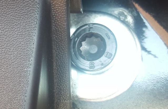

A mate told me the type of bolt this is, its xzn which im sure you all know :) But does anyone know what size this one is? I don't want to end up having to buy a 40pc set online for this job and maybe the odd future job.
The etching looks like 8.5 3? But im not sure and cannot seem to find a match on ebay/etc..
Also if you've had this issue before, am i going down the right track here with trying to fix the screw/gear? Or am I better off replacing the latch? Both in terms of ease of fixing VS replacing it and ... is this the issue? I'm obviously sure it must be a fault in this module, but is it actually the wormscrew or am I better off replacing the whole thing?

It needs the latch/lock replaced. Not an expensive part. 5 min job. Held on with two common M6 spline bolts.

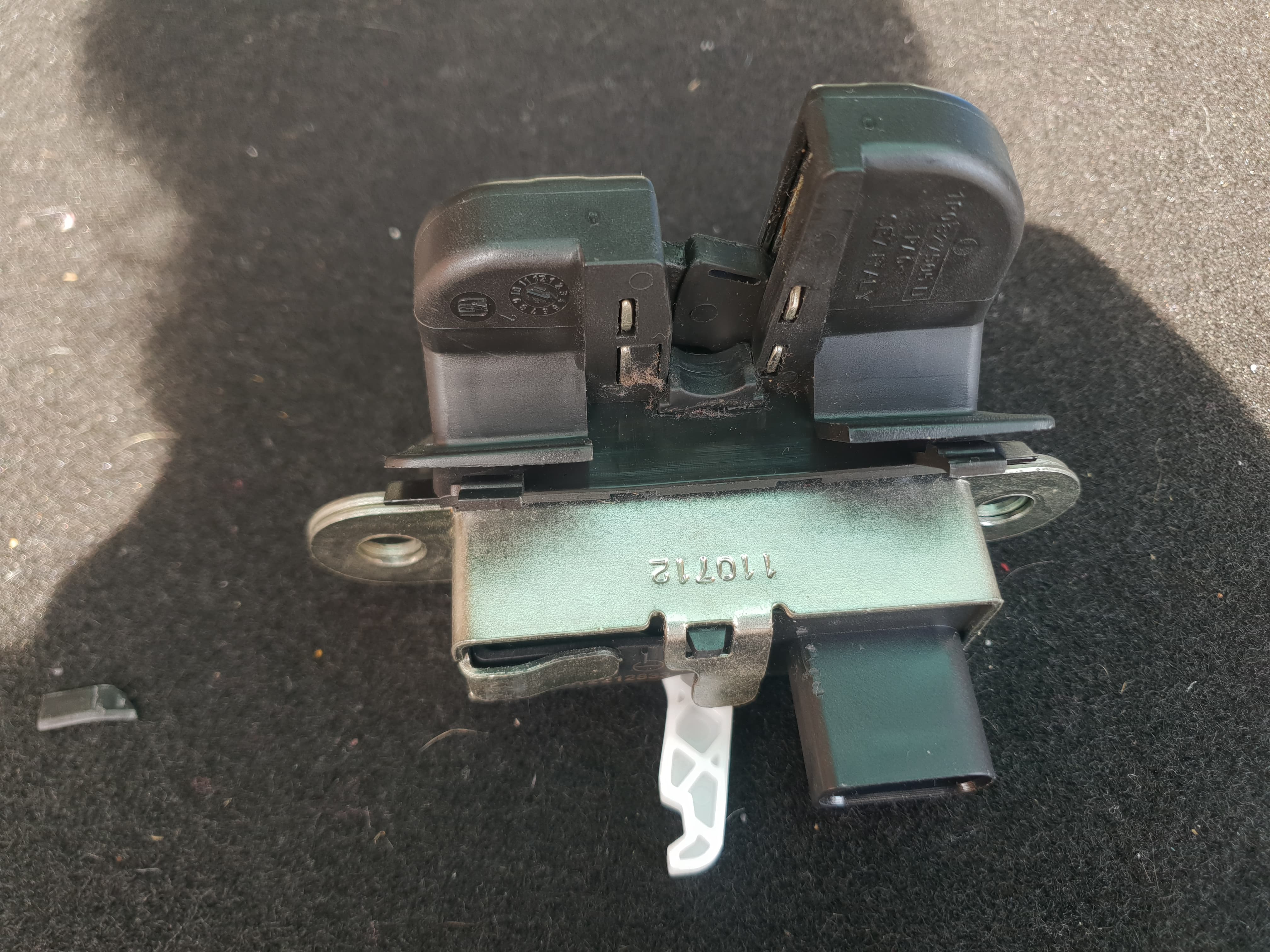

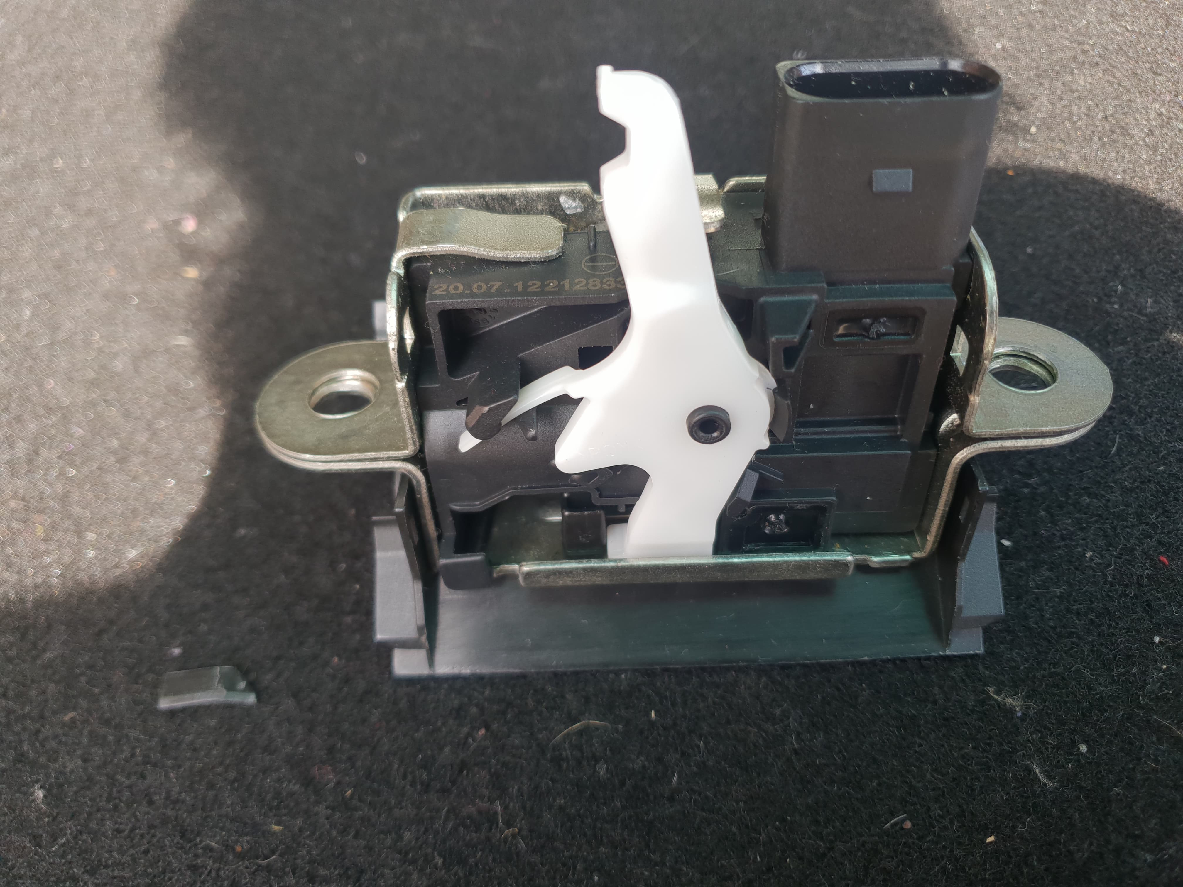

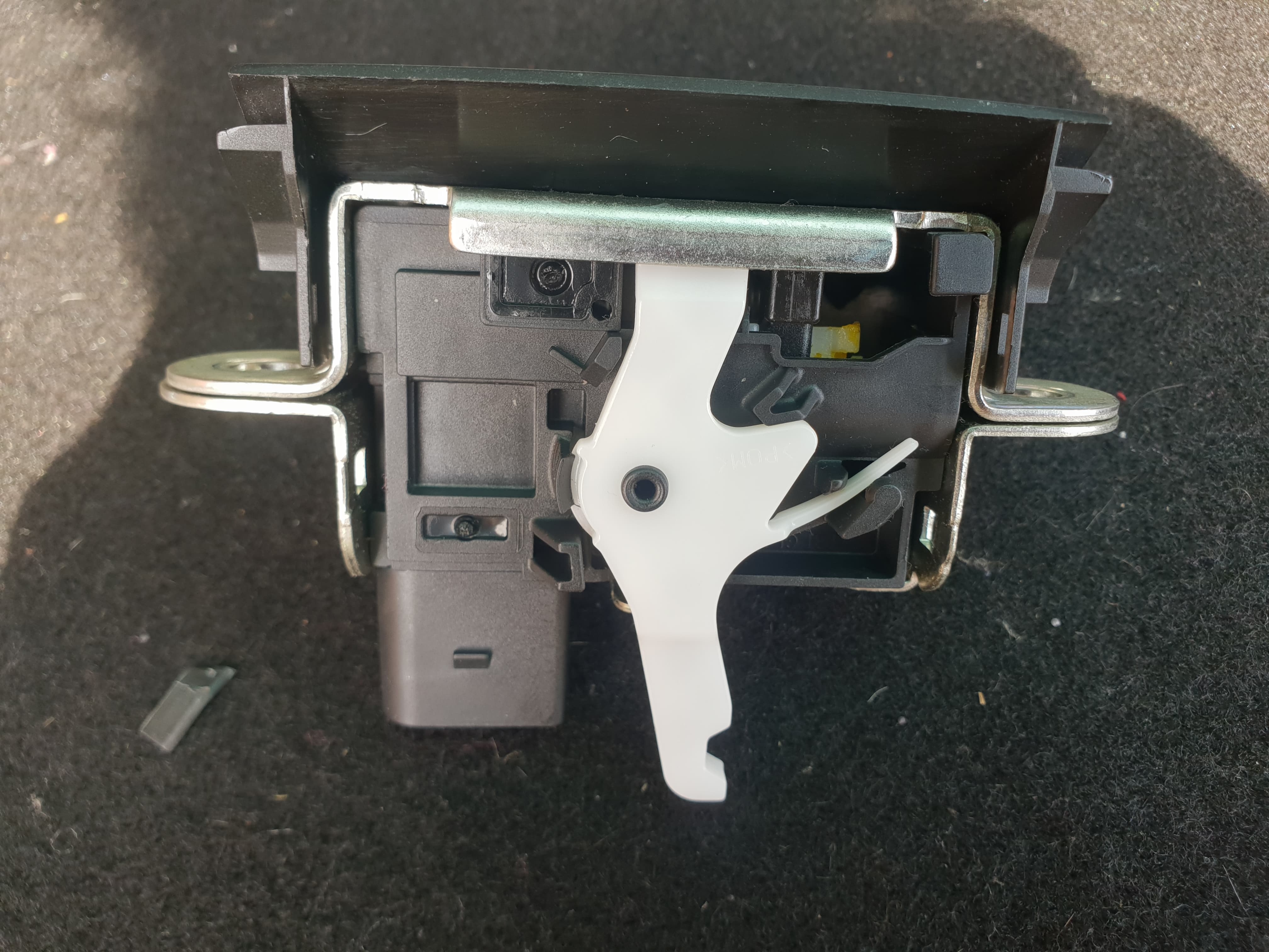

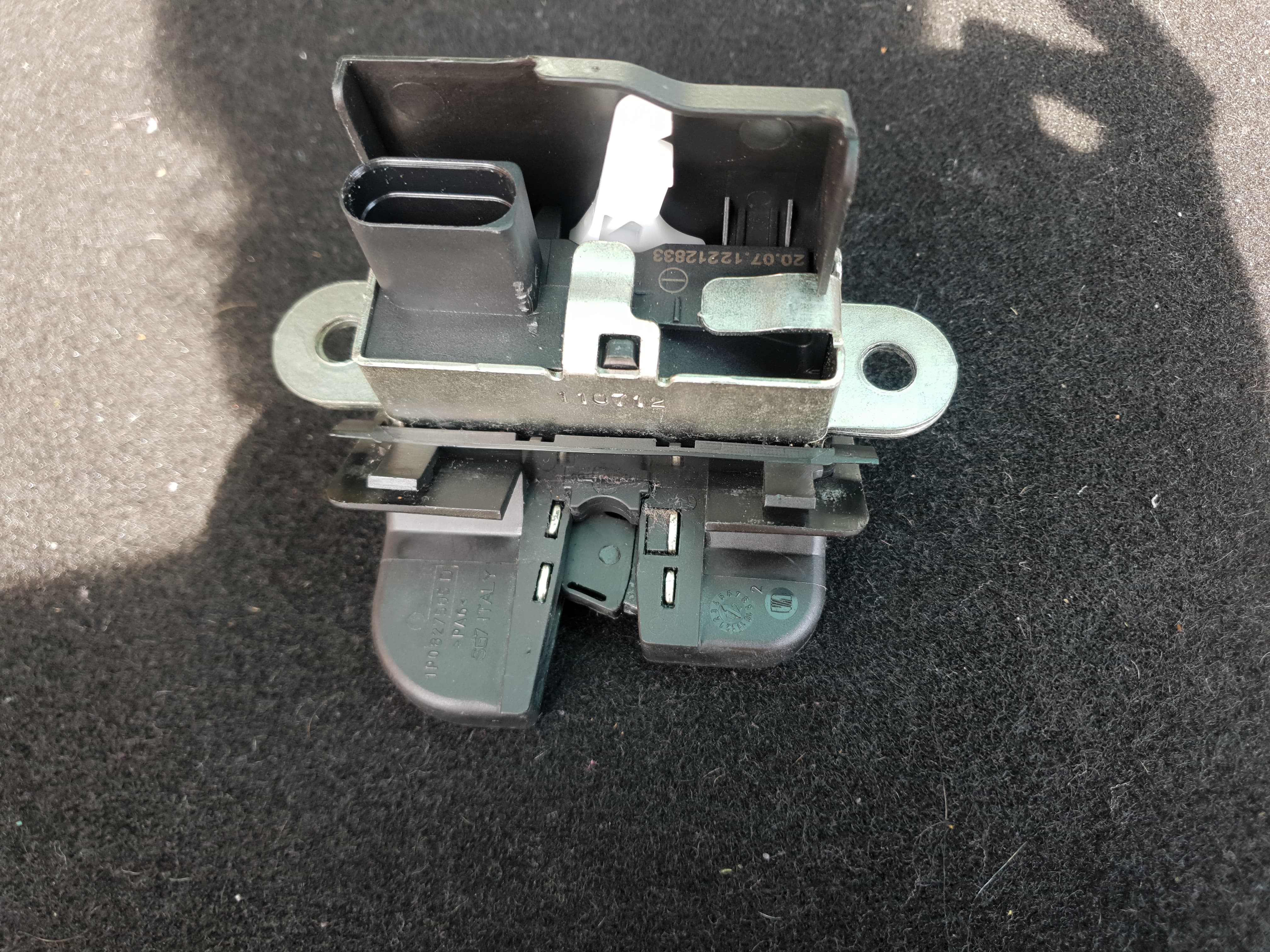

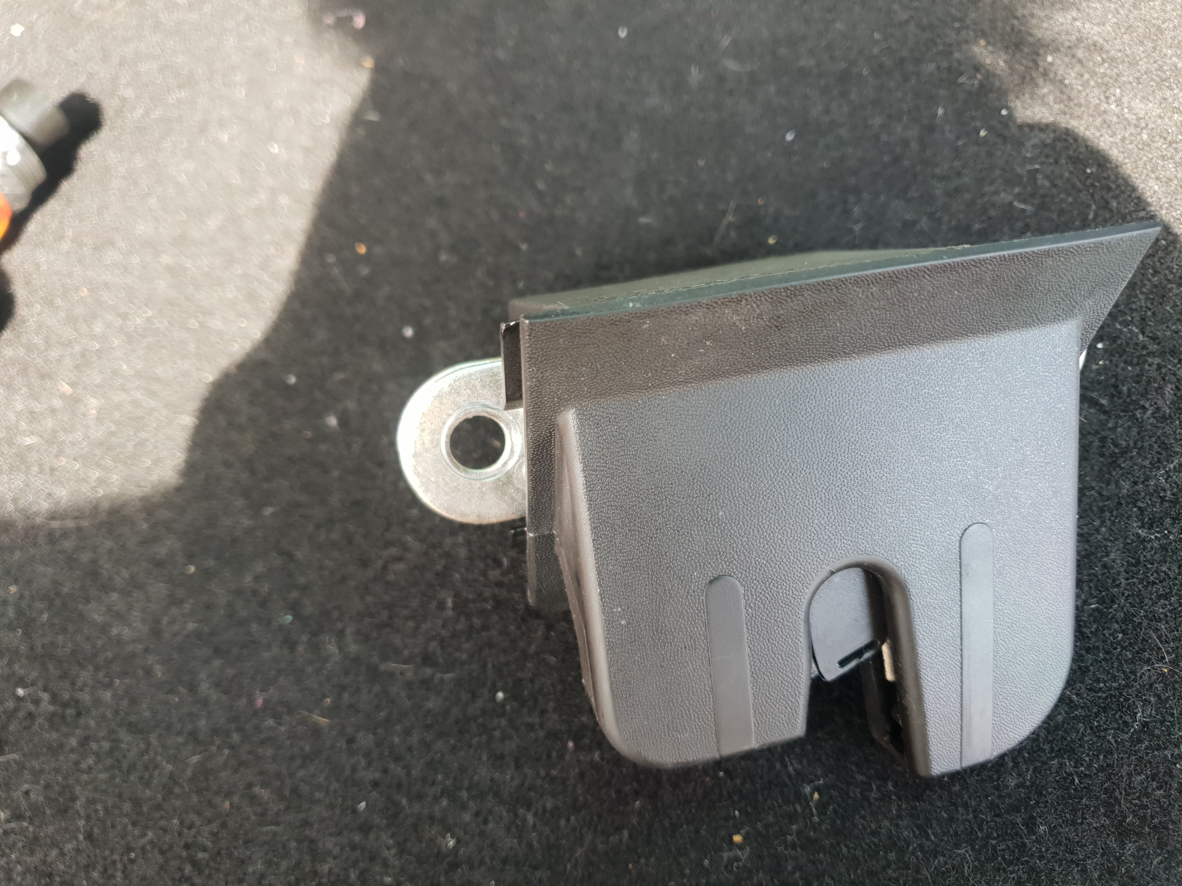

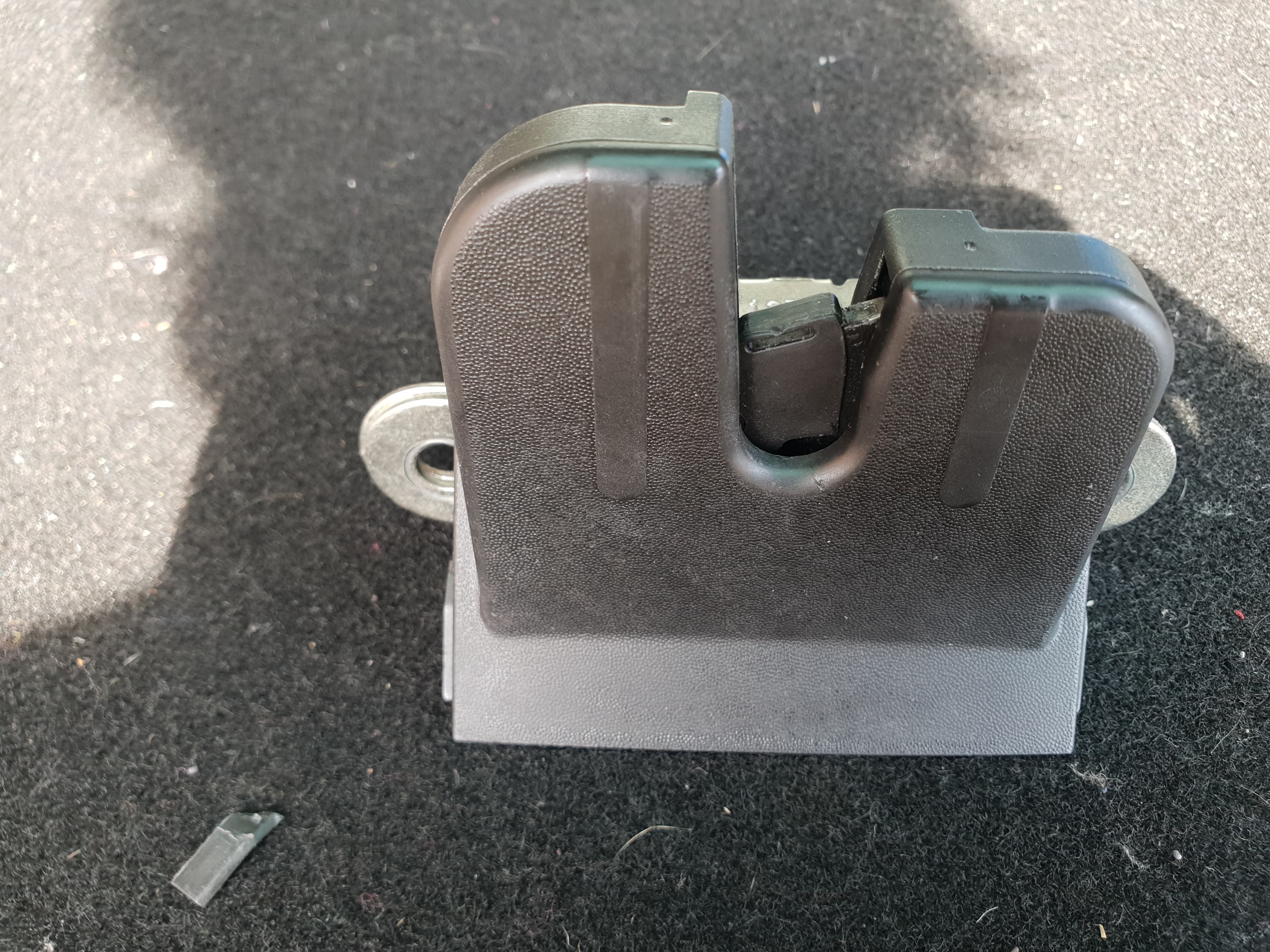

Hi, i only just managed to get a tool to take the boot latch off, i tried so hard to take the latch apart but the plastic is so tight i cannot work out how to take it apart?
Im thinking ill just have to buy the whole latch and replace it rather than just the worm screw :( which is a disappointment.....
Does anyone know how to take the latch apart ? as in the plastic stuff ?
35067538_10217160006218937_615311488864747520_n.jpg 35102538_10217160002338840_1741552712463417344_n.jpg 34963410_10217160004338890_3290952668322725888_n.jpg 34984342_10217160001298814_3220186974677630976_n.jpg 34887465_10217160002578846_2092313487412822016_n.jpg 35065942_10217160005578921_552073249391902720_n.jpg
I never could figure it out,its still disconnected on mine.
I dont think it actually does come apart,I took apart the door locks and rebuilt those , but the boot lock seems to be moulded shut
One thing I did notice on the locks was that the nylon coating on the door lock "jaws" wears away and the bits of it seize the jaws from moving smoothly,and so they stick or dont move through full motion.
thenylon is there to stop the door clanging/sounding cheap when closing it,so my "cure" after removing the coating was to wrap the door lock bracket that is fitted to the car with teflon tape ,no more clang,
The plastic shroud does come off. I took mine off to figure out what was going on when my latch broke.
You need to prise it clear of the 4 metal lugs on the inner facing side of the latch, then it'll pull off.
Reactions: grrf
oh thanks rusty,do you mean the 4 metal lugs as seen in picture one above?
