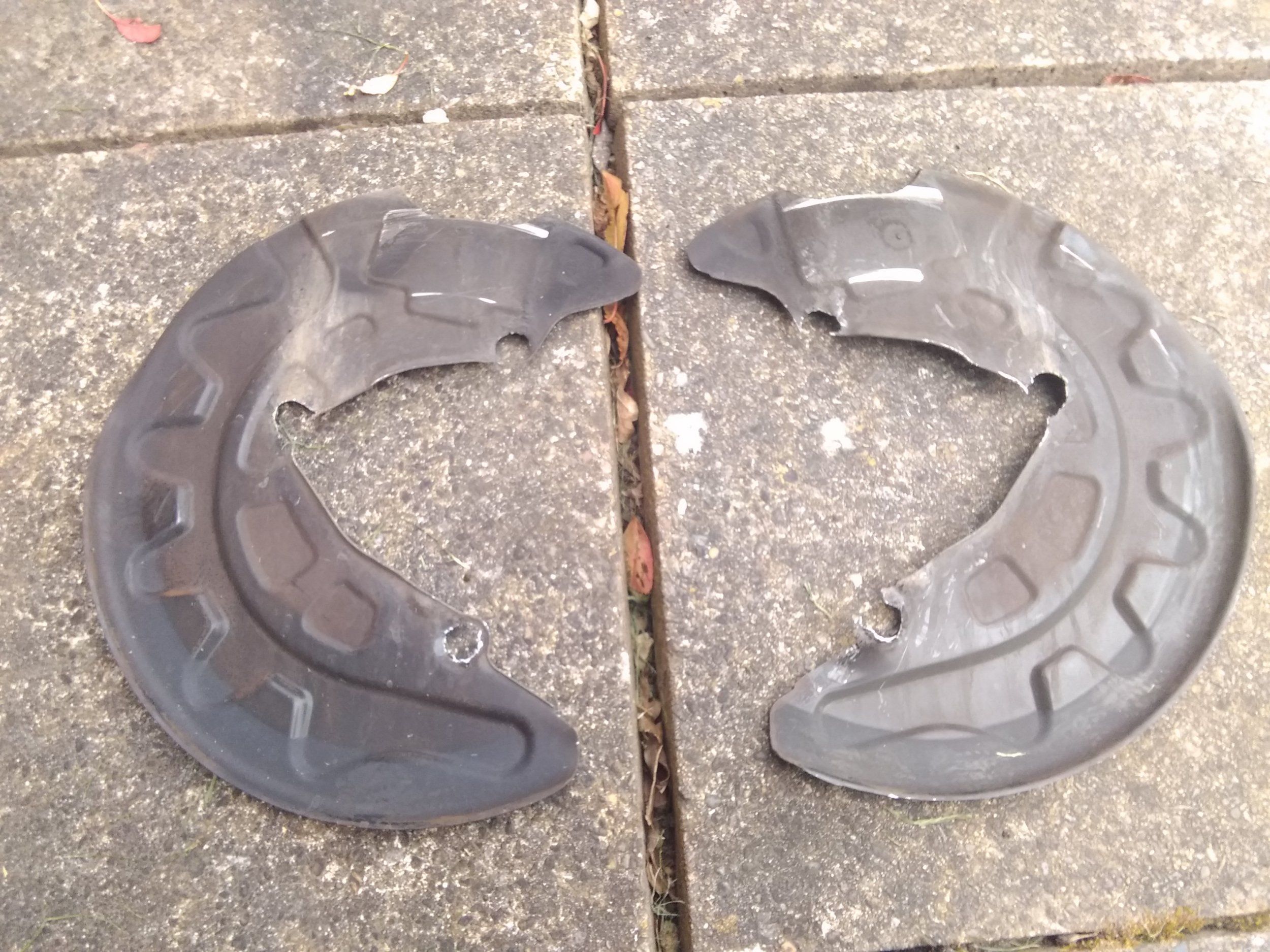

I'm guessing that these knackered ones are aluminium alloy?
If so, maybe a good reason to buy steel aftermarket replacements.
I originally was quite happy when I bought my slightly used 2011 Audi S4 in 2013, to see that it had unpainted alloy discs back plates - after starting to read many tales of back plates coming loose/free and seeing that most of them are alloy, I'm not quite so happy about having alloy ones now!
Rapidly dissolving aluminium alloy heat shields that you can repair with bits of tin plate is almost acceptable, the same thing happening with brake back plates/covers, is not so ideal.
Reaction between 2 dis-similar metals. They always go at the contact point to the bolts / hub.
They are crap tbh
I checked mine (original alloy type) when I did my front wheel bearings and they were perfect - at around 100k miles and 6 years old.
As long as you have no contact between the steel bolts and allot covers you'll be fine.
Thinking out loud! my 184 has alloy front knuckles - where as the 150 and lower have iron knuckles!
I think (hypothesise) the incidence of corroded alloy dust shields will be higher on these lower power versions with an iron knuckle due to the higher chance of a galvanic corrosion.
I've seen some wheel cleaners really eat into these dust shields - both steel and alloy ones.
Ah, fair comment, my S4 will also have alloy suspension parts, so as long as the fixing bolts used have that effective green barrier coating, there should not be an issue.

Some nylon washers may be a worthwhile upgrade to keep them from contact with each other. One between hub and backing plate and one between backing plate and bolt. Not sure if they would take the heat though ?
There are probably more suitable engineering materials for doing that, it would/should suit DIYers, but not professionals where time = money, for some DIYers, a bit more money can mean saving money!
Edit:- my 2011 S4 that has alloy uprights etc is fitted with unpainted alloy brake covers, many of the alloy brake covers that I've seen pictures of, look a lot like they have a coating/paint on them, so maybe VW Group are taking steps to minimise this being an issue on cars that have ferrous uprights. VW Group used to at least always supply "green" coated/dipped bolts for use where aluminium alloys existed near ferrous components, these brake cover bolts are certainly coated with something, not the translucent green coating of the past, but a darker coating, although that might just be a typical corrosion protection and not protection against dissimilar metals being in contact.
