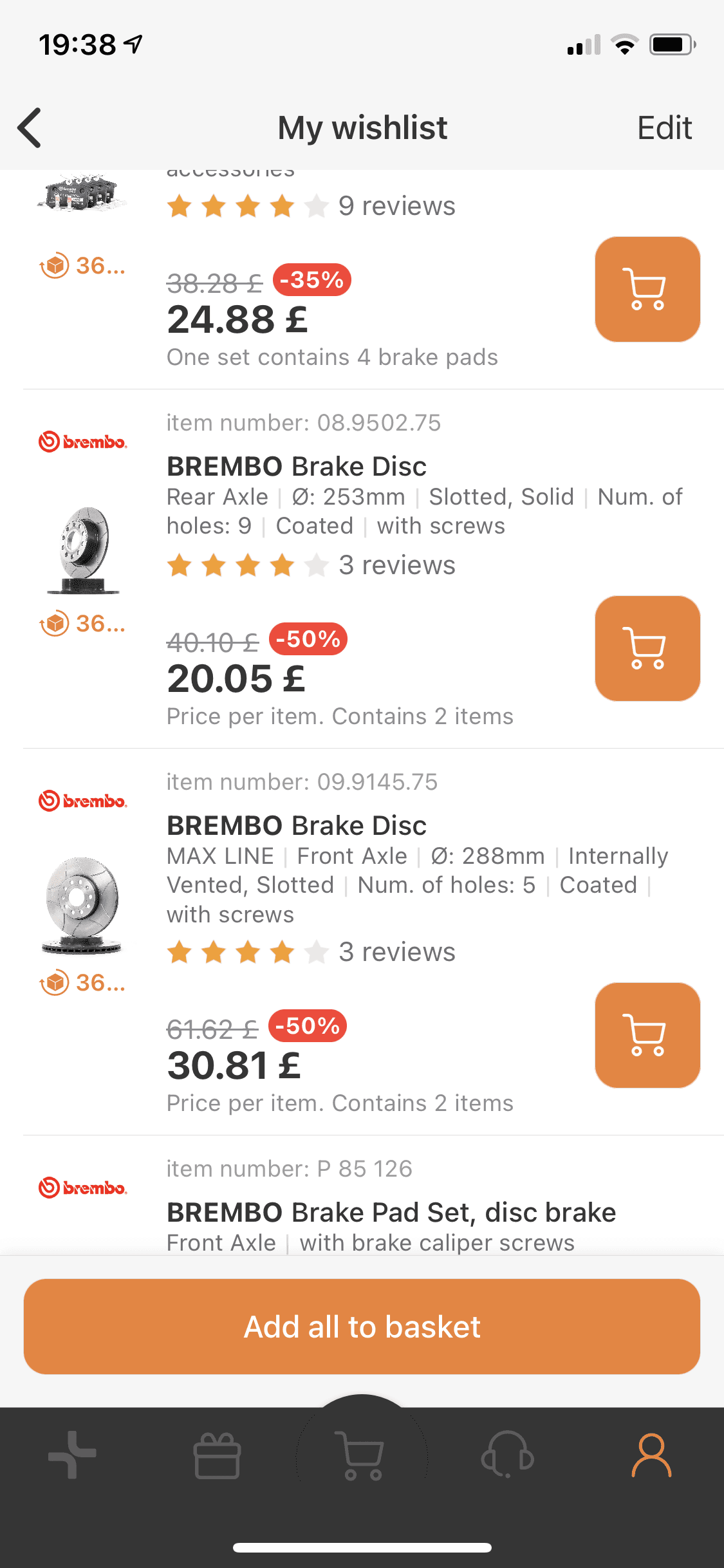

I reckon im in need of new disks and pads all round, what disks and pads do you all recommend?
Are you sure you need front AND rear? have you measured them?
