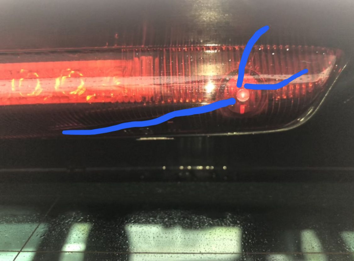

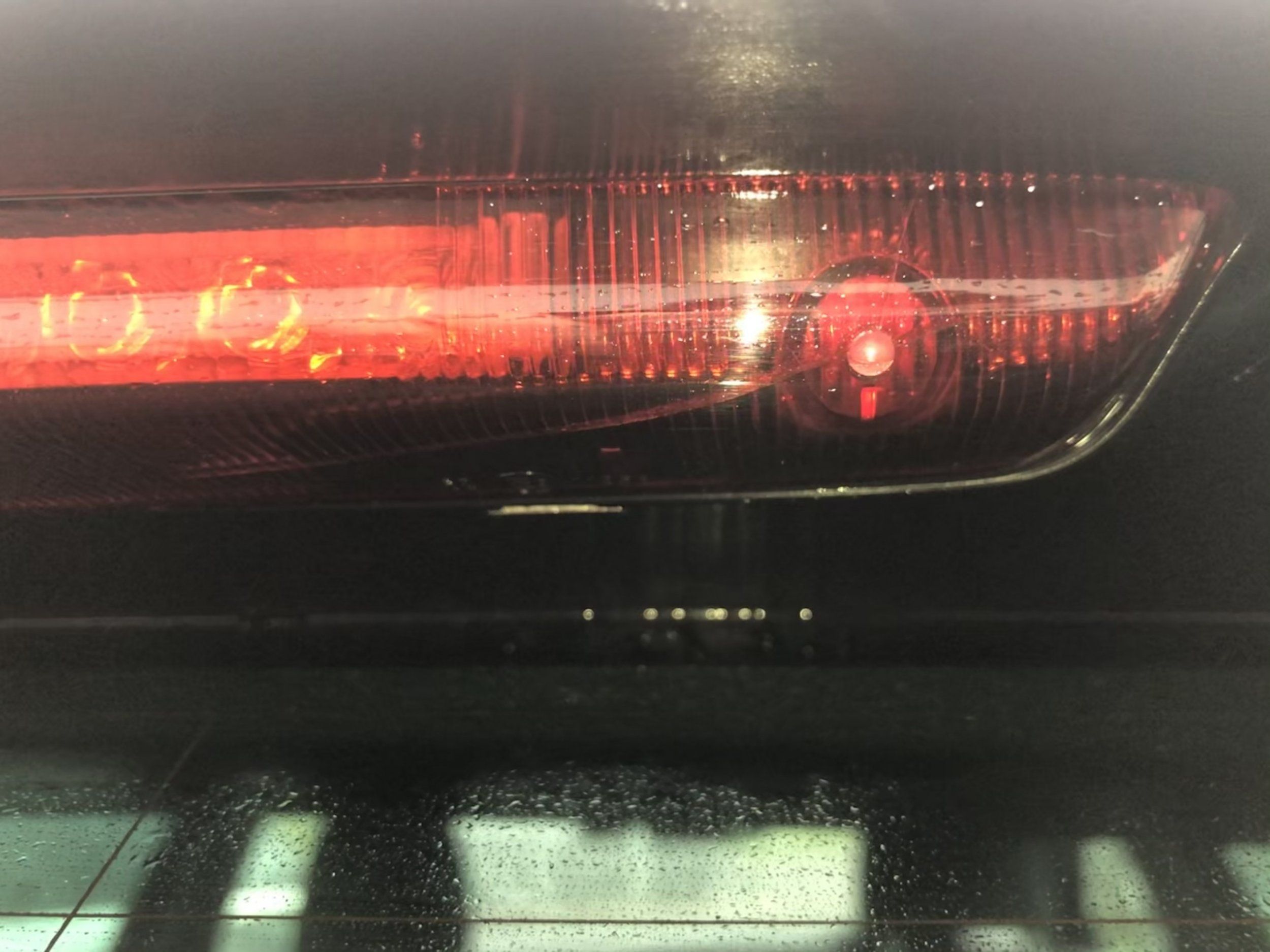

Yes the cracks are obvious without having to remove.
Not too sure if the Cupra lens has a darker tint or if it’s due to the ST design, but not so easy to spot.
Photos from my car here (direction of cracks shown with blue overlay):

Yeah, that's pretty clearly cracked, though the shorter ones are quite fine. Mine looks ok...

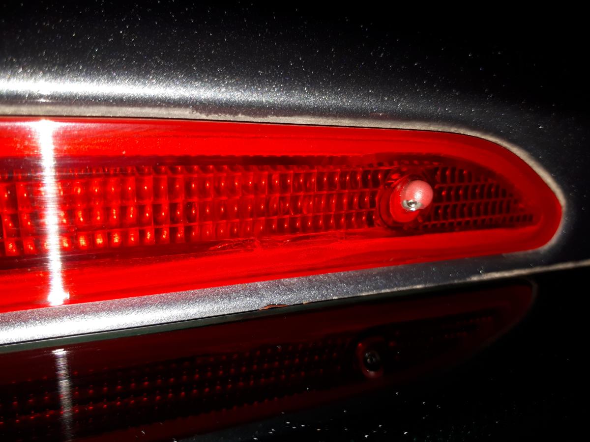

The light monitoring is usually reliable when indicating that something is failing in the LED light units.
The other issue might be the rear washer pipe work leaking onto the brake light assembly/connector.
