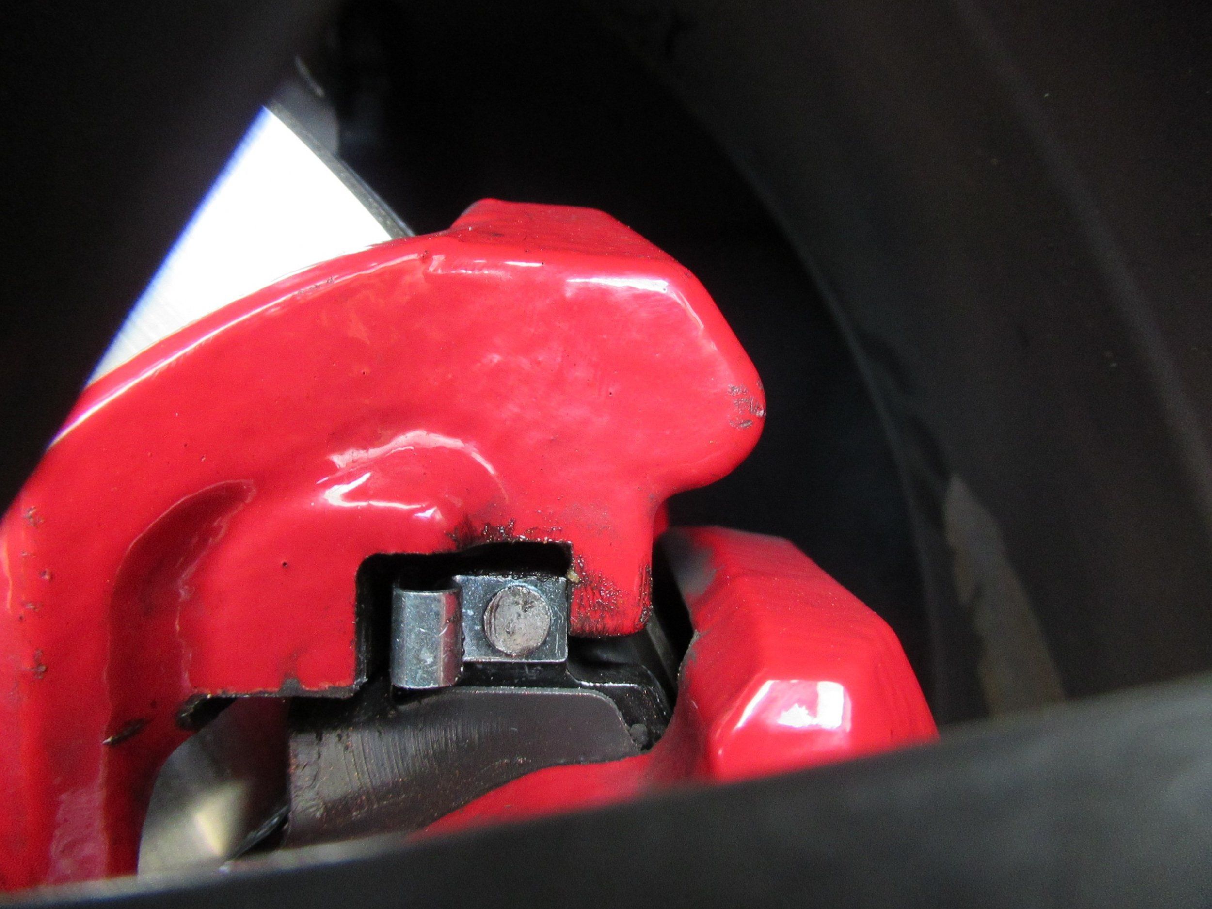

Hi all, really could use some help.. Just replaced all my discs and pads from stock to Brembo.. however the front pads are making a horrible knocking noise when going over small bumps / dips.. I've narrowed it down to the pads just do not fit.. see attached image.. the part number is P85144 when i put my reg into euro car parts etc.. they all bring up the same pads 175mm it's only when looking at other sites that provide OEM spec brakes I find ones that are 175.2mm which are the ones i took off previously.. am I doing something wrong or had anyone else had this problem?
What's your car? Cupra? with 340mm discs?

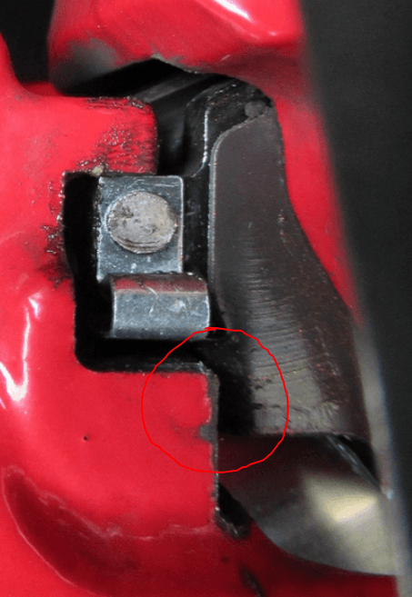

This brake system design relies on the lower shoulder (circled) to constrain them laterally (side to side) - their overall width is only clearance so not important.
The OEM (genuine VAG) pad uses a multi layer composite shim - around 1mm thick. I often see aftermarket brands copying the backplate size but fitting their own cheap/thin shim - which will effect this critical fitment dimension. Can't make out from your photo how much clearance you have with this shoulder?
Did you actually receive P85144? as there is a smaller (similar looking) variant for 312mm discs which is 15mm narrower (P85126)- so 7.5mm each side looks like your gap could be around this size?
Brembo P85144 - using a cheap/thin shim

Hiya super thanks for the reply, the car is a 2015 seat cupra 280 and yes the brakes are 340mm front 310 back - the pads i've got are 175mm P85144. I think you are right about the brembo shim just being crap as well.. I've just checked and that corner you are referrring too is getting squished / bent inwards which is making the gap even worse.

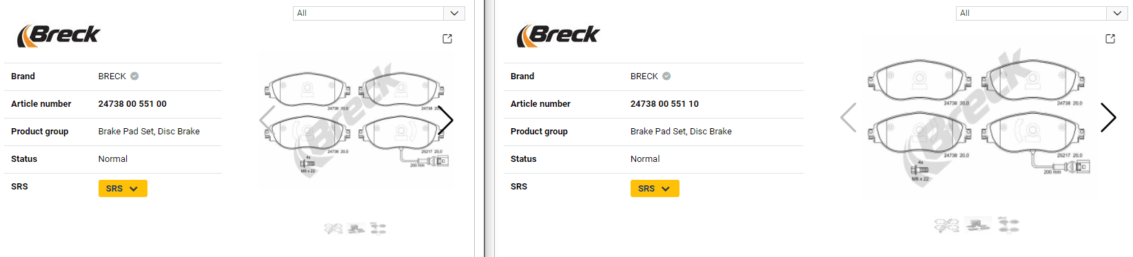

So I have just fitted the replacement pads the part's supplier gave me to replace the brembo pads. I hadn't heard of Breck pads before but they seemed decent enough quality and fit a dam sight better and more snug than the Brembo's!!! Early days as only driven my usual commute home but not a single knock or squeak from them so happy day's. Part numbers in picture's below

Did this pad have piston cutouts like in the label image?
If yes then this is the wrong pad i'm afraid.
The Alhambra has a wear indicator the opposite to our Leon's - which means they are handed left and right it they have piston cut outs. Piston cut outs are designed to slightly angle the pad contact to the disc to help with noise - bit like you do with squeaking bike brakes.
I would also suggest that pad is too low in the carrier - meaning there is a large amount of disc above the friction material.

Whenever a brake pad has a crescent shaped cutout on it's anti-noise shim this is called a piston cutout, and its there to reduce the pressure on the pads leading edge to help reduce the chances of brake noise.
VAG in their wisdom changed the wear indicator sides from the LH side on the older Volkswagen Group A6 (PQ46) (Sharan) platform to the RH side on our newer MQB platform cars (Leon 5F) This means the pads are not interchangeable between the two (even though the back plates are dimensionally the same).
Breck have 2x 'similar' part numbers,
24738 00 551 00 = Sharan/Alhambra
24738 00 551 10 = Leon Cupra/GTI
Afraid you were given the wrong 24738 00 551 00 part number for your car.
If the brakes are quiet then don't worry about it - but if you get brake noise this would be my first port of call.
From Breck's own catalogue:
