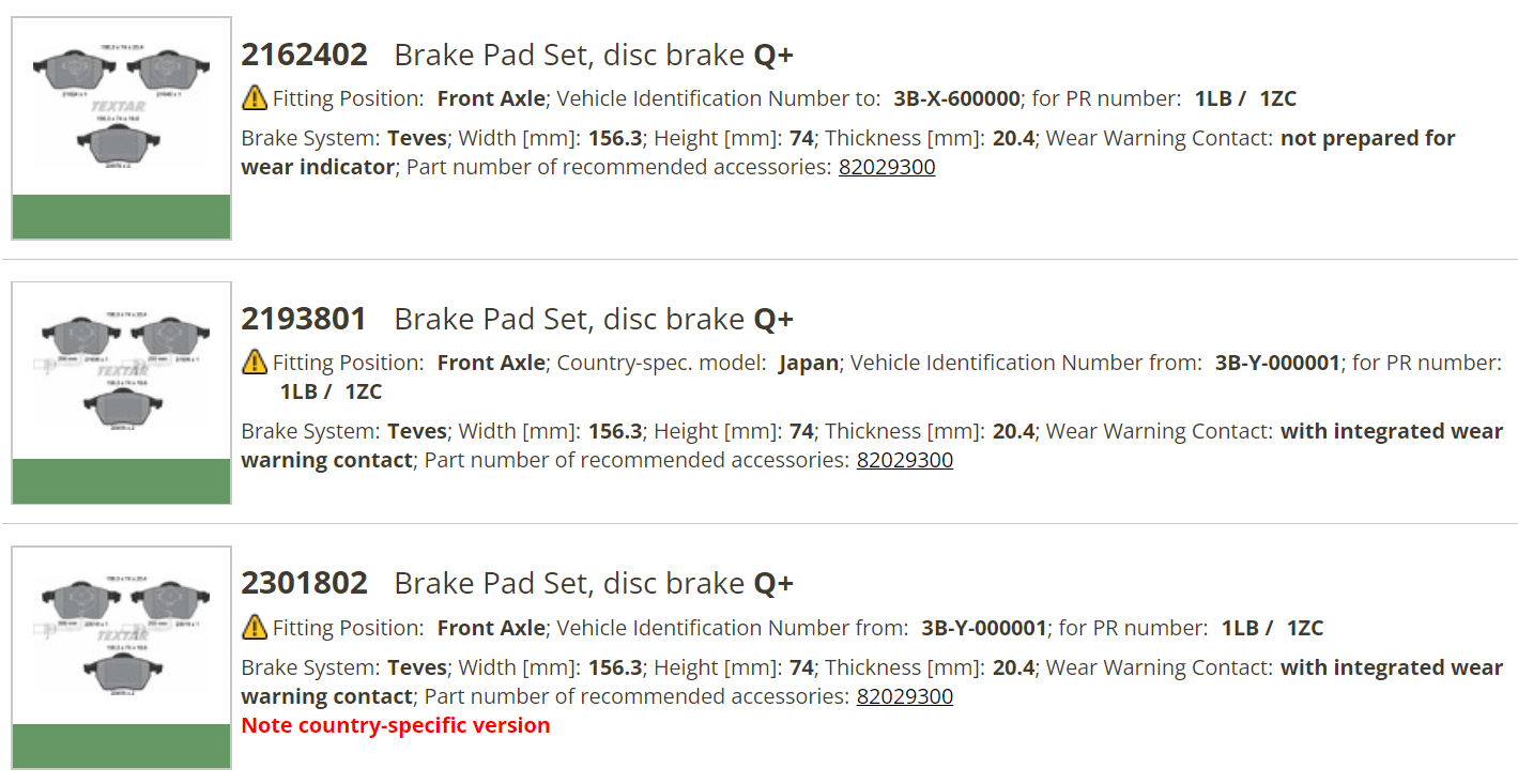

I remember that the first Textar pads that I bought for the ATE front brakes on my 2000 VW Passat 2.8V6 4Motion, from ECP were listed on the manufacturer's web cat as being only for Japan market cars.

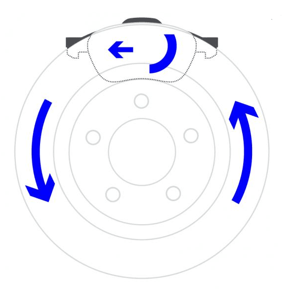

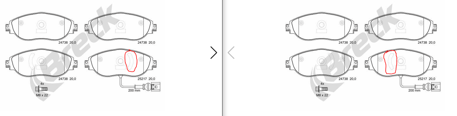

Whenever a brake pad has a crescent shaped cutout on it's anti-noise shim this is called a piston cutout, and its there to reduce the pressure on the pads leading edge to help reduce the chances of brake noise.

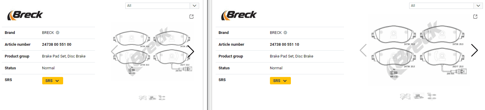

VAG in their wisdom changed the wear indicator sides from the LH side on the older Volkswagen Group A6 (PQ46) (Sharan) platform to the RH side on our newer MQB platform cars (Leon 5F) This means the pads are not interchangeable between the two (even though the back plates are dimensionally the same).
Breck have 2x 'similar' part numbers,
24738 00 551 00 = Sharan/Alhambra
24738 00 551 10 = Leon Cupra/GTI
Afraid you were given the wrong 24738 00 551 00 part number for your car.
If the brakes are quiet then don't worry about it - but if you get brake noise this would be my first port of call.
From Breck's own catalogue:

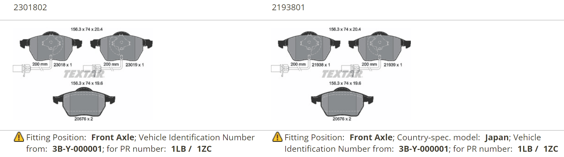

They still do!
2000 was a cross over year between the B5 & B5.5.
I would rather trust what Textar list vs what ECP list.
The differences are minor and would probably still fit - note the difference in piston back plate around the ears:
