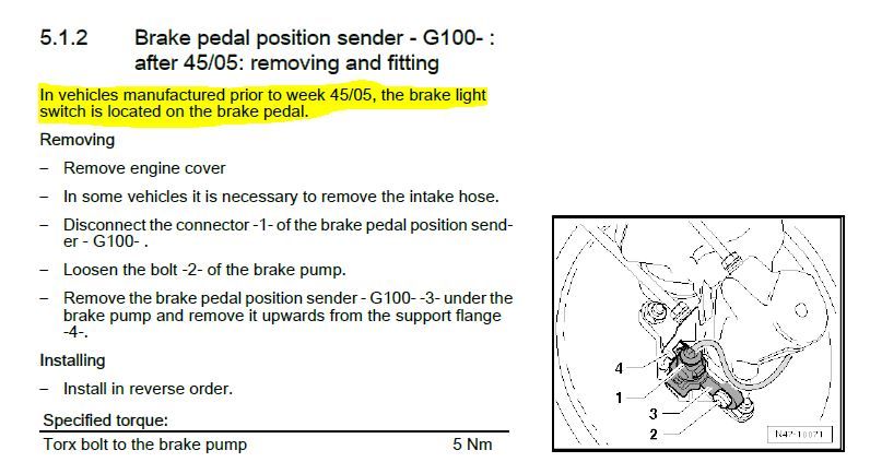

Not sure if this will help (took it from my workshop manual). If not, what part number did you find and I'll search the manual for that?

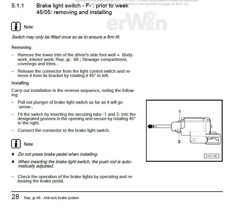

Mines a 2009 but the Pre-Facelift (09 not 59). I haven't checked mine to see if there is a switch behind the pedal, I just looked at the service manual this morning. This is the service manual for the MK2 which confused me when it said about the switch in vehicles manufactured prior to week 45/05. That to me suggests the MK1 (week 45 of 2005 is how I took it). There is a section before this about the switch used prior to 45/05 but it only has a picture of the plunger switch alone, not in situ...

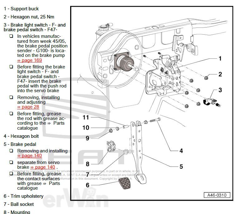

Just found another diagram, states its specifically for LHD (nothing for RHD, helpful) but it shows the switch isn't behind the pedal but actually at the front. Number 3 on the diagram
