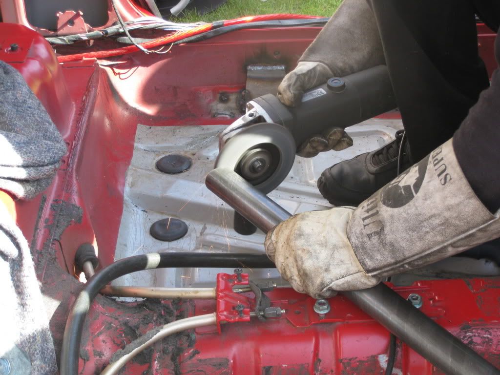

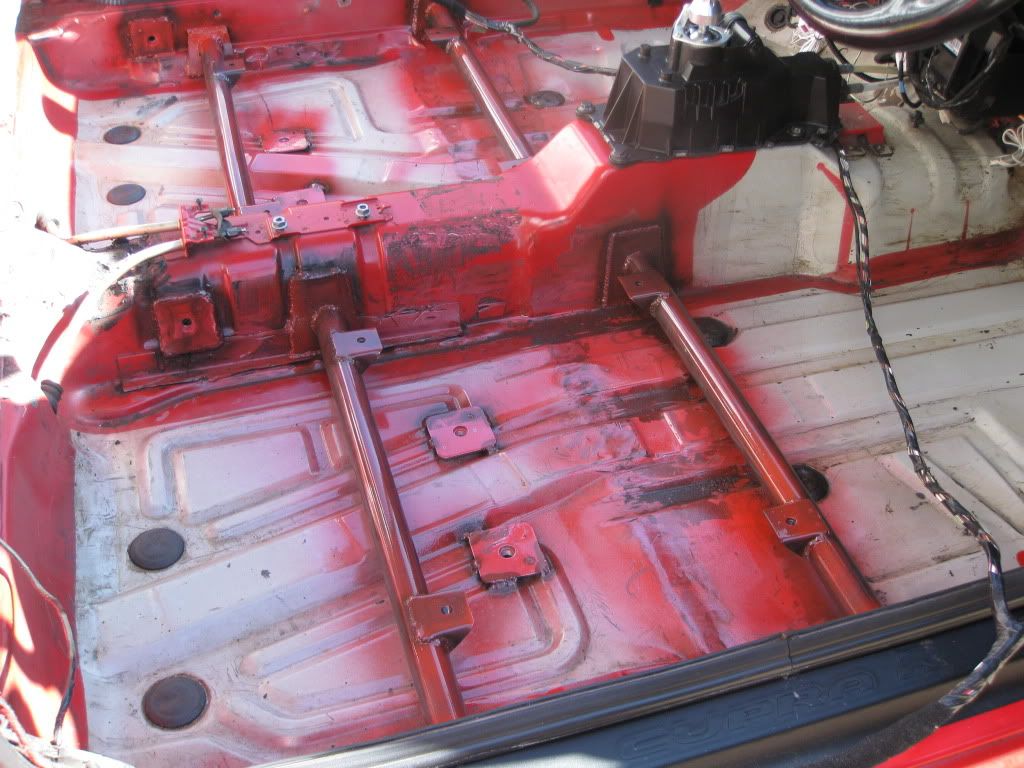

Cutting the angles on the bars
Beautiful

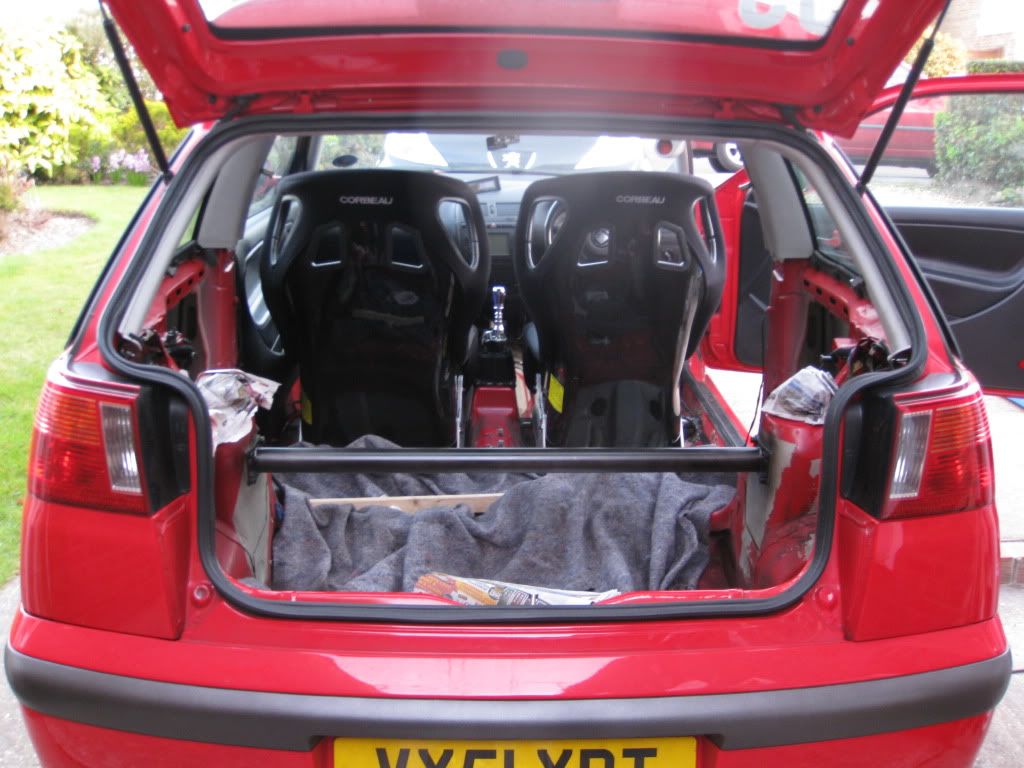

Passenger seat in
Harness bar mounted
Close to the door

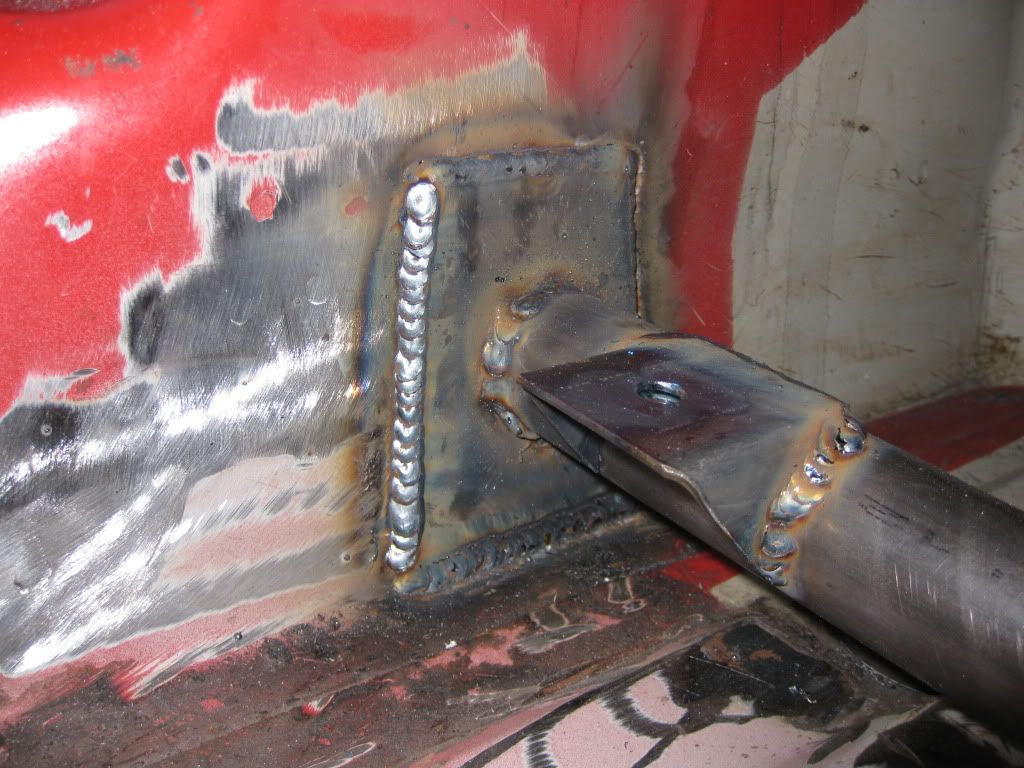

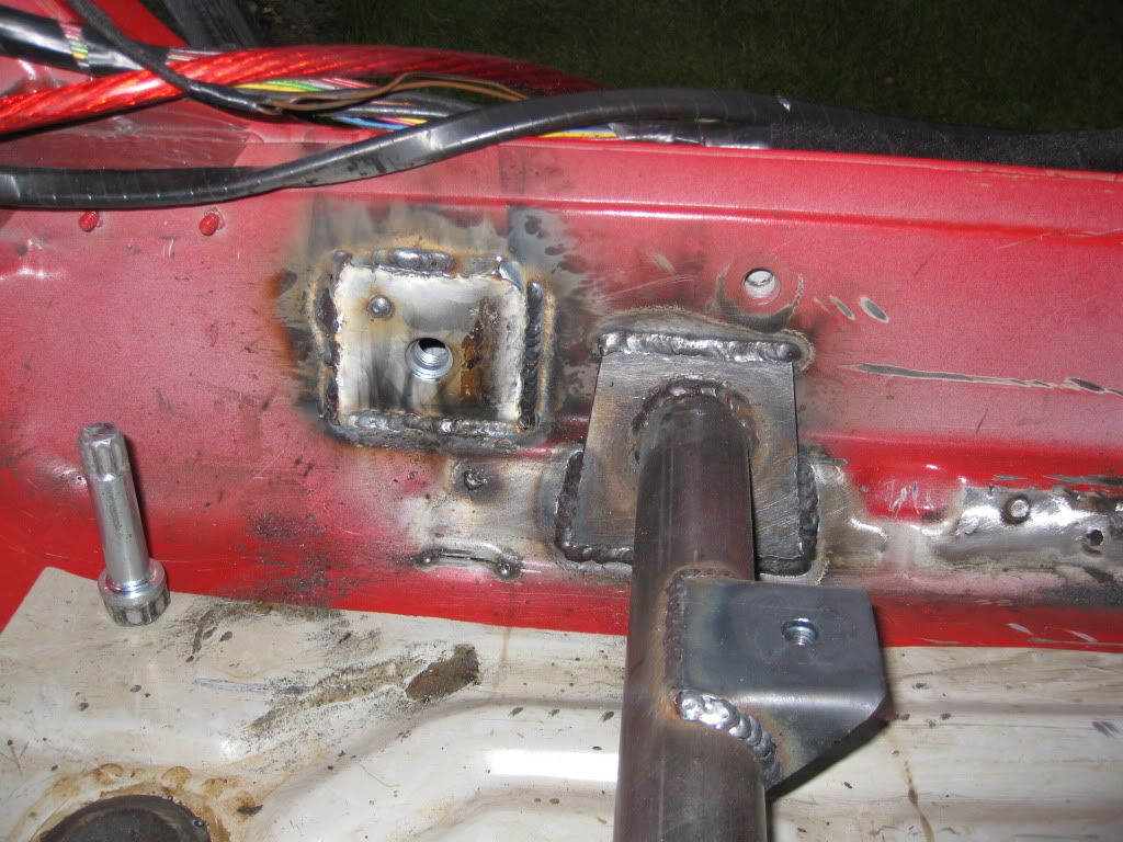

Missed this on the first seat, welding on the mounting points for the seat to mount to

Looking good Joe, seats look great..... thinking i may need a set of those for my build.
As for the seat mounts, is there any adjustment backwards and forwards or is it fixed ???
I've never seen any side mounts not installed so i was wondering how you set the position..

Graham,
I modified my side mounts to allow them to slide, simply by making the holes on the bottom into a long slot so I can loosen off the bolts underneath and slide them back/ forward to optimum position.
Just horrible to cut high tensile ally stuff.

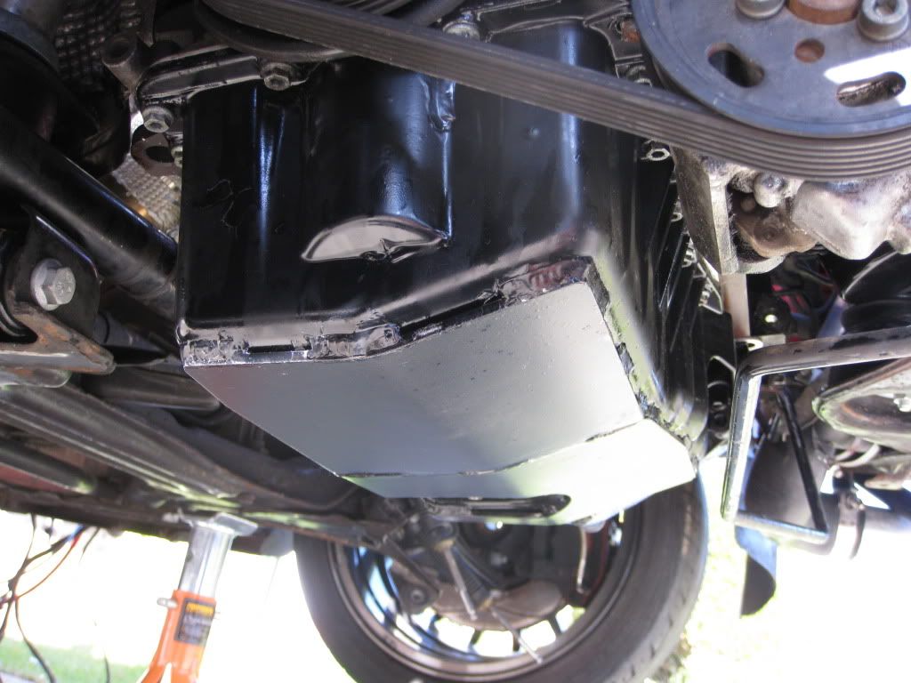

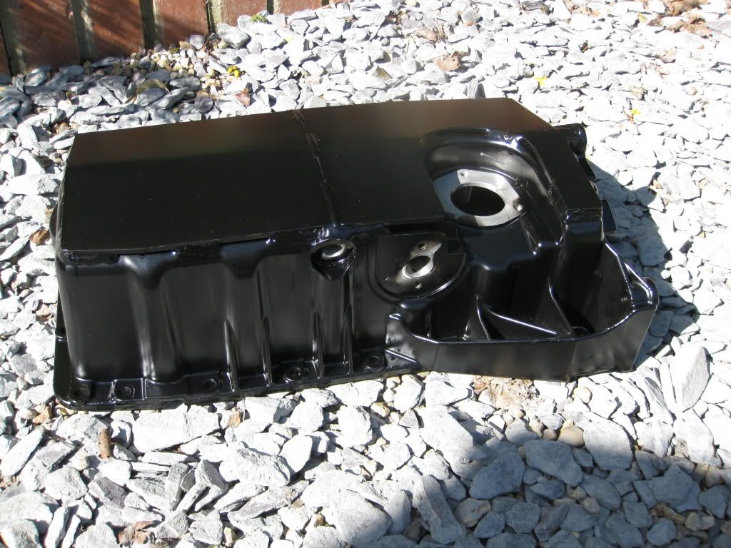

Same with the baffled sump
Fitted

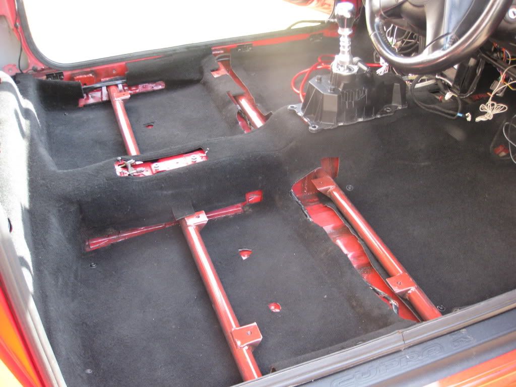

Carpet trimmed and refitted
Seats back in
Rear carpet fitted
As she stands now
