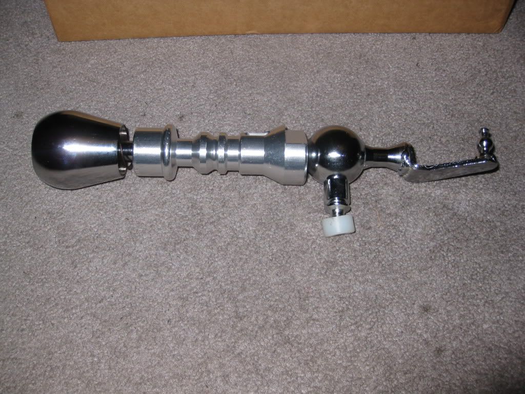

Pretty sure I will be able to solve this with a short shifter which has a pull up collar so my hand will be at the back/ behind the gear knob when engaging reverse. We'll see, if it needs adjusting then it'll be sorted.

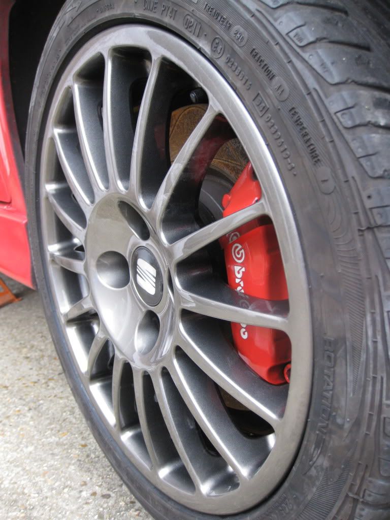

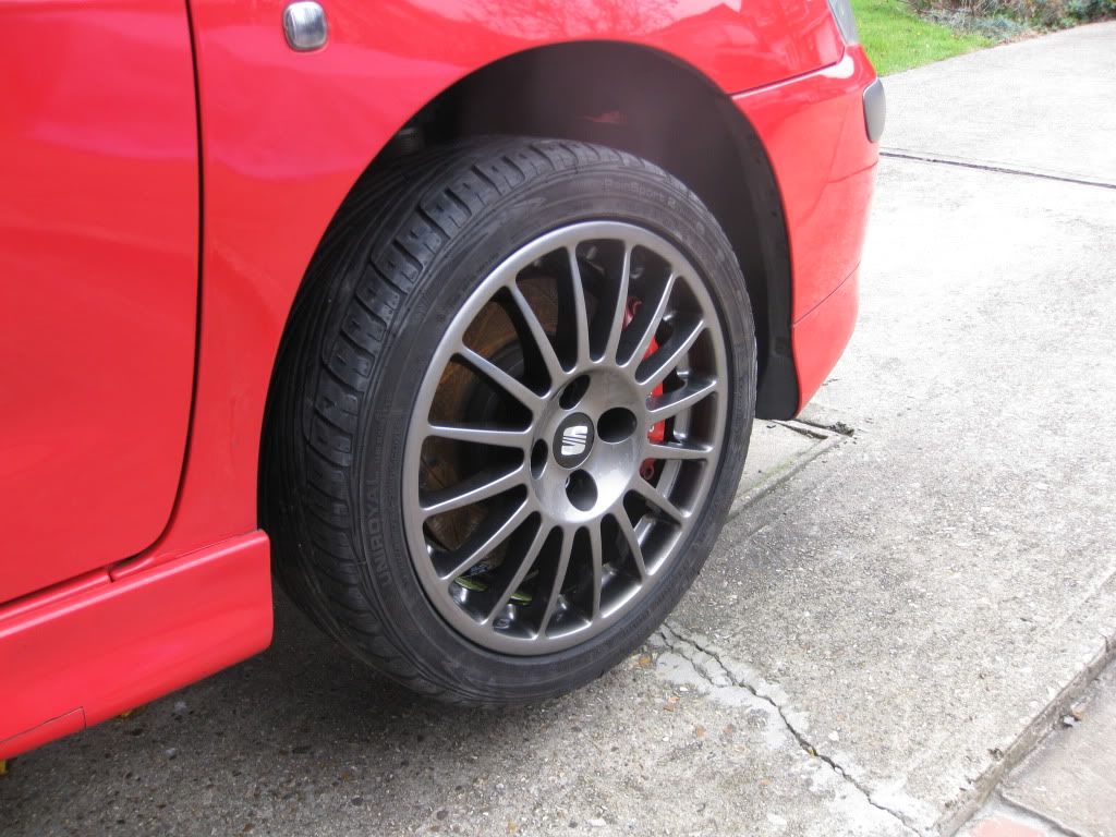

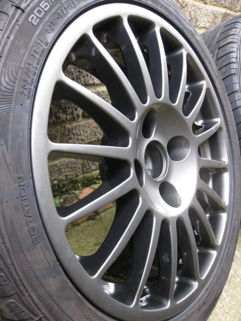

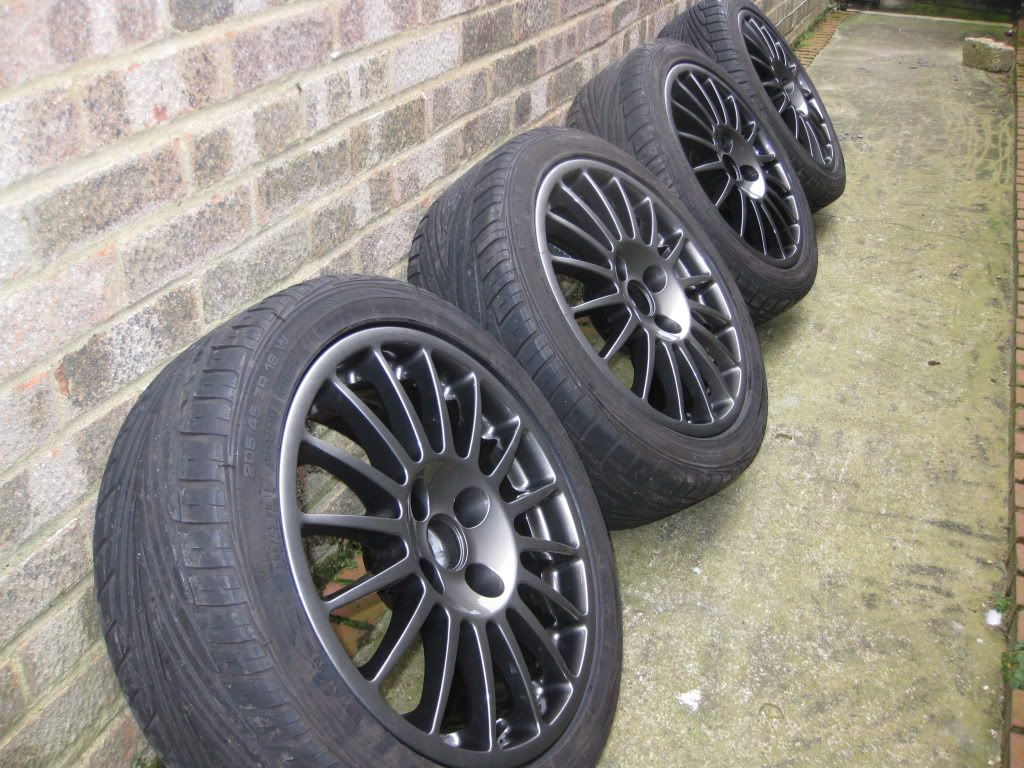

Finally got my wheels back, looking lovely! Pictures really do them no justice. The colour in the end was Rota Bronze - in the pictures they just look like anthracite but they have a real gold/bronze tinge to them.
Against the red

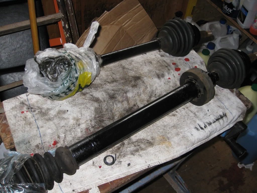

Finally painted my spare driveshafts

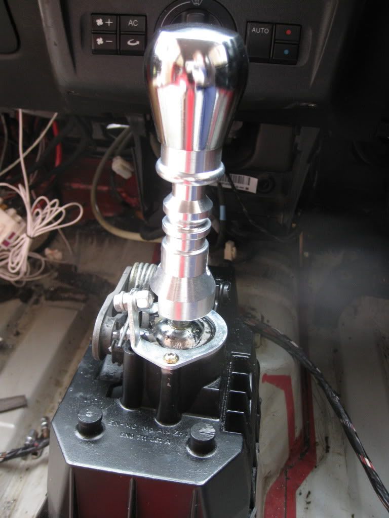

You gained much clearance to the radio by fitting the short shifter?
Just mount the box further back, I have no problems atall
Seems alright now guys. Also because it's a lift up reverse I'm pushing the gearknob from behind rather than hand over the top of it pushing it down (fingers used to catch facia).
Need to adjust a few things as it's now looser than OEM shifter, maybe because it's heavier? Who knows, but I need to look into it.

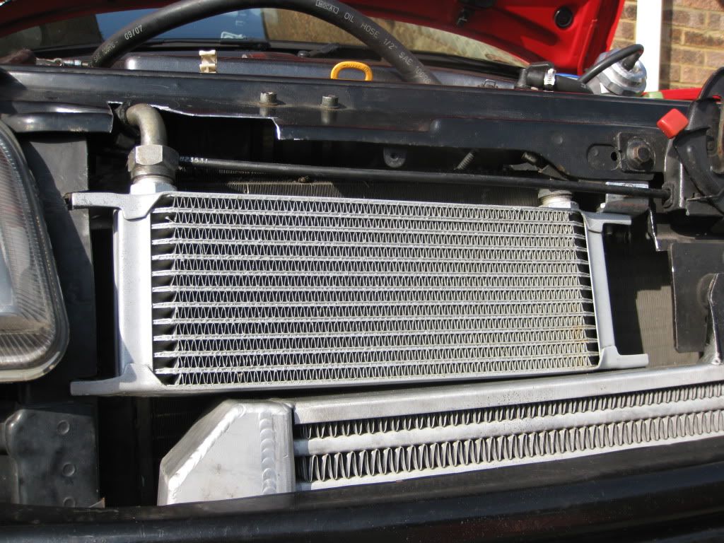

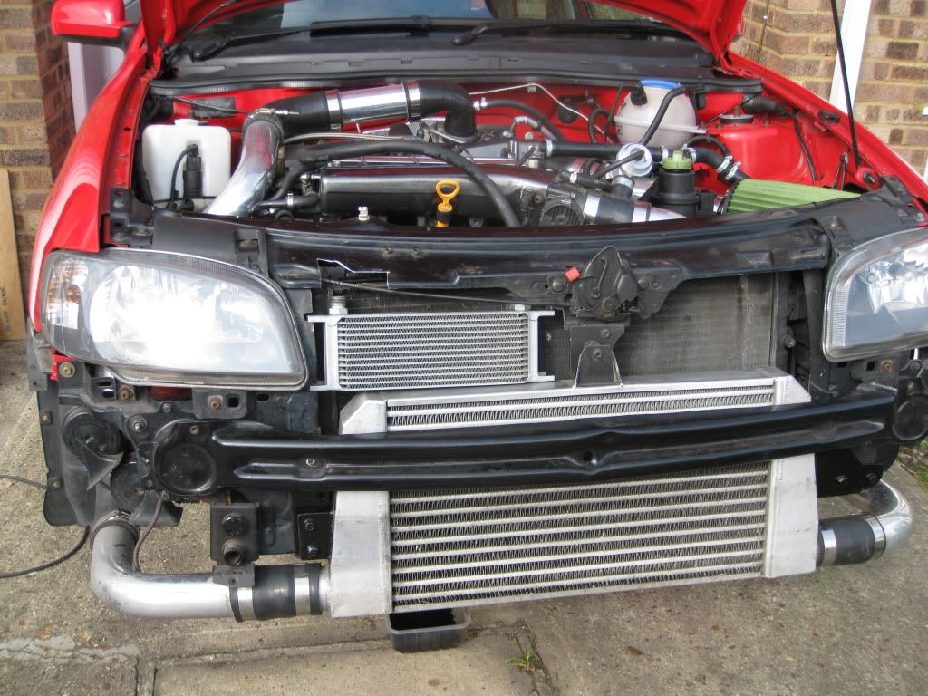

Got the oil cooler fitted in the end and Mocal thermostatic sandwich plate. Ditched the OEM heat exchanger as it was just going to be too tight with both coolers there. I've mounted it in a place which is going to get maximum air so shouldn't have to worry too much.
Absolute ball ache getting this thing in though. If I didn't get it second hand I would of opted for a slightly smaller one. Ended up removing the rest of the air con system in order to get it in.

What did everyone do about the coolant lines which go to the heat OEM heat exchanger?
Nice exhaust lol
Looking good mate, might look into an oil cooler some time, my oil temp was through the roof when i went round the nurburgring, i weren't going all out either lol
Youll be getting a bdm sump soon i suspect?
Nice exhaust lol
Thanks, I lightened the exhaust my removing the bolts which hold it in place.
Defo for the cooler, I managed to get it somewhere where it's going to get max air flow. Though I would get a smaller one!!
I have a baffled sump ;)

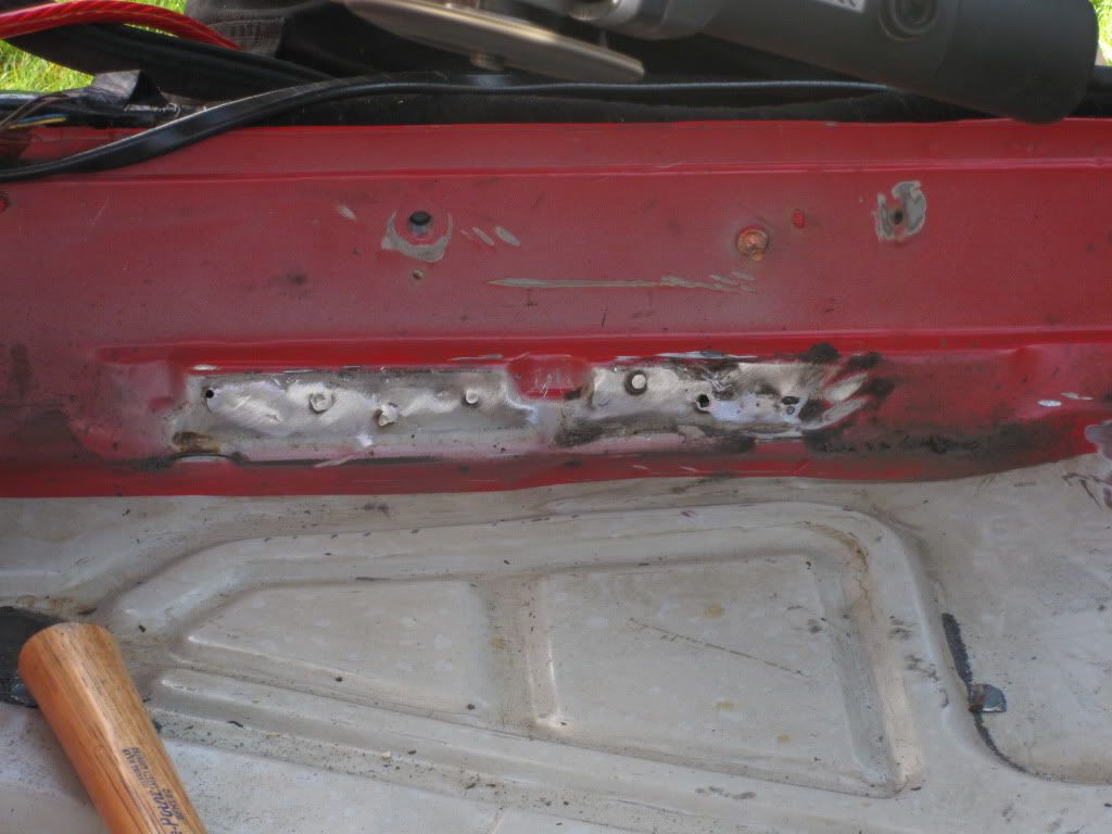

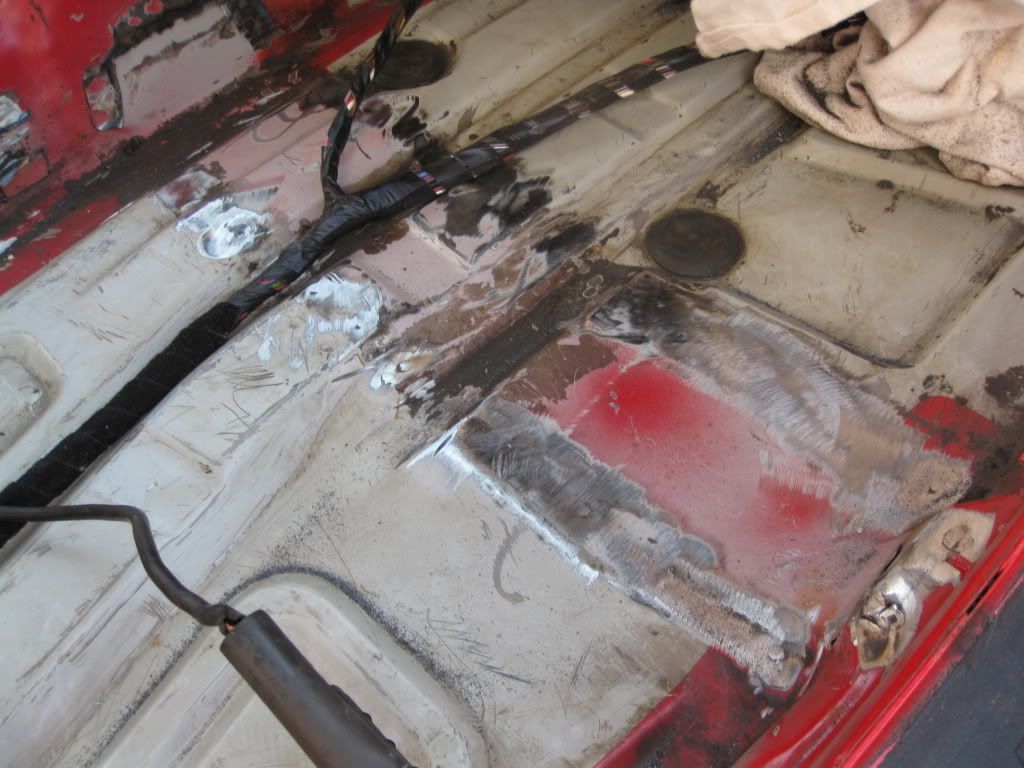

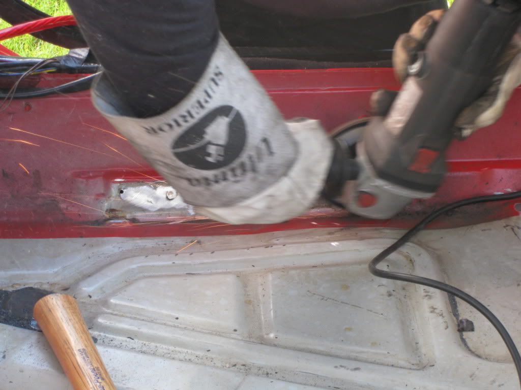

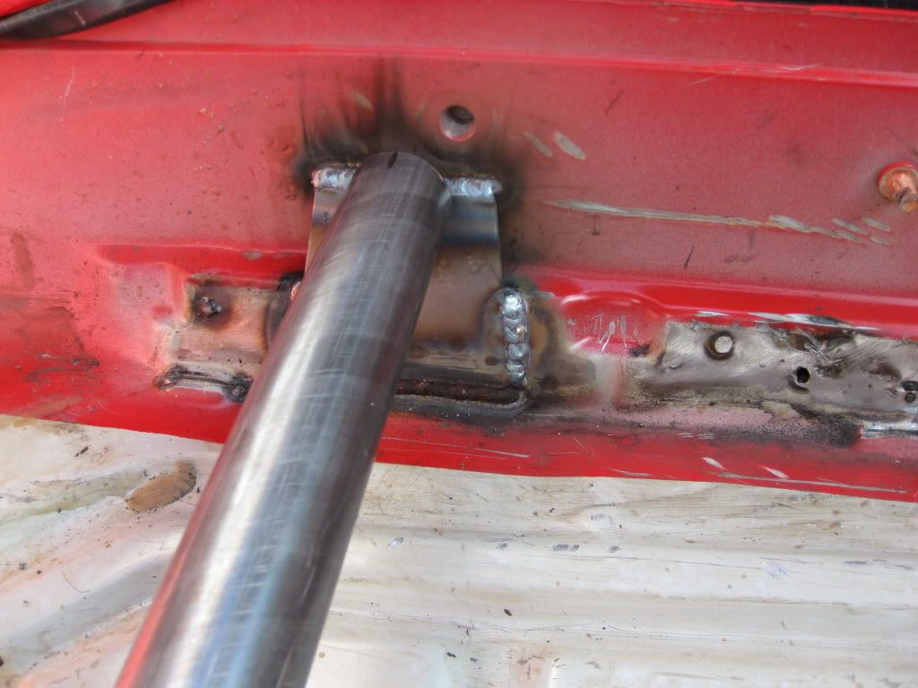

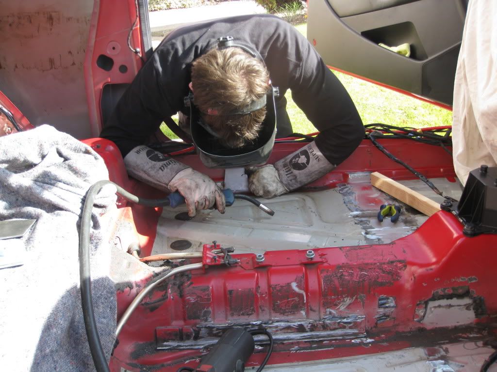

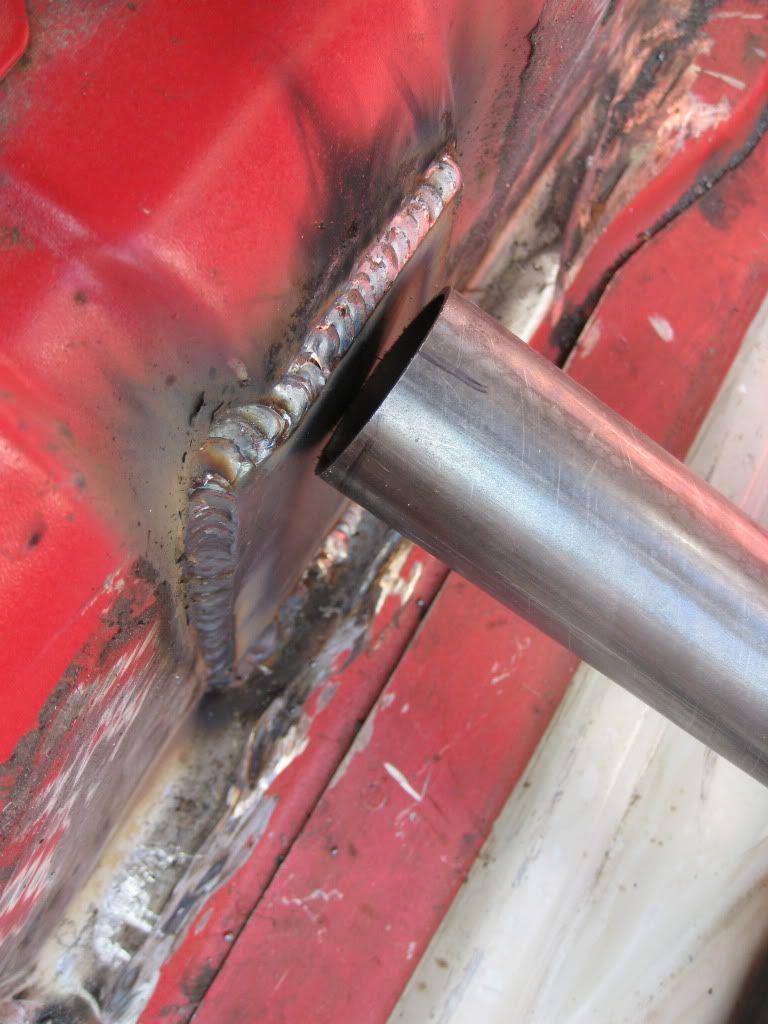

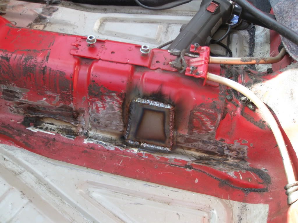

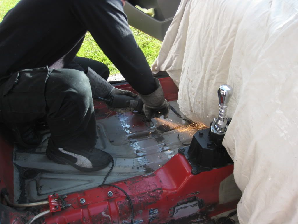

Had an awesome weekend. Alex, very kindly, came over to weld in my seat bars and give me my goodies... here's how we got on

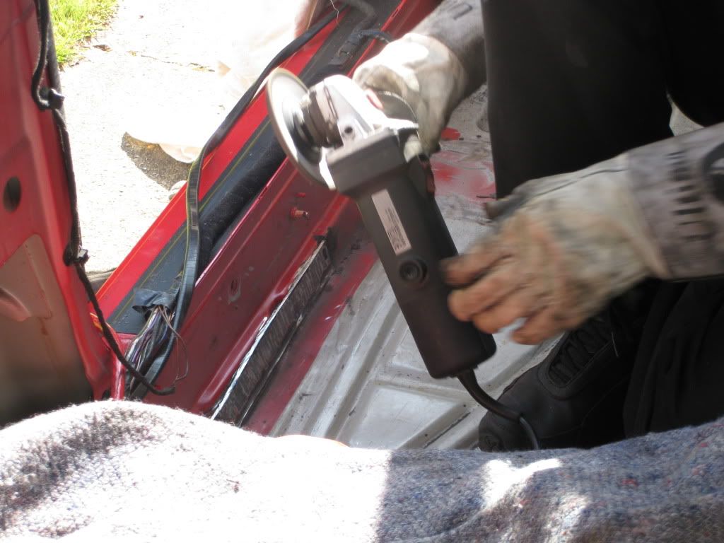

As you can see a little more grinding required to remove the final pieces of metal
Then to start the welding
