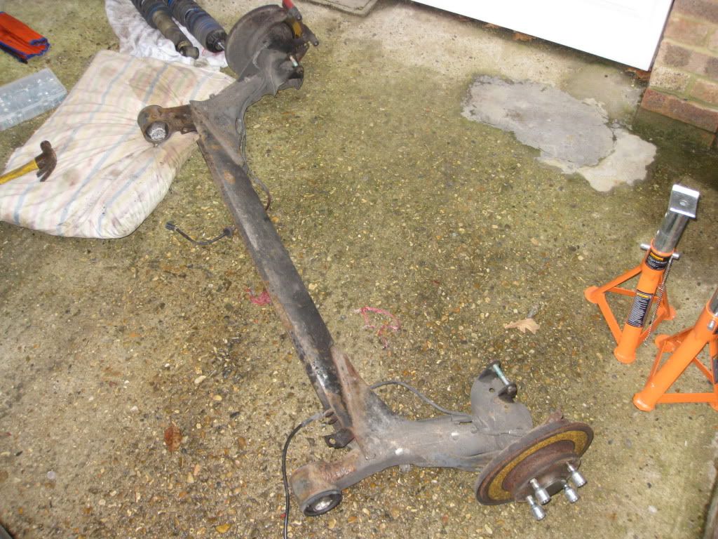

Right so after forever looking at the rear of my car and thinking something's bent I've decided to replace the rear beam to see if that cures the problem. The drivers side rear wheel had some serious negative camber (-2 degrees) so something wasn't right.

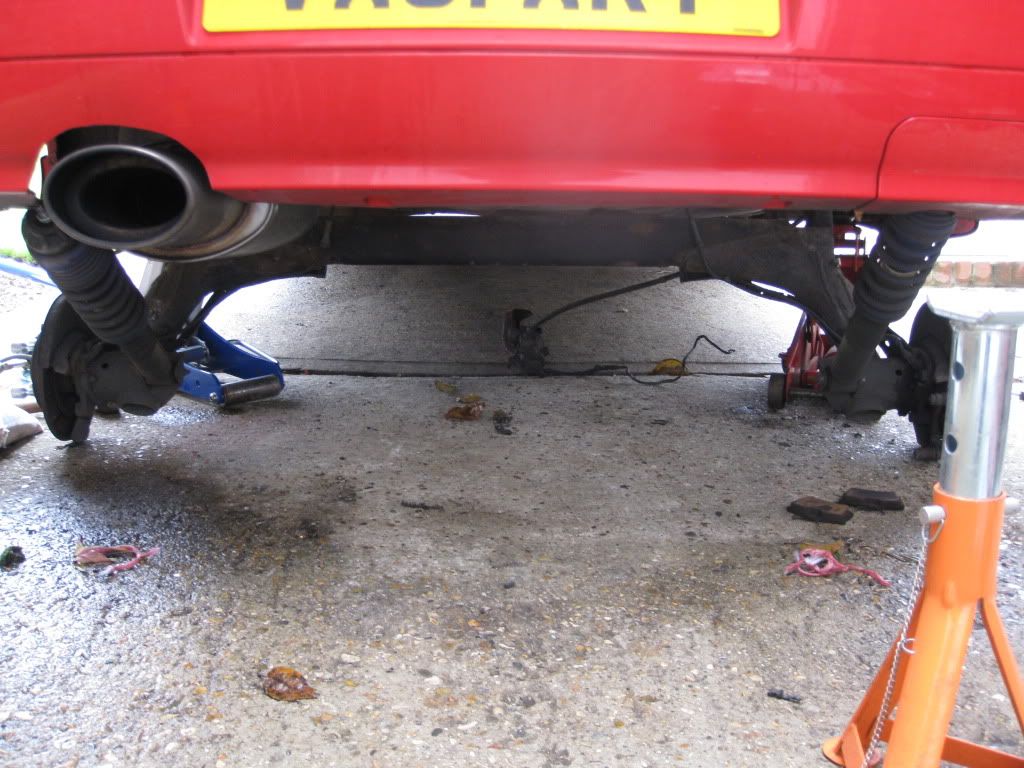

Dropping the old beam

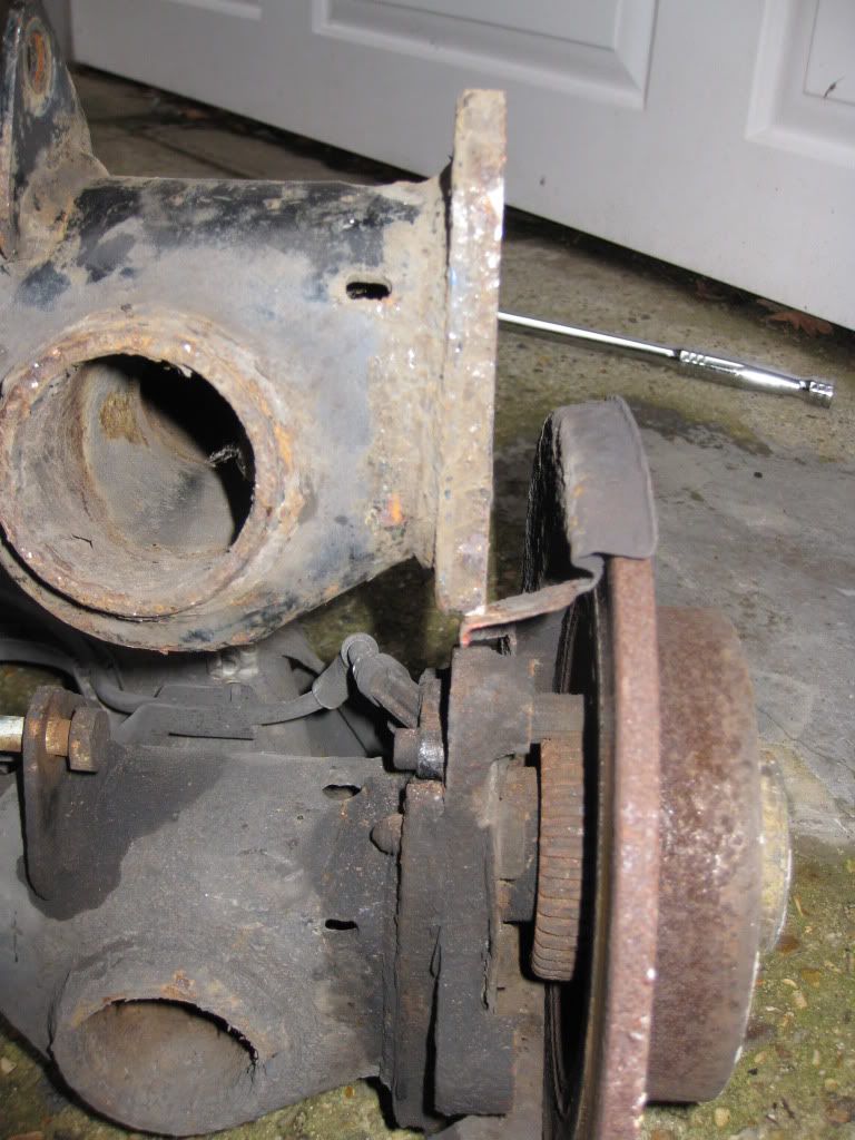

Here you can see I've aligned both beams and I'm not 100% sure but if you look at both ends of the two beams you can see the original (lower) sits in at the top

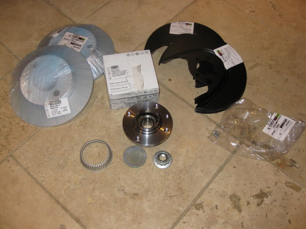

Good excuse to give it a good refurb, lick of paint.
In the picture you have dropping the old beam out, are the main bolts slack? The two that attach it to the lugs on the underside of the car.
Just curious, because if there still tight there and the beam simply dropped down to that position when you removed the suspension I would say that the rear beam has been off before.
