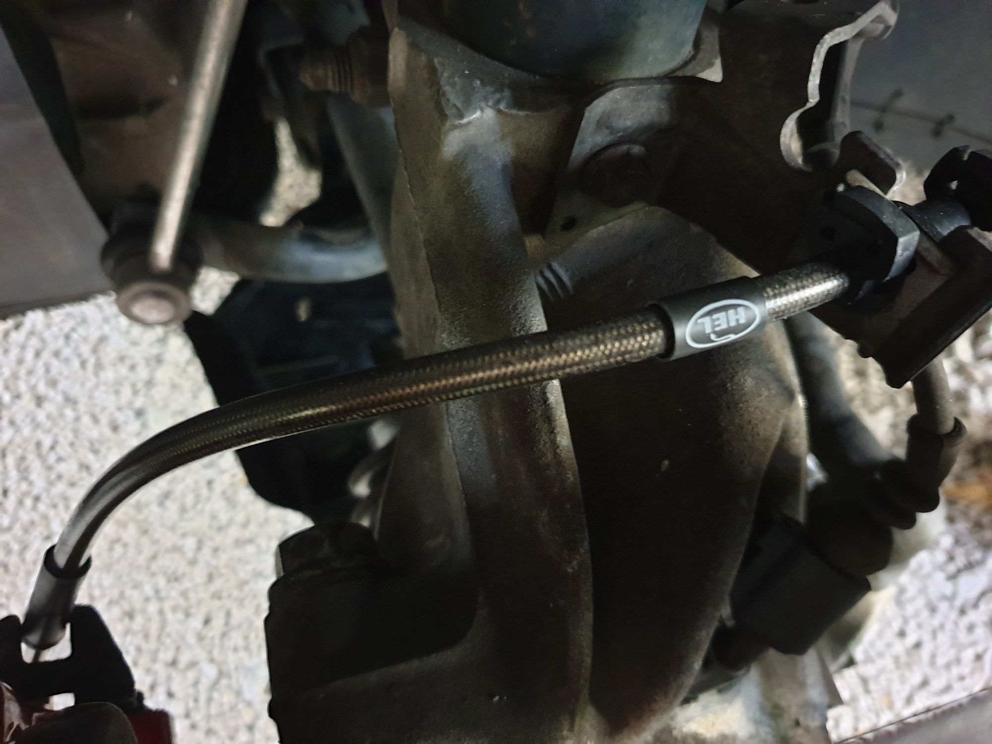

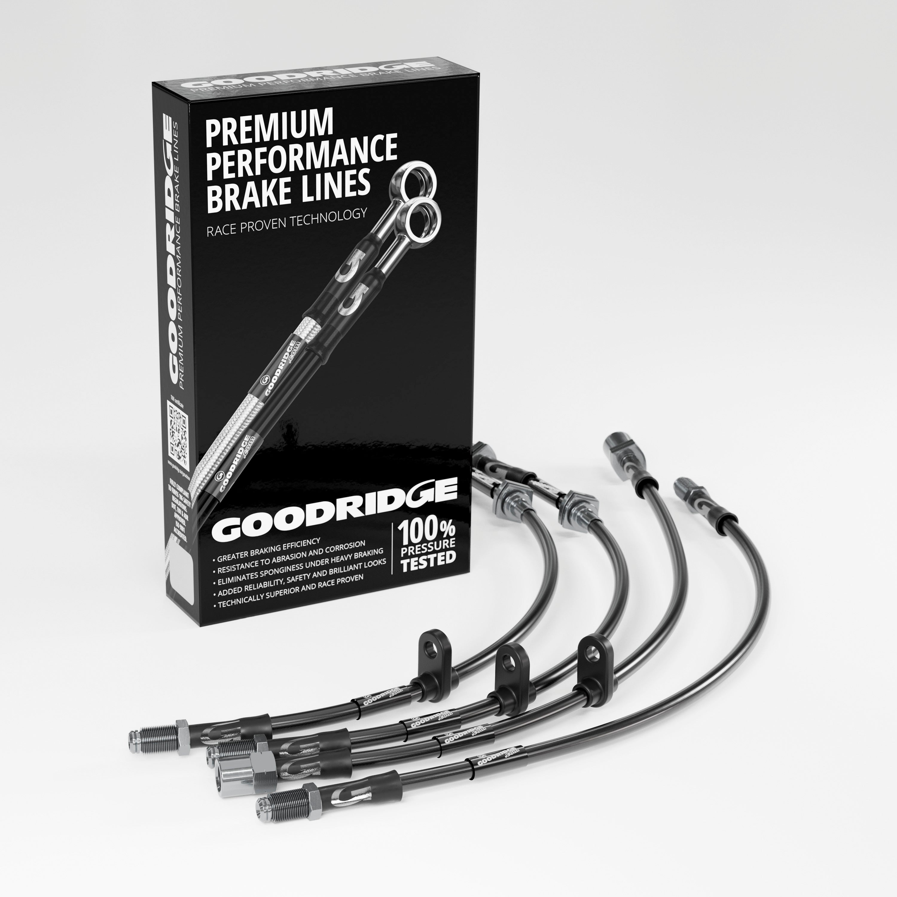

I was wondering wich is beter to get.

I wouldn't expect major differences. All these are fabricated locally by an external provider of Hel/Goodridge under their specifications of course. If I got a picture of the shop that delivered mine I'd be surprised if anyone would trust them for their brakes. :giggle:

Then i will go with Hell then, will order them tonight. Thanks by the way did you code your abs when you did the retrofit.
