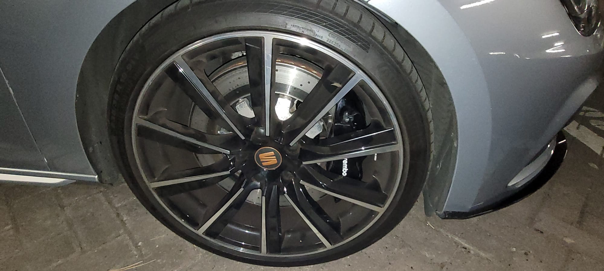

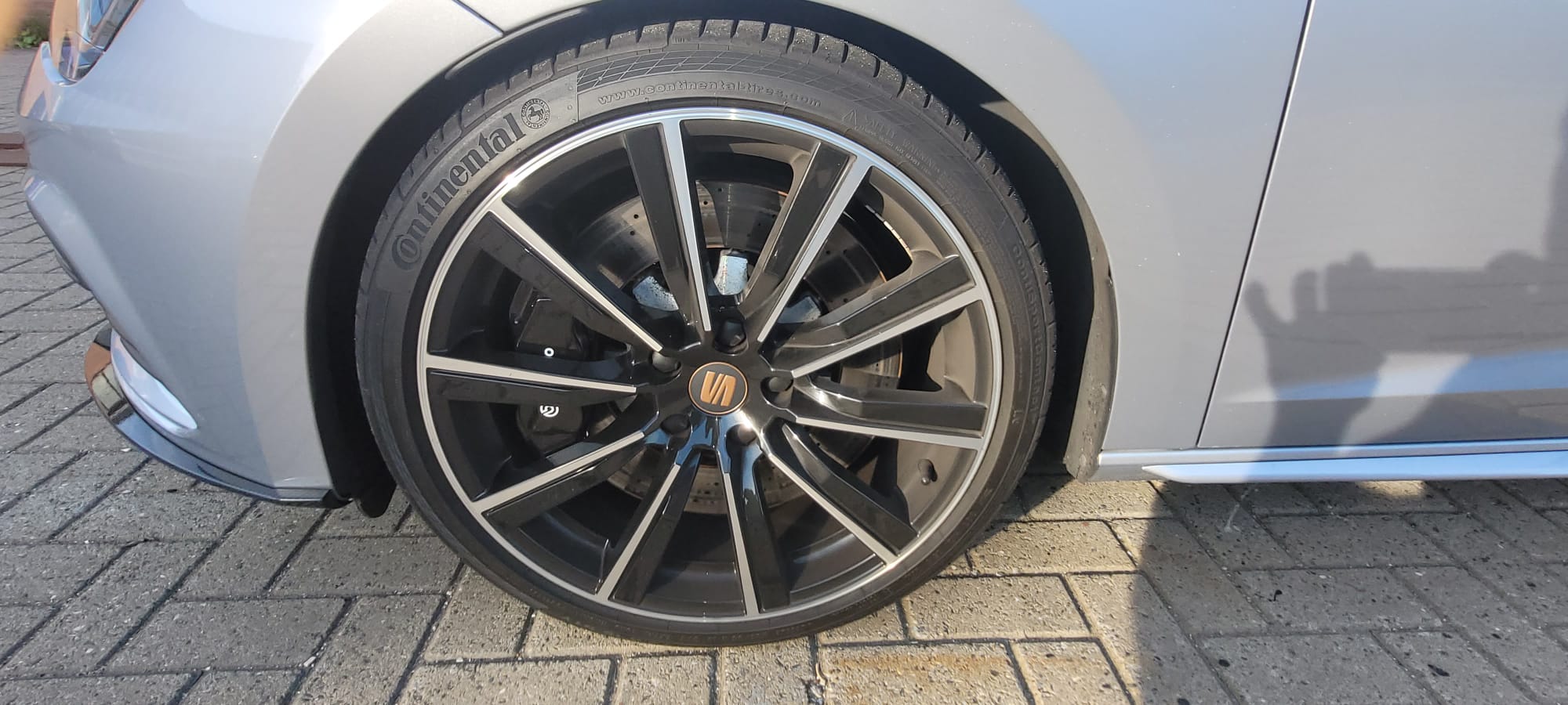

I rettrofit the brembo on my car last weekend.
all went oke.

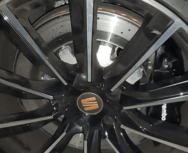

I notice a strange wear pattern - looks like the pad is only contacting on the inner and outer edge of the discs?
Hopefully after they are fully bedded it should disappear to a full shinny surface. Something to keep an eye on.
yeah correct still need to bedded them in, but they almost all shiny.
I also put perforated disc in the back from zimmerman.
