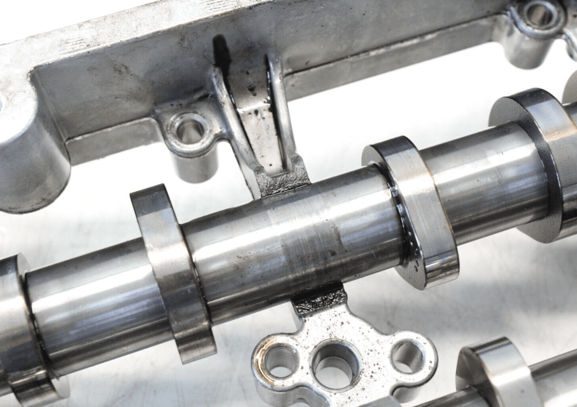

Are there any breakers that anyone knows of that would have a 2nd hand cam module or even the full top end?
There are a couple on ebay broken/spares - is this the same damage as yours?

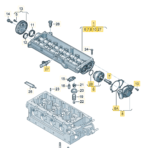

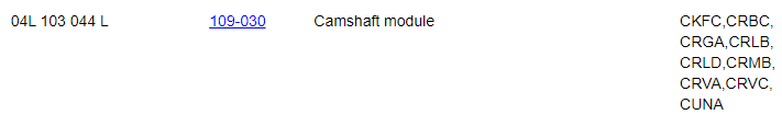

From what I can see the camshaft module for a 2016 CUNA engine is 04L103044L - listed around £1700! I would double check the correct number or are you referring to a different part?
#edit#
Just to add engine details of those engine numbers linked to 04L103044L - so the same camshaft module was used on 184ps and 110ps 2.0tdi. Might help searching for a second hand one. 1.6tdi is NOT linked.
CKFC2.0 TDI
150​
2013 - 2015
CRBC2.0 TDI
150​
2014 - 2015
CRGA2.0 TDI
177​
2016 - 2017
CRLB2.0 TDI
150​
2015 - 2018
CRLD2.0 TDI
110​
2016 - 2018
CRMB2.0 TDI
150​
2014 - 2018
CRVA2.0 TDI
109​
2013 - 2014
CRVC2.0 TDI
143​
2013 - 2013
CUNA2.0 TDI
184​
2014 - 2018
#edit# #2!
Amazingly the same camshaft module is also linked to EU6 1.6 TDI!
Seems the EU5 - EU6 is the only differentiator for the Leon, EU6 having an additional variable cam phasing.

#edit# #2!
Exactly the same damage. Theres 2 or 3 bits like that snapped.
