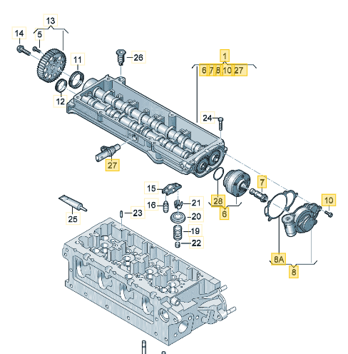

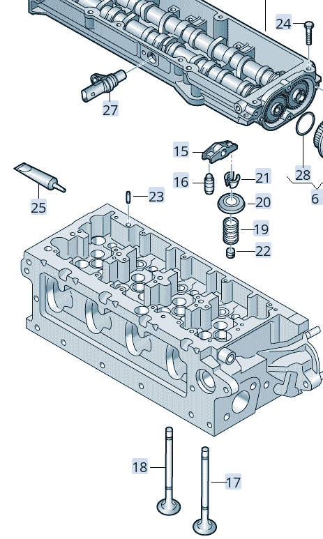

To be honest looking at SuperV8's diagram the valves are vertical and would have only come in contact with the piston once as it pushed them straight up and most likely smashed the rockers. Hopefully you won't even need a camshaft.
Thanks for the update!
On our engines the camshafts are assembled in a module is so cams aren't available separately; so a damaged cam = new camshaft module.
Valves and rockers all look like they are available - valves around £30-£40 each.

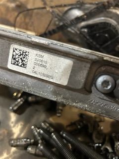

anyone know of anywhere selling one?
part no. 04L103292G for the CUNA engine.

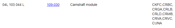

From what I can see the camshaft module for a 2016 CUNA engine is 04L103044L - listed around £1700! I would double check the correct number or are you referring to a different part?
#edit#
Just to add engine details of those engine numbers linked to 04L103044L - so the same camshaft module was used on 184ps and 110ps 2.0tdi. Might help searching for a second hand one. 1.6tdi is NOT linked.
CKFC2.0 TDI
150​
2013 - 2015
CRBC2.0 TDI
150​
2014 - 2015
CRGA2.0 TDI
177​
2016 - 2017
CRLB2.0 TDI
150​
2015 - 2018
CRLD2.0 TDI
110​
2016 - 2018
CRMB2.0 TDI
150​
2014 - 2018
CRVA2.0 TDI
109​
2013 - 2014
CRVC2.0 TDI
143​
2013 - 2013
CUNA2.0 TDI
184​
2014 - 2018
Reactions: Two90Black

i found a used one for sale but its from an Audi A6 with a 2.0 CNH engine. Part no. is the same but is there any way of knowing if the cams are different? Like cam profiles, timing etc?
Sorry just noticed the different part number you have listed. Its the same physical bit that you have in the photo. But my part no. is as I put above.
I can't see your number in any catalogue - maybe it's a component level part number? You could see if Seat/VW parts department recognise your number?
Looking at an Audi A6 2018 - I can see a CNHA 2.0 engine (not a CNH) but the camshaft module number is different 04L103044M which supersedes to 04L103044Q. Maybe the same housing part but some other difference?
