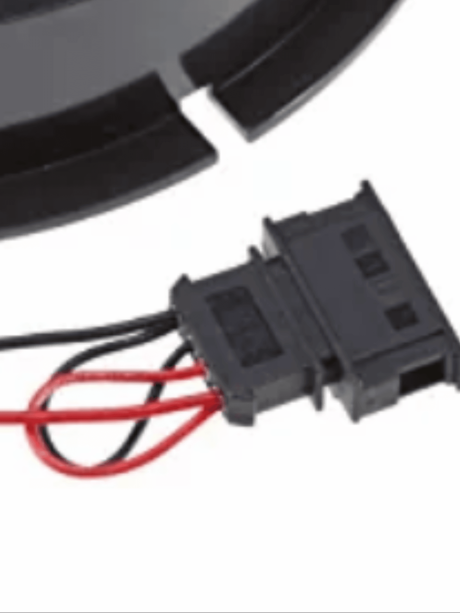

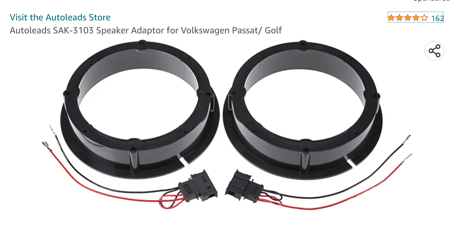

It's 14 years ago since I did mine but fairly simple. The adaptor kit one bought came with a plug so you just snipped the cable in the lead you bought which plugged in. You just need to silence the cars tweeter. No power to that. The lead from the amp is, as is, the crossover for the tweeter is out of sight. The mid range doesn't see the tweeters crossover from memory, so the power from the amp just goes into your new speaker crossover. I recall I did say which colour wire to snip... if the links still work. Will check other than that you'd have to work it out. I'm assuming they didn't change the Ateca speaker wiring from 2004.
Going over back posts since I think my key one is lost. This from Loadswine
Third pic shows autoleads plug and connections for new speaker with the crossover, and also the autoleads sak 3103 speaker adaptor in place after some surgery to remove the flange. I ended up just cutting the No. 2 lead to disable the existing tweeter.
It's lead 2... so we seek out the sak 3103 speaker adaptor pdf... basically as I recall the tweeter is wired in parallel so snipping that link in the lead supplied in the kit stops the power going up to it on one side.
Try digging around in the links but I reckon Paul's post has gone and Loadswine pictures aren't on the photo server so it's pin 2 from what he said above. You might be able to do it without the lead or buy that kit for the lead. Then it's just pull out, plug in and snip from memory. Suspect the pins are numbered on the plug or leaflet in the box. You might be able to use the adaptor mount but depends on your speaker. The adaptor fits flush. It was my birthday, brother gave me a hacksaw, so I got him to trim off the bit 🤣.
Tell
Full Member
Just to add to my post those speaker kits are still sold but whether yours fit into them or alternatives mention on the thread. The kit look like this:
So the cut wire is on one of those loops. Basically the factory fitted speaker takes that loom plug that comes into it. There is no crossover in it just feeds a connection out that is then passed up to the tweeter. In the adaption kit they sold for VWs for other speakers that cross wiring to loop back in to the loom is shown above. Those red and black leads go into your own crossover in your case. To silence the built in speaker without digging the tweeter out you just snipped the loop. Reckon we are looking at the one by the bottom wire. 2 being the next one down. In your case you are digging the trim out... or the other end.
The Infinity speakers contained the built in tweet which is front mounted above the bass / mid range so the desire was to knock that one out. Think the kit you are installing has seperate tweeters so your leads you need to go into your crossover from the amp are two two end point leads. The inner leads feed the built in tweeter.
As I said this was years ago... probably longer ago than what I said. To find the one to disconnect I reckon I touched an ohm meter on it and listened for a click from the tweeter. At that stage the mid range / base speaker was unplugged. Looking at that socket in the photo above it looks like the two extreme ends of the plug connections are the ones that go forward. The inner ones feed the built in tweeter. The loom splits further up in the car to do that. You will I suspect be putting your own cable in for your tweeters from your crossover.

So as I understand if I buy the kit you mentioned I will only need to cut the black and red loops, and then feed the two outer cables to the crossover?
My English isn't that good
Correct me if im wrong

It was just the cable to pin 2 but if you are taking out the factory tweeter it's disconnected either way. That socket connects behind the mid / bass speaker down the bottom. Goes in what you pull out of the factory fitted mid / bass speaker. Not sure whether you would able to use the plastic mount or not. You got the depth of the speaker to consider. Leave that one to you.
Anyhow that's how we were doing it at the time. The end of the tweeter lead also gives you the connection for your crossover. Don't reckon there is any crossover outside the speakers.
