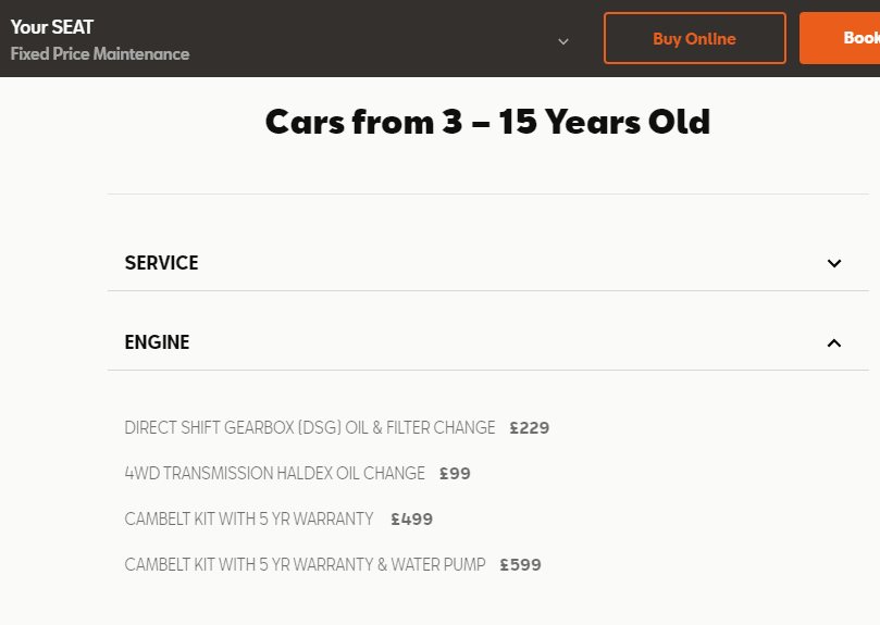

Mine needs doing as well. I noticed the fixed price from Seat was £500 or £600 with water pump. Does anyone know if Seat offer the water pump that doesn't have the moveable doodad that can seize or do they only offer the 'factory' one?

The main water pump is driven by the timing belt, look at this video at 23:00 in. I know there's another water pump on these engines (an electric one?). Are you saying Seat change the main one anyway for £500 but change them both for £600 or is the extra £100 to change the main one only?

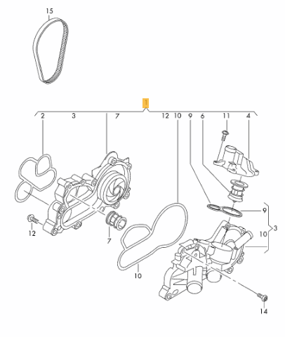

The original post is regarding an 1.4TSI engine - not our TDI's.
1.4TSI timing belt does NOT drive the coolant pump.
This is the coolant pump from a 1.4TSI - with it's small belt.

Sorry dude, getting my wires crossed regarding engine spec's :D. Does anyone know if the £500 Seat belt change for a 2.0TDI includes the pump then or is that £600?
