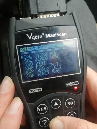

Got all these codes, car won't start turns over no problem, sounds like fuel pump kicks in with ignition.

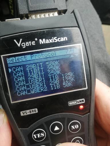

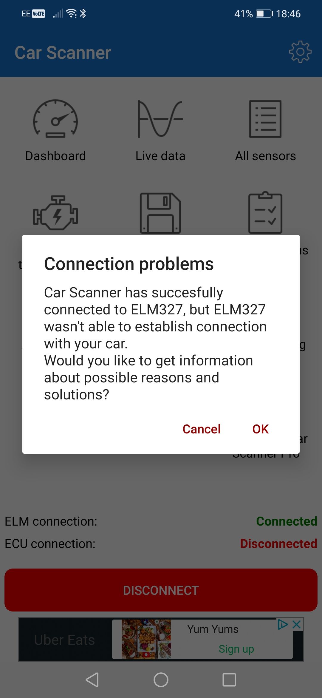

Got an oil light so I changed fluids alongside level sensor and sump plug, I've also fitted new oil pressure switch, but having no luck, I have the torque app and a few others as I bought an obd2 bluetooth device it connects but it won't connect to ecu. 2003 Leon Cupra.
Amazed, thank you guys, I'm going to charge my battery again and see what's wrong, I have no idea how to use these tools I just found 1 in a car I bought assumed it stored codes as my ep3 had alot of the same things appear.

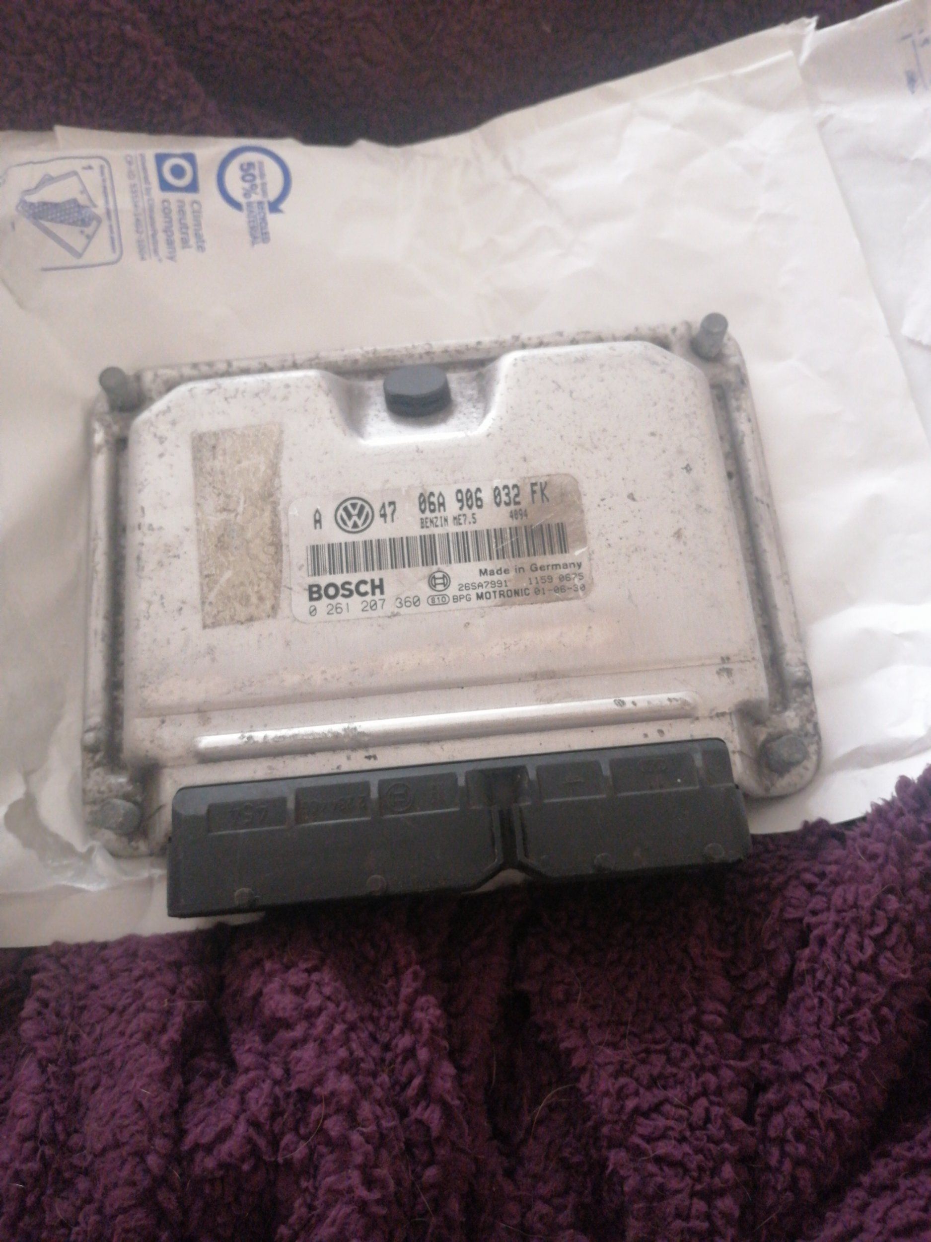

Well it seems after, oil pressure sensor, full service, fuel pump relay, fuel filter, crank sensor, oil level sensor, battery, plugs etc etc upon removing my ecu it was found that she decided to go swimming without her arm bands.
Sent away for some work to a lad in Norwich who will clone my map and immob settings and hopefully I'll be able to give her a lovely cruise next week.
