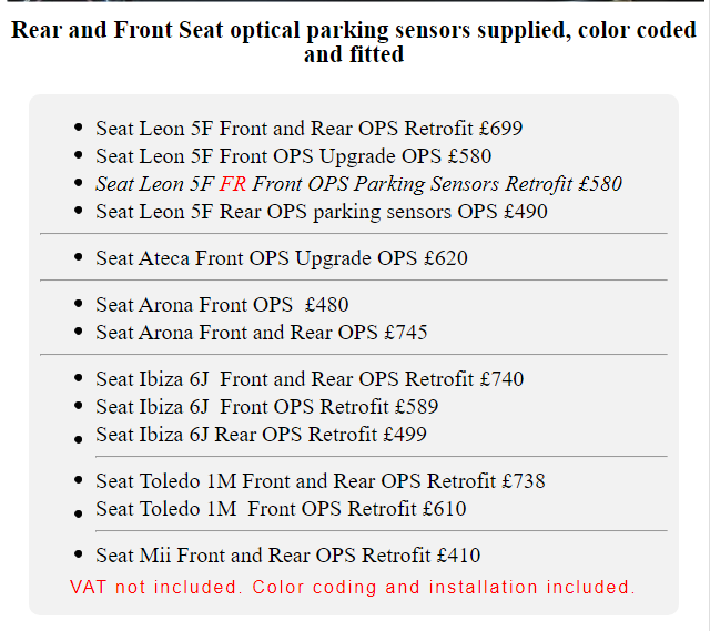

This is what you're looking for, but their service isn't cheap. They use genuine SEAT parts and includes the button on the console, shows on the display, etc. Exactly as if it was all there from new. I'm really want to add front sensors to my FR but cannot justify nearly £700. Don't forget the prices shown are ex.VAT!!
http://poollretrofits.com/seat_optical_parking_sensors_front_rear_retrofit/
