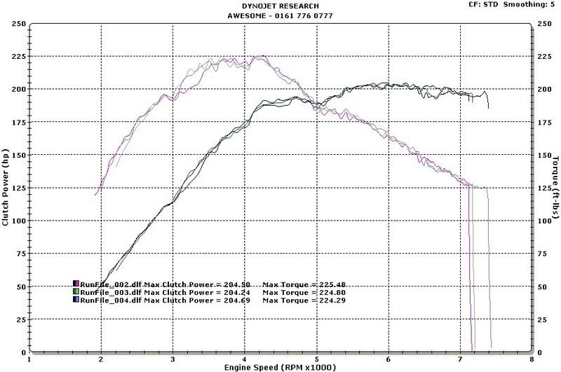

The only reason i piped up is because when mine was mapped with cc2 all he really did was put the boost through the roof to achieve big power when in actual fact it was running like a bag of sh1t so got awesome to put there beta apr stage 2 on and not only did it make more power but it lowered the boost quite a bit.
look at my run on there rollers with cc2
I'd say that for the mods that my car had 204 at the fly is piss poor.
My mods where: APR 3" Downpipe and full system, Samco TIP, Dynatwist, APR FMIC, CustomCode Remap
After awesome had put there stage 2 apr software on i was running 250bhp with less boost go figure???

the whole issue of standard MK2 cupra's running 260ish bhp is all a bit bizarre, some people have been to RR's and got bang on the money for stock figures while other have got anywhere in between.
I remember when the LCR was first launched people had them RR'd and the 210's came out at around 240bhp and the 225's came out at around 250bhp
take a still standard LCR to a RR now and it'll probably be nearer book figures, is it possible the RR's need adjustment for 2.0T or could it be that once the engines are run in the power will drop to nearer stock figures but the torque will increase?
BIGAR did you say your car had 256lb/ft at 6761 rpm? if so then the peak power should be 329bhp not 315bhp

power (bhp) = (torque (lb/ft) multiplied by RPM) divided by 5252
256lb/ft X 6761 = 1730816
1730816 / 5252 = 329.55 BHP
torque lb/ft and BHP should also cross at 5252 RPM on a graph if scaled correctly
not sure why the graph above from awesome doesn't
