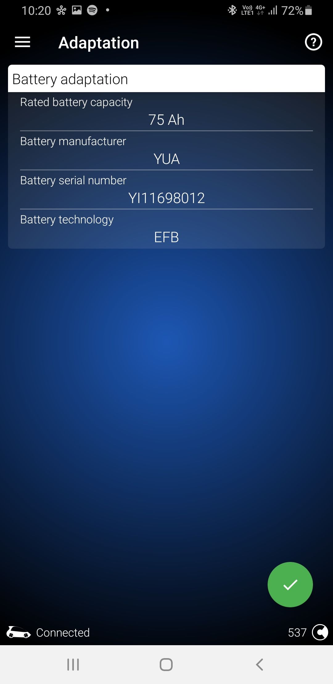

...also code the car for the new battery.
Yes, radio code is stored in the instrument cluster, will work even if you swap radios and then put old one back in. As soon as the power is restored, radio talks to the instrument cluster and grabs code from there. As @TheSwede also says, make sure the car is recoded to change serial number of battery, and also any changes to battery capacity and cranking output

Coding the new 12v battery to the car tells the car’s battery energy management (BEM) system the battery has been changed. The BEM system monitors the state of the battery and adjusts the charging rate as the battery ages. When you replace the battery, if you don’t code the new battery, the rate of charge applied by the BEM system will be at the level that was required by the old battery, which could shorten the life of the new battery.
So recoding the battery isn’t a dealership con, but buying a new 12v battery from a main dealer and getting them to code it to the car will mean you’re paying top dollar for the privilege.
