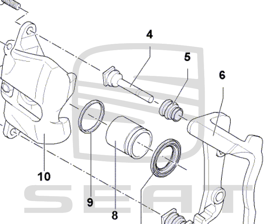

Have a question regarding the front slider pins, does any of you remember if the one with the rubber goes first from the top?
Thanks
Thanks
This rubber bushing is a vibration damper. I'm 75% sure :rolleyes: it goes in the top - but have seen others say it goes in the bottom!
It's all part of the NVH fine tuning of the OEM brake system - and I would imaging you will not notice any difference top or bottom with aftermarket pads.
This bushing's location is 'so' important there is NO mention of it in the Seat braking working shop manual!
All I can see is the feint line in number 4 pin below which I would 'assume' is the bushing on the top pin.
I remove, clean and replace one pin at a time so haven't noted where mine were. Can you check the other side?
#edit#
I have now found information that the rubber bushing goes with the LEADING pin - so backing up my comment above for the top pin on the Leon.
If the Caliper was at the rear of the axle - the leading pin would be the bottom pin.
Reactions: Zboro
The reason I was asking about this rubber bushing is that a month ago I changed the pads and discs on the front. After a week, I got an occasional squeak coming from the right side. It's driving me crazy. I went to regrease the pins but no change. I thought I've put them back the wrong way around. But yes, on both sides is the top one. Couldn't find any info in the manual too.

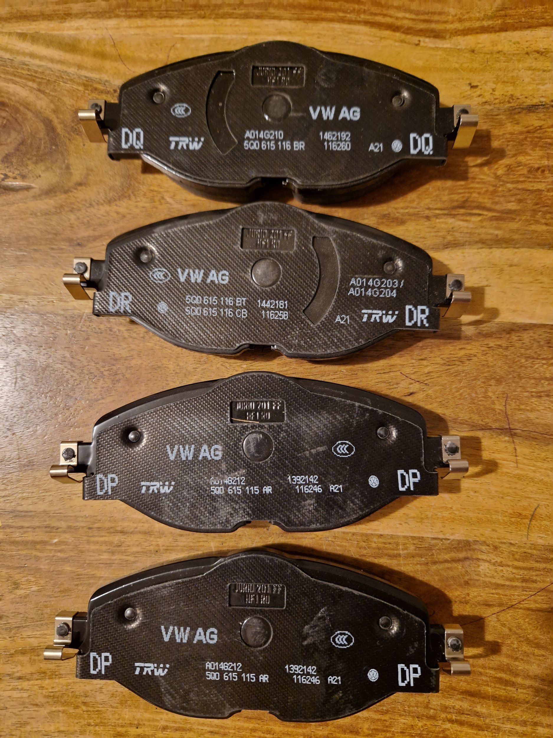

I got new pads at the end. Will put them on tomorrow. Do you know which way round they go; which side of the brake pad goes on the inside?
I want to make sure they are the right way in the first place.
The top 2 go on the piston side.
Im not sure which is which however but thats half the question answered
Bottom ones are the same so not important
