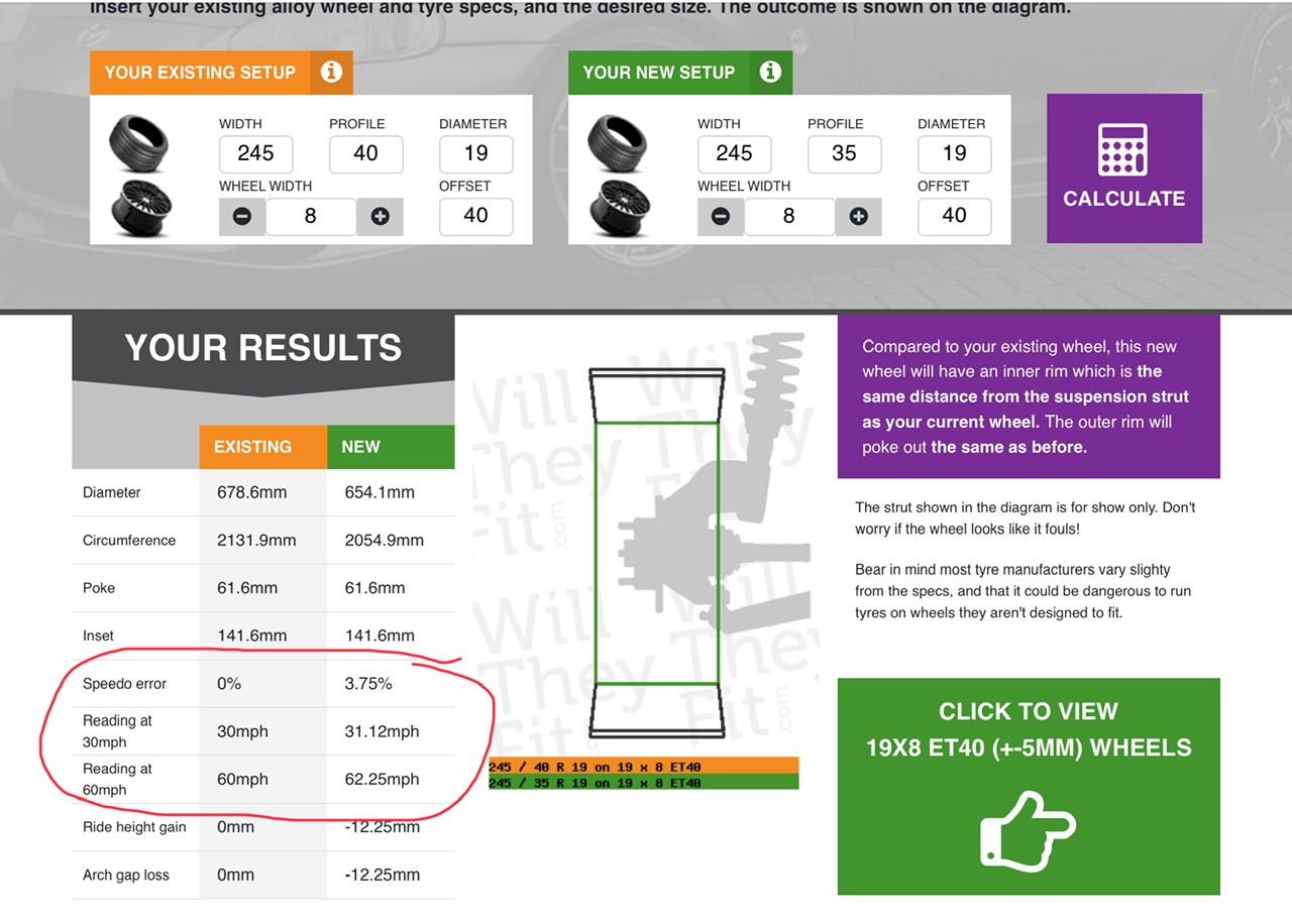

@Veralynn - don’t overlook the fact that there’ll be less cushioning effect from the lower sidewall of a 35 profile tyre compared to your existing 40 profile tyres, so your alloys might be at increased risk of impact damage (e.g. buckling and cracks) from potholes and raised or lowered drain covers. With 245/35 R19 tyres, your speedo will also under-read your car’s true speed by just under 4% - probably not enough to be caught by speed cameras or stopped for unknowingly speeding, but bear in mind in the UK it’s illegal to have a speedo that shows less than the actual speed being travelled - see article at the link below, in particular the section headed ‘The law for car speedometers in the UK’.
Much appreciated, probably the answer I needed to sway me into keeping 40s, as I said earlier the existing just look wrong without the rim protection on the tyre.
