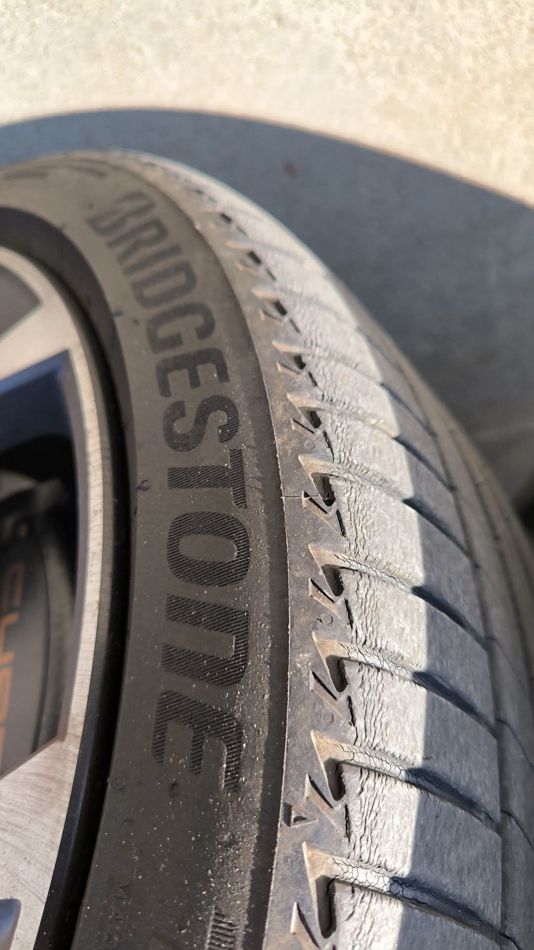

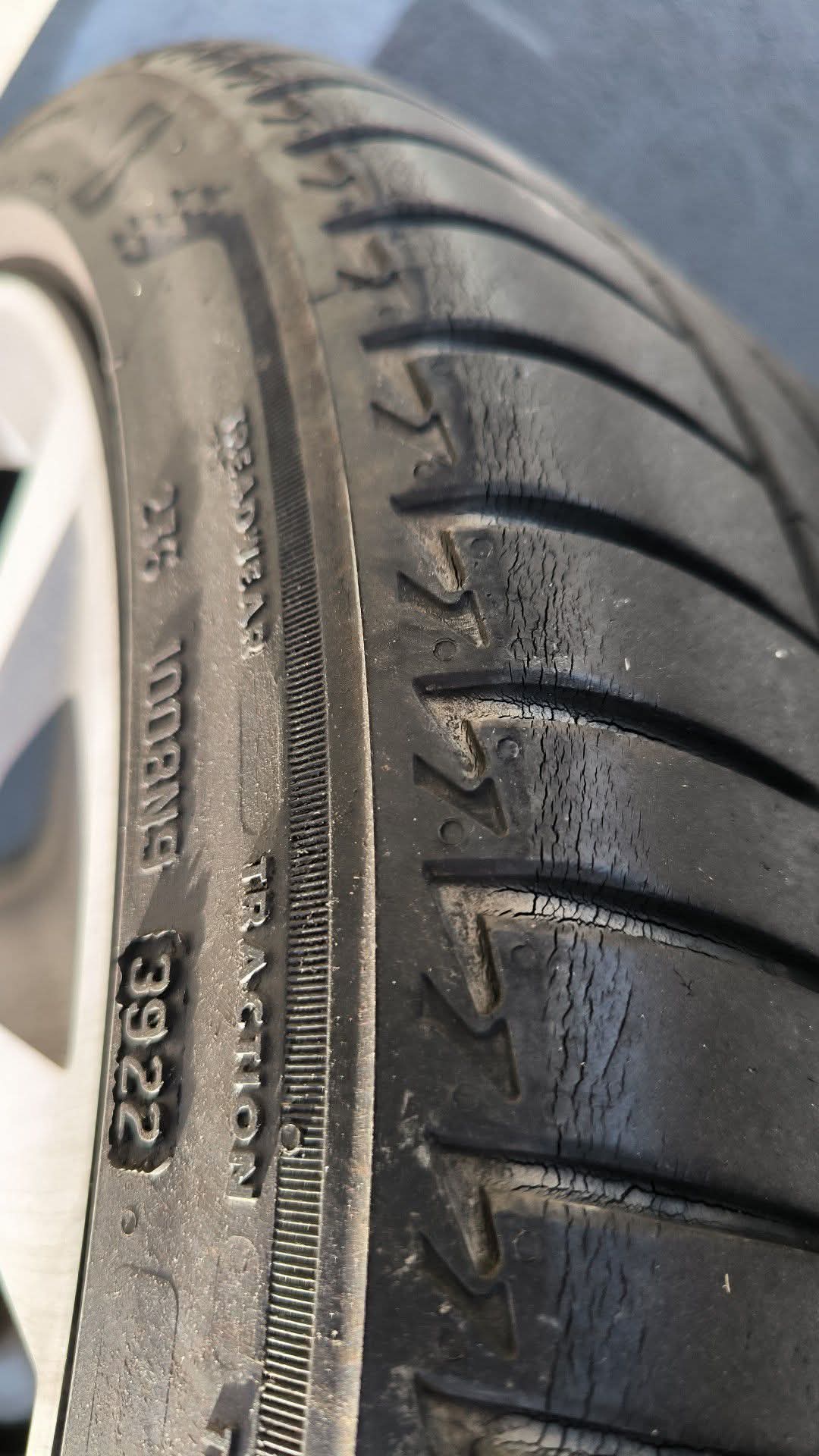

Hello. Maybe someone knows, what happens with my tires ?
( Turanza. Made in Poland)

Can depend on a lot of factors. They don't seem excessively old at 4 years.
Possibly bad storage conditions combined with heavy driving during hot weather while also possibly under or overinflated.
If you keep them outside in the winter instead of in a garage or in general a somewhat temperature controlled environment it can cause this. I keep my summer set indoors during winter since I have the space.
There's always the danger of counterfeits if ordered cheap from an unknown vendor as I believe there is a market for that.
As you are from Estonia like myself then I doubt the summer heat has much to do with it ⛅

Four years old; rubber is getting old and hard.
Classic sign is the cracking you have got.
Time to replace.
