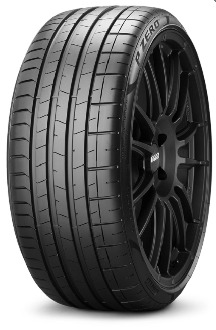

I’m not familiar with modern Pirelli tyres; the last time I had a car fitted with Pirelli’s was over 40 years ago back in 1982. Customer reviews, and links to group tyre tests that included Pirelli’s P Zero PZ4 can be found at the link below;
As to whether or not 245/40 R19 tyres will fit your car; I don’t know what size tyres Cupra fit to your specific model of Formentor in the factory when it’s built, but when replacing tyres I would always recommend fitting tyres that are the same specification (width, sidewall height, speed rating, load index) as those that were originally fitted to the car - that assumes you’re not changing the wheels to a different size. Depending on your country, be aware that fitting tyres of a different size and specification to those originally fitted by the car manufacturer might also have insurance implications, although that could depend on who the insurance company is.
At the link you’ve posted, clicking on ‘L.S.‘ it states it’s the Luxury Saloon Version of the P-Zero PZ4 tyre. I’m just guessing, but maybe the sidewalls of the L.S. / Luxury version are a little more flexible than the sidewalls on the non-L.S. version (assuming there is a non-L.S. version) and so may give a slightly softer ride. The trade-off with softer tyre sidewalls might mean less responsive handling though.
XL on a tyre sidewall means Extra Load, which means the tyre sidewall is reinforced and designed to carry heavier loads than non- XL tyres of the same size.
