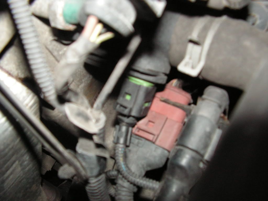

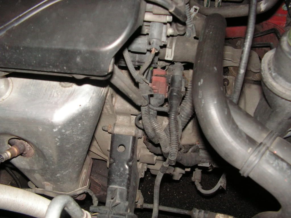

this is the area next around the senser its just right of the air box on mine
in this one you can see the green senser
and please don't laugh at my baby engine

On the up side it was the temp sensor pictured above and everything seems to be sorted so thank you everyone!
