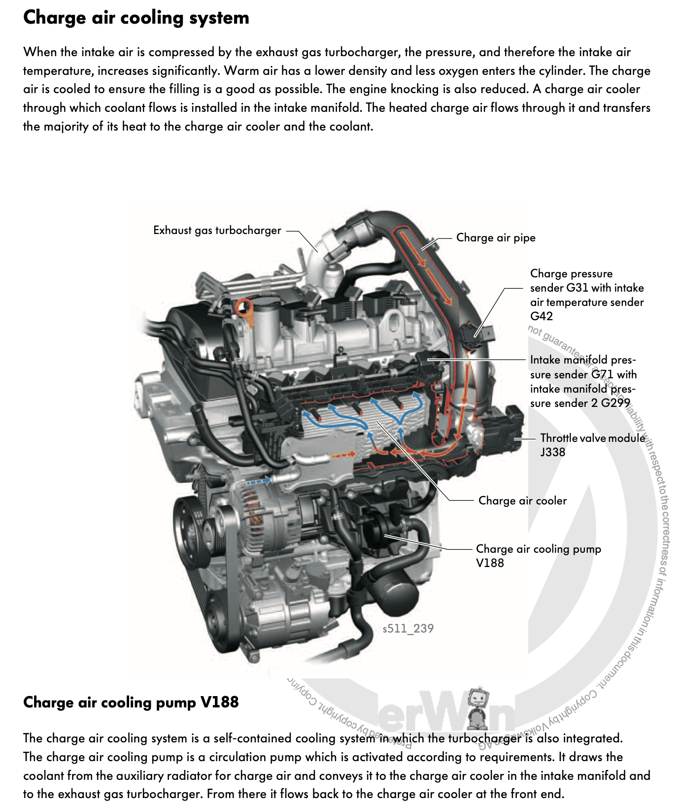

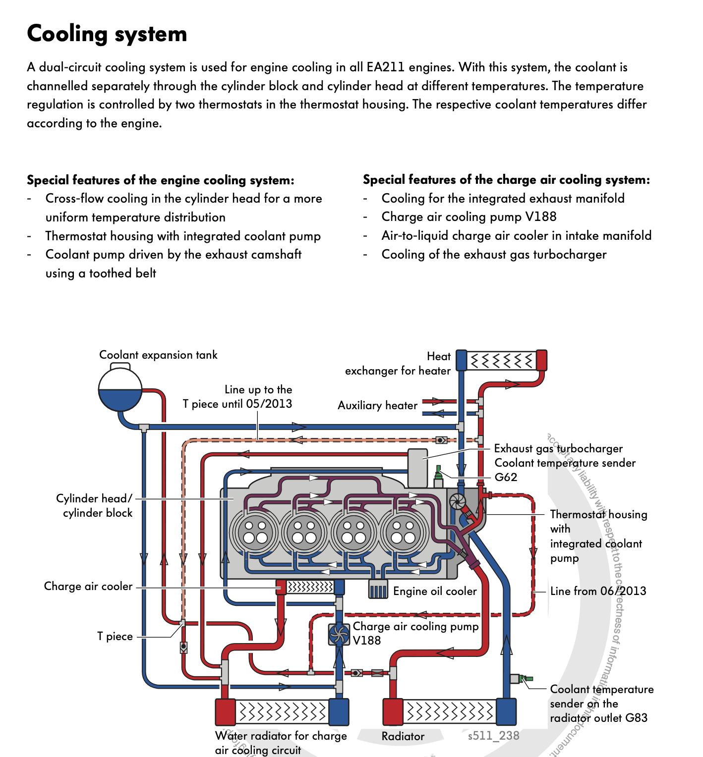

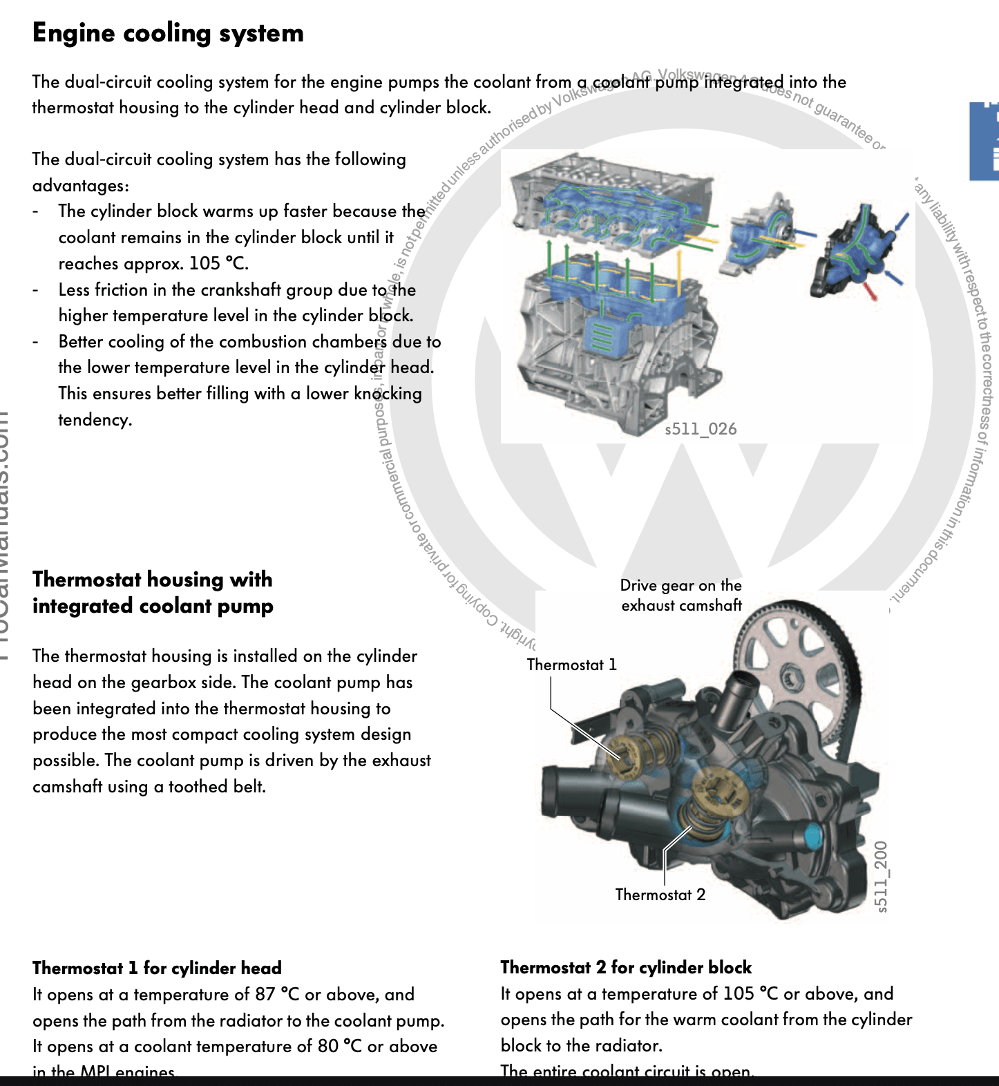

Wondering if anyone can help me find a layout of the coolant system on a CAVE engine believe I know where it is but just trying to work out a game plan to get it

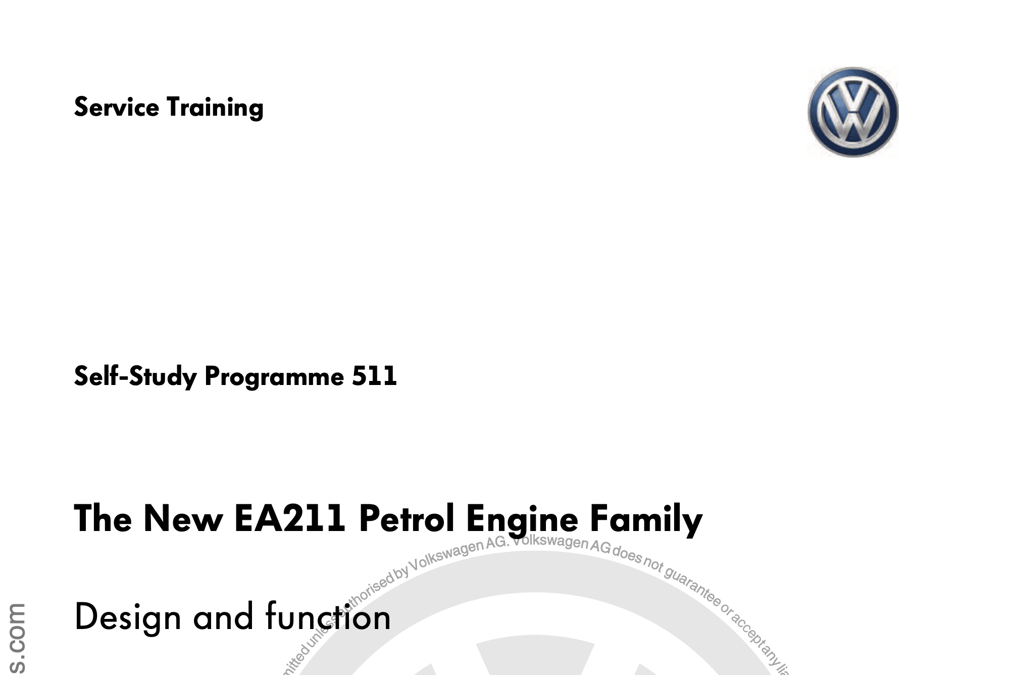

I have posted the document for the EA211 engines, which I think the CAVE is a variant of ... I haven't dug too much into the engines themselves as I just purchased the car. Just doing some reading and seeing ho wit differs from my EA111-powered Golf (in some ways a lot ... in other ways very little.)

Thanks very much I found it after hours of searching
