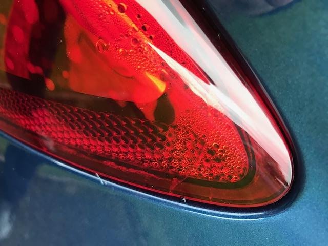

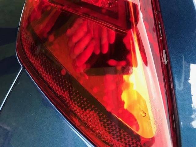

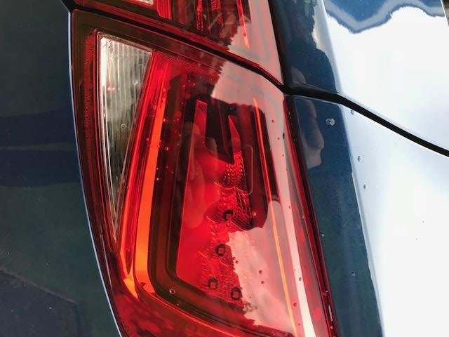

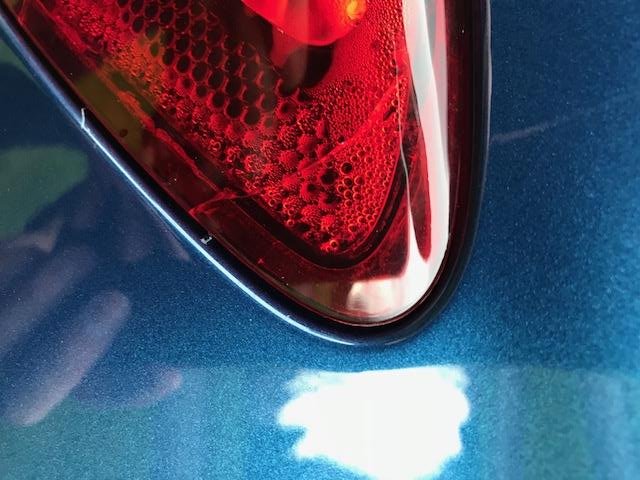

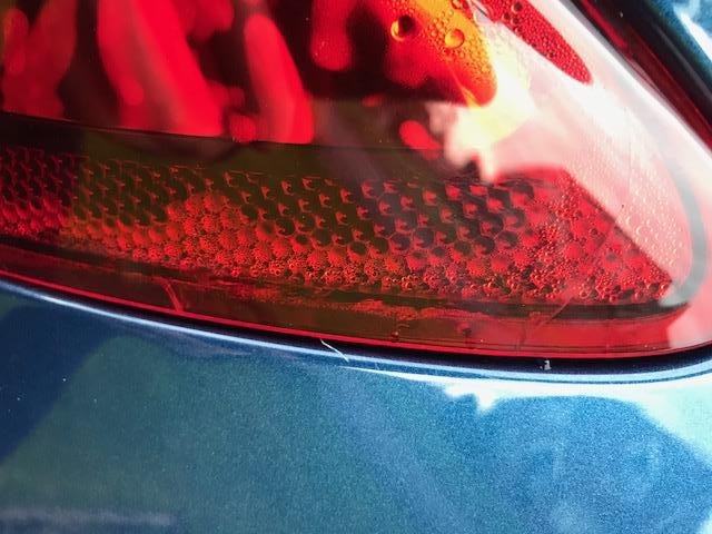

I've attached a few pictures of what the crack and subsequent condensation looks like on my rear right tail light.

I had the same problem in both rear tail lights which had condensation and after reading the thread here I decided to take my car to the dealers as I am still in warranty. They had a look and said that they will change both of them under warranty which was done last week. Apparently when the cars were built these lights were over tightened which created a stress fracture in the corners which is the weakest point. I was told these new lights have been made by a different manufacturer so should not have this issue again fingers crossed!!
