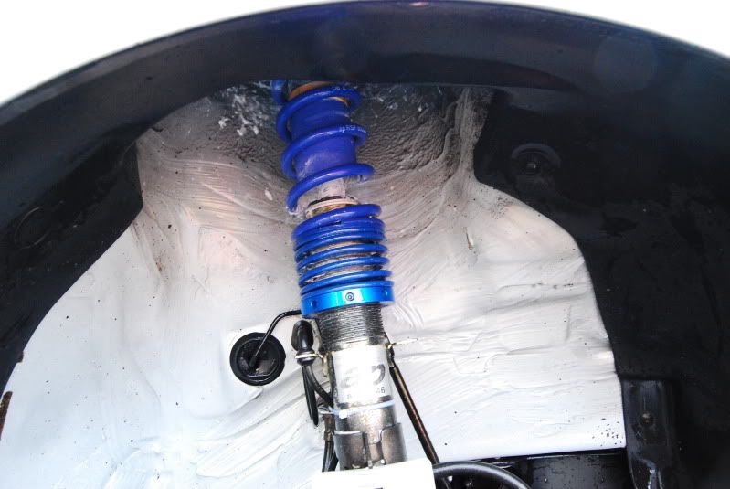

Working in the Arch:
Squirted it all at the top of the arch, where the top mount fixes to the turret, getting the topmount bearing etc.
I squirted the damper piston (shiny metal bit) where it goes into the damper body
Finally, into the area where the coilover height adjuster plate is, so I can raise / lower the front without having to fight with seized parts.
The white blobs in the photo is white grease, you can see where I missed and got it on the underseal / paintwork. I wiped all the excess off before refitting the wheels etc :)
Aye, I thought about that when I was doing it.
The struts have dust covers over them (blue cylinders in the pic) which will help, but the dampers have seals in them to stop dirt ingress. I clean them regularly now as well which includes a re-lube (once a month) so that will help keep the dirt and muck away. It's not a daily driver so it shouldn't get too bad (he says!)
