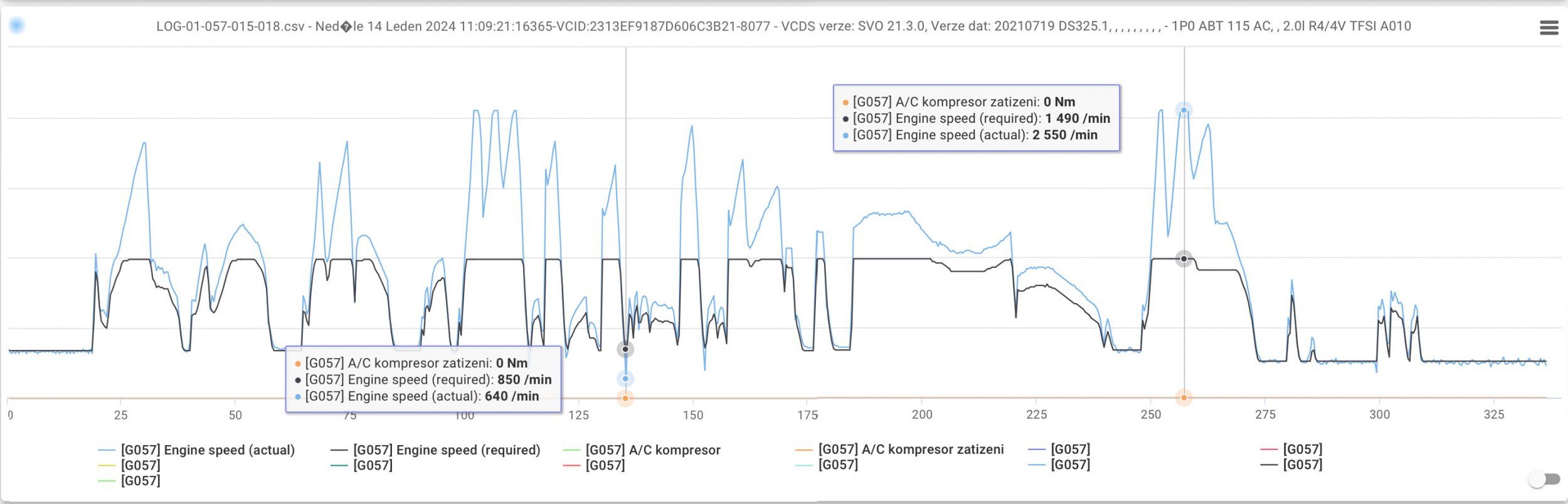

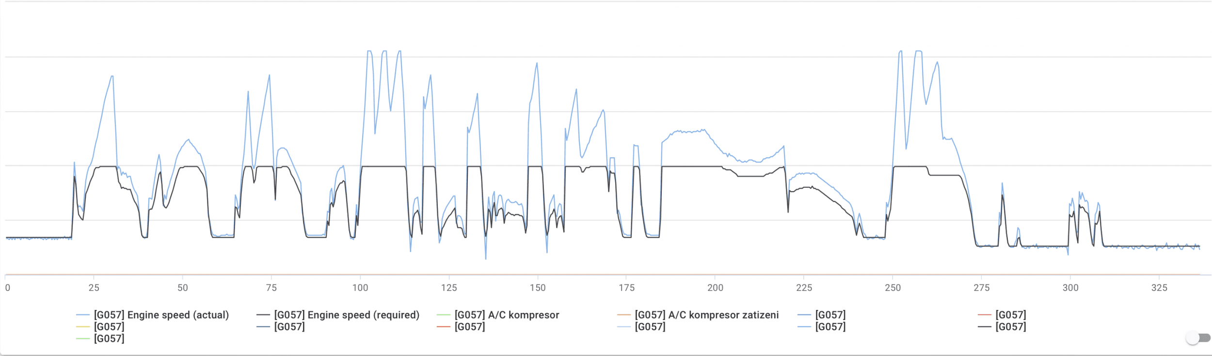

I added two videos. When the car is driving. And when the car is stationary. I also added a short vcds log. Go kiksu.net/vcds-graph/ and see the log.

I would be checking there are no air leaks after the air flow sensor. As I had bouncing revs one time and it turned out the intake pipe had come loose after the air flow sensor spoiling the air the engine thought it was getting.
