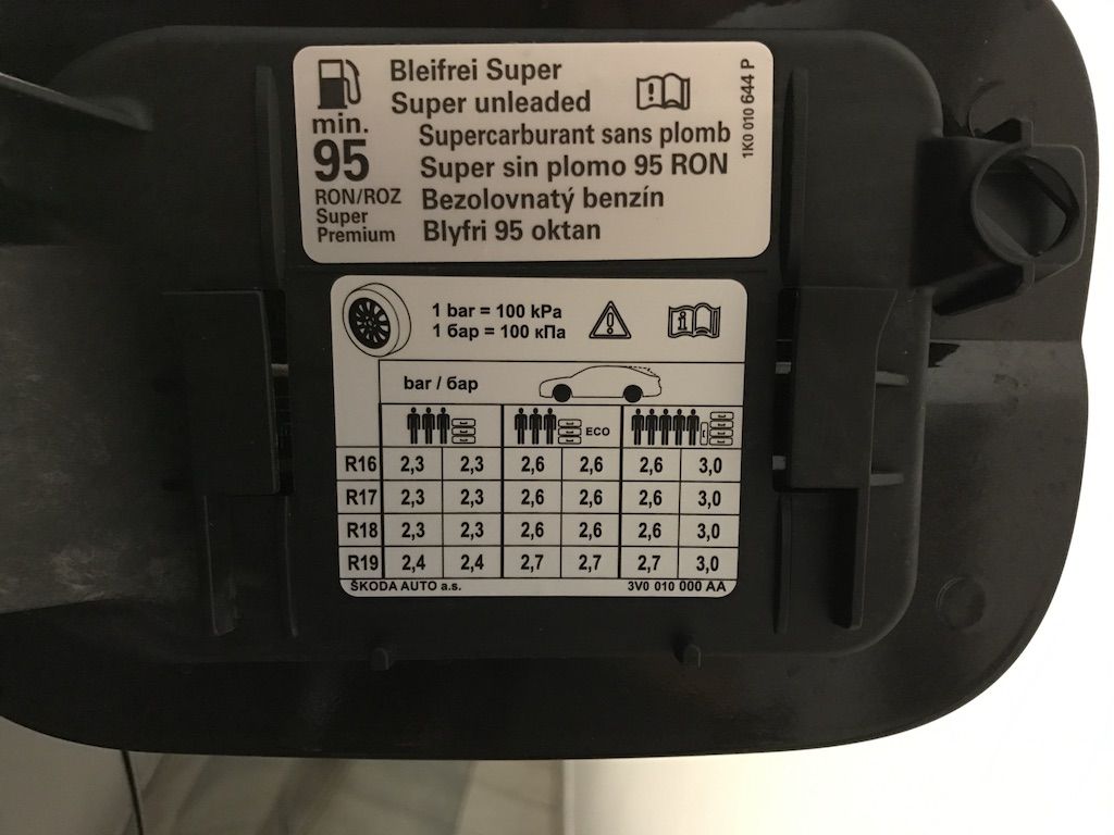

Something like this
95RON E10 is perfectly fine ( at least here in Germany is pretty good).
Getting a better fuel will help to get better timings , so more power but it will not damage the engine. The SIMOS ECU is capable to keep safe the car pulling less boost and timing if the fuel is not good at all.
In the worst case you will get less power.
Hope it helps
