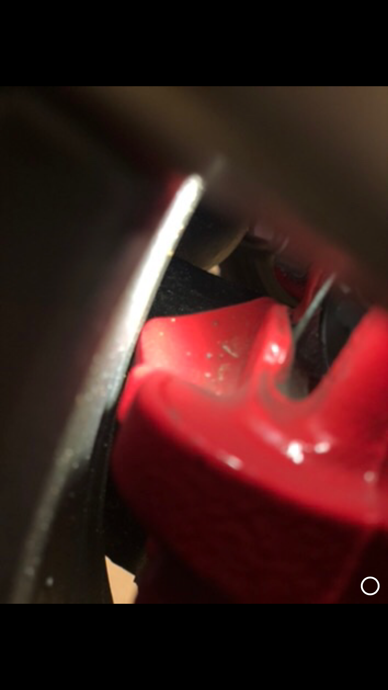

17” wheel clearance in rear, this caliper is also a close call.
