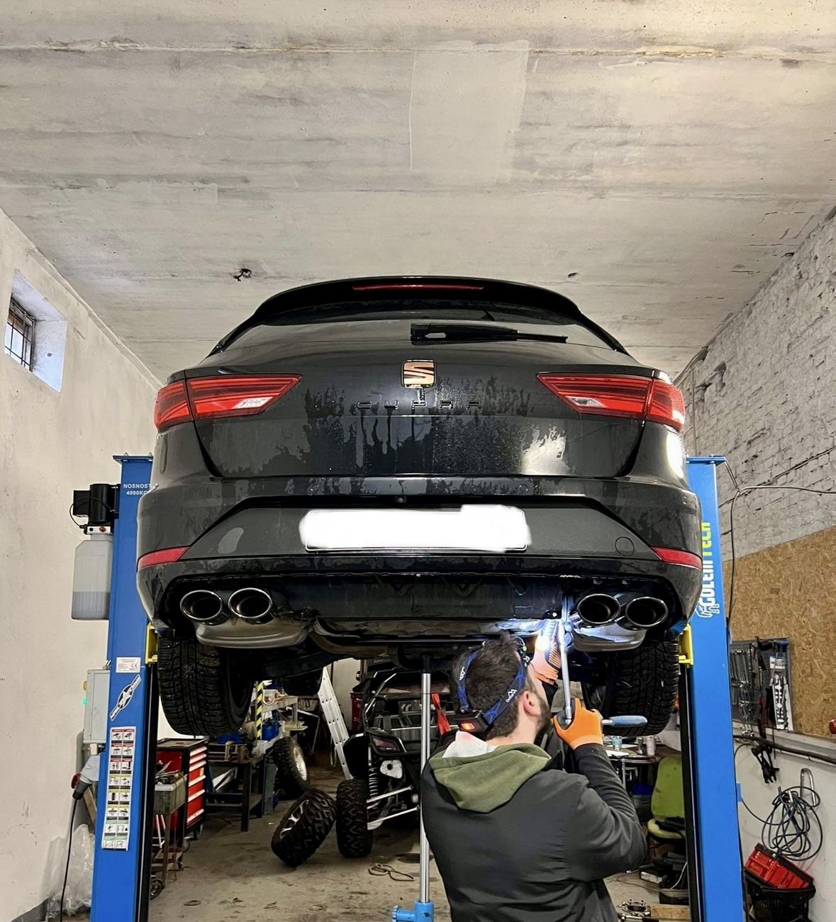

Quick update on getting both back boxes opened up and gutted on my mk7.5 golf estate
Fabricators done a fantastic job welds are excellent can’t tell the exhaust has been modified
But there is zero noise difference not even on cold start or higher up the revs no dsg fart nothing!! so just goes to show the gpf are obviously silencing all the noise

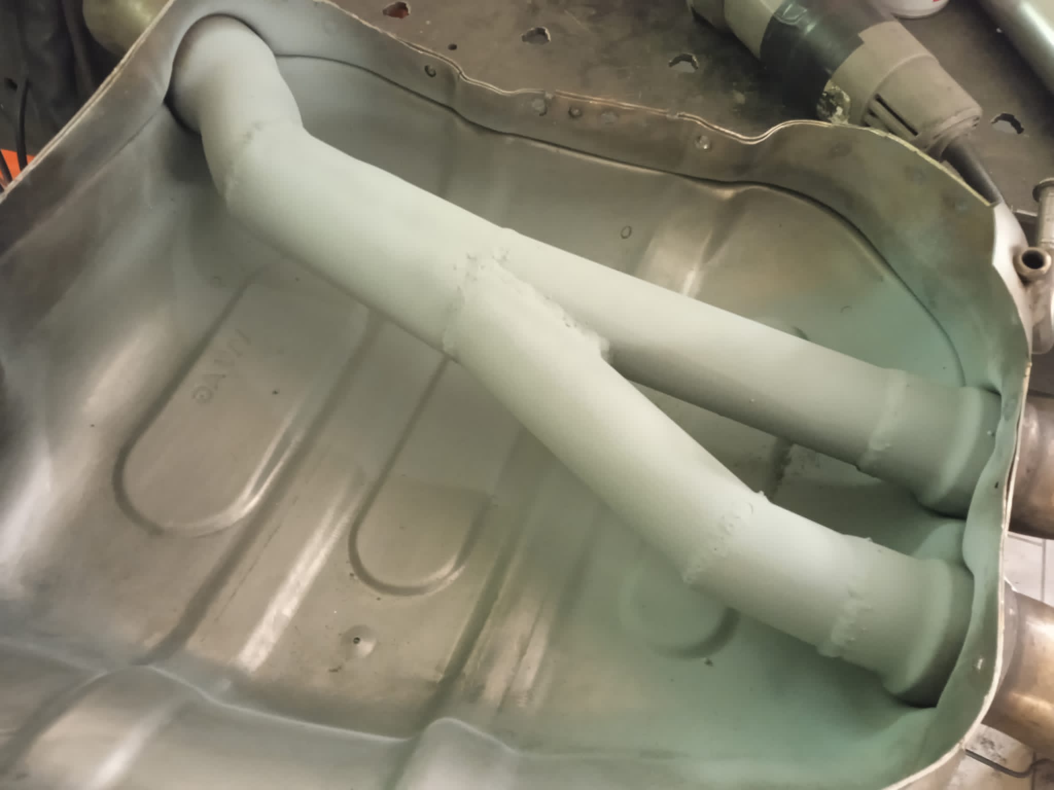

Hello guys,
I just switch Cupra R exhaust on my ST 300 with OPF.
R exhaust has deleted res, sounds great but too noise the interior, any tips? 😄
Thanks
Feb 23, 2023
Is your car OPF or non-OPF?
It is ok to have Res delete with OPF, but as you found out, without is bit too loud
I Have OPF, this exactly
second picture is cut out from rear silencers
Feb 23, 2023
Wait... You removed that section that is on the second pic???
The OPF is still on car :D the rear silencer are straight piped :D the first option was to remove the damping wadding, but I went the route of completely taking everything off.... Only it's a bit noisier inside the car, I'd need to adjust it
