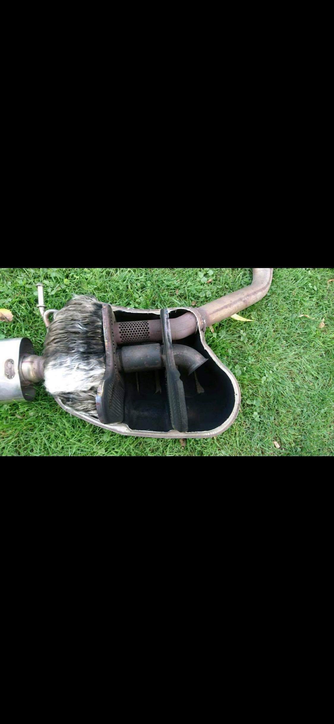

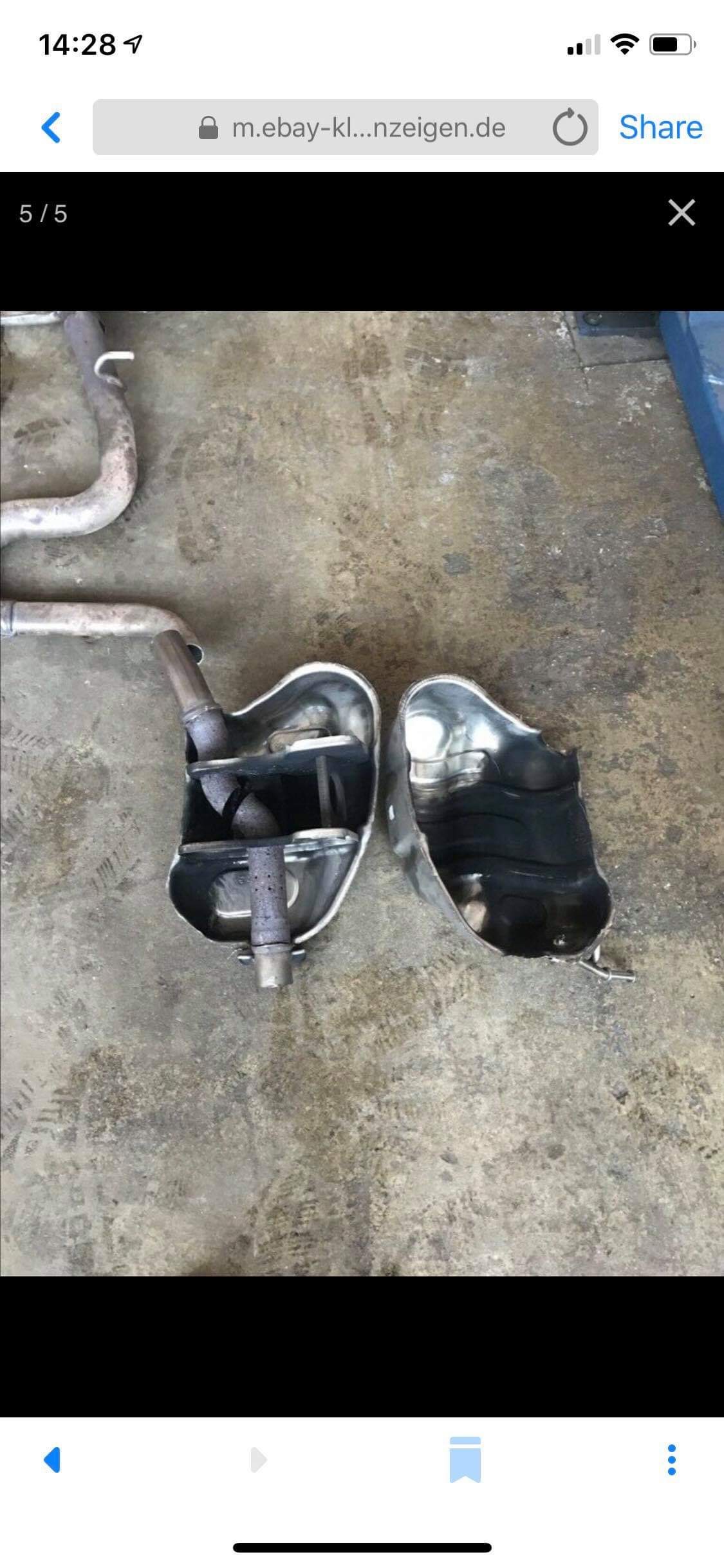

Exactly, ive seen the cutted pictures from the internet and they are way different from the inside. Ive used Clubsport S muffler on my GTI and they were also sounding so different and so was from the inside.
Found them from the internet, showing the difference between the Cupra and Golf R muffler difference, altho the outside look is the same.

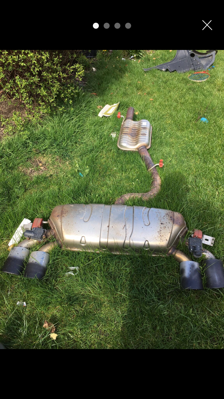

Hi does anyone know if the golf r hatch exhurst fit the Cupra 280/290 ? As I have the full exhurst off one
I only know that the GTI one was a straight fit to a Cupra hatch. For the R muffler, it may fit otherwise, but you shure have to cut the diffusor for the tailpipes.
Cupra R hatch has a golf GTi system, so space and hangers are good.
But you have 2 issues with the Golf R system.
Tail pipes are overall bigger. Each pipe is 100mm wide, with a 10mm gap, so 210mm overall. I think the Cupra is only 120mm.
Golf R system is valved and plugs into the car for opening/closing the valve depending on driver profile.

So main issue will be defuser and it sitting with in defuser and not in to the bumper we’ll i can only give it a try I don’t mined cutting defuser but not in to the bumper
Yes, pretty shure you only have to modify the diffusor itself, like i did on my ST.
I see the harder part of making the flaps work or at least turn the flaps into always-open position.
I will turn them to they open and fix them to stay open I will take pictures as I go with it

It looks like you still have the motors attached. Most aftermarket systems for the Golf R, require the original motors moving onto the new system.
All you’d need is the wiring loom from the exhaust to the car and then coding in.
