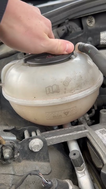

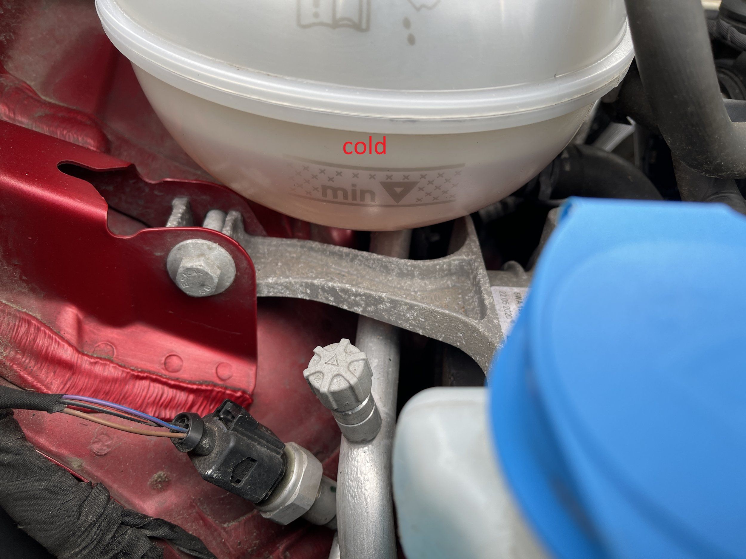

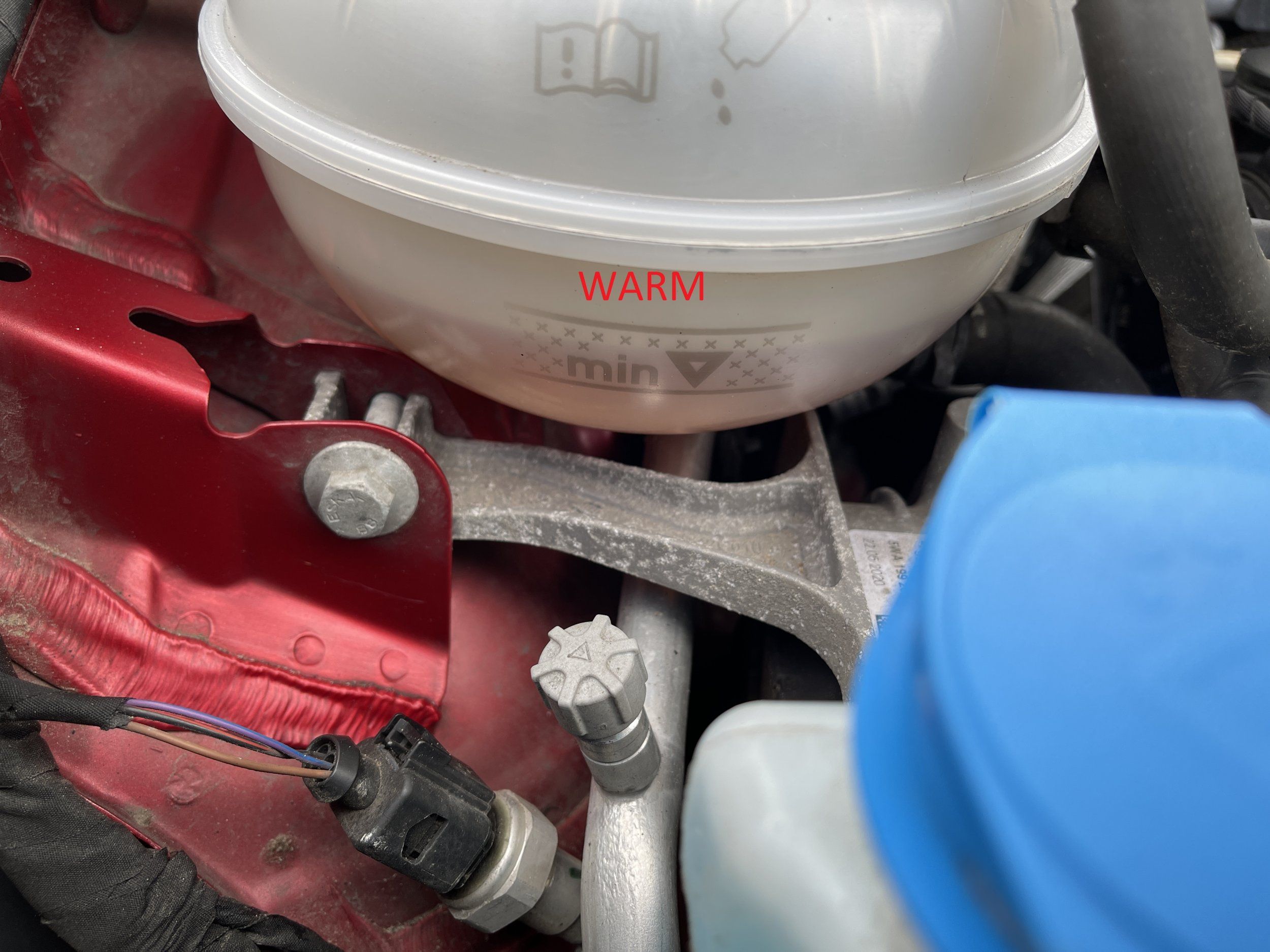

Do these pictures correspond with yours? I just always thought coolant expands when warm? Would love someone to look at there and confirm this is indeed the case.

please check if its not too much trouble. Im under the same impression as you and all previous cars iv owned. Coolant is a little higher when warm. Not a little lower. Iv posted some pictures in my previous post. Also another member has posted saying his does the same. If you could also confirm if yours does this or not that would be very helpful!
I will try to get a couple of photos next time I use it. Maybe tomorrow, liquid lunch today so the car stays at home ?

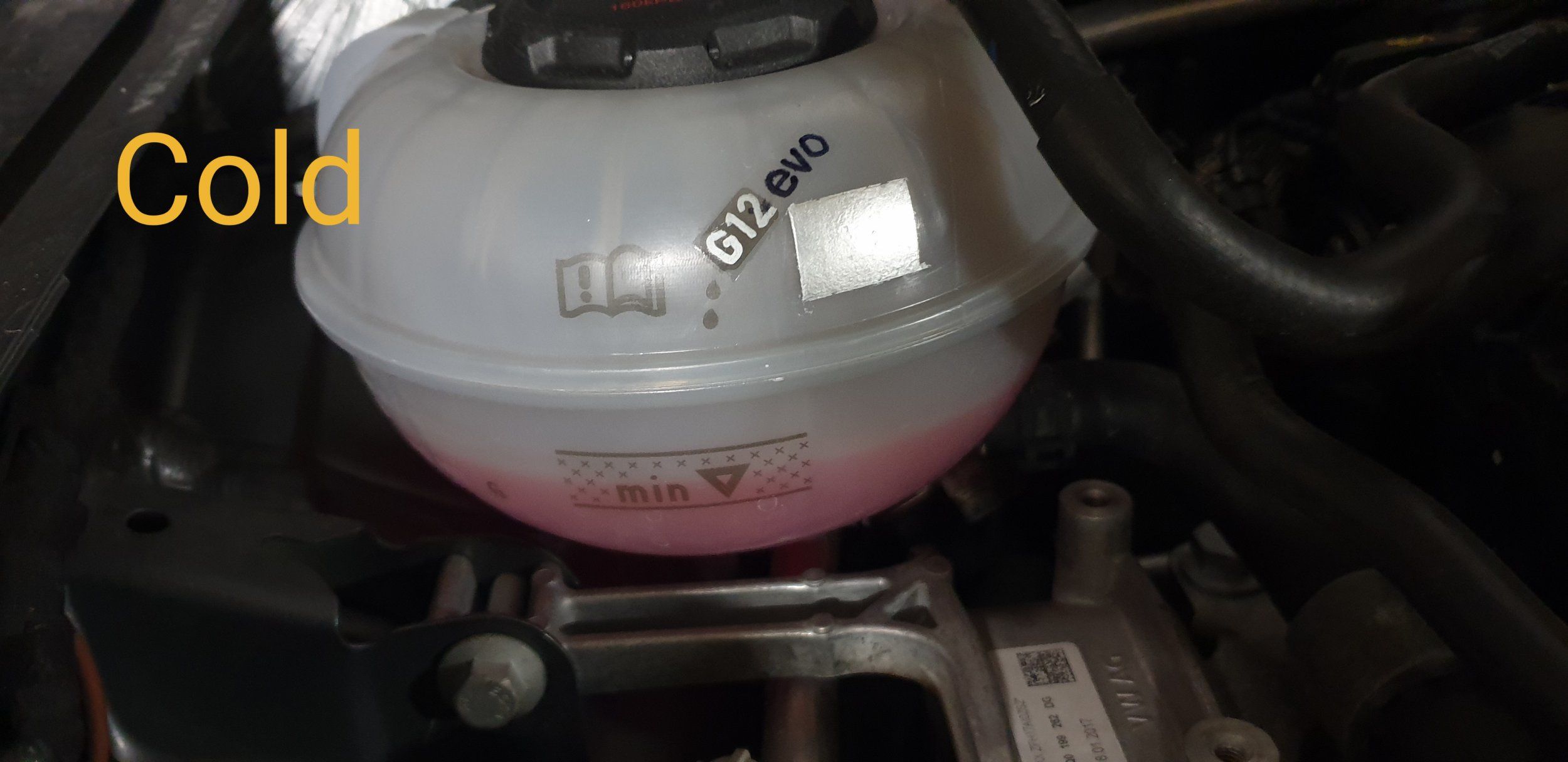

I will take a pic of my expansion vessel today cold/hot. Will get back to you.
It is a Seat Leon mk3 Cupra R 2018, 310 hp. As standard one extra cooler on the right side (sitting in car) in front of the wheel arch. I dont know if just some Cupras have it. My Mk7 Golf R had it. No fog lights, no room on both of the mentioned cars.
Much appreciated mate. Legend!
Im unsure if my Cupra would have it. However it is the 2020 model so if some Cupra's have it, i imagine mine would have.

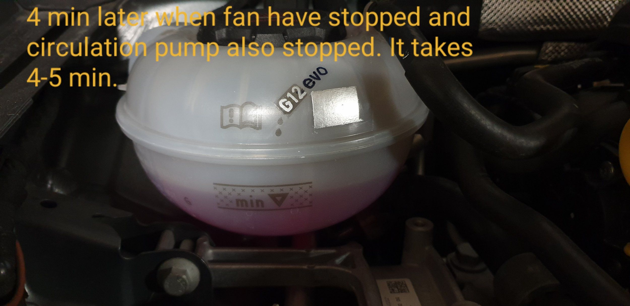

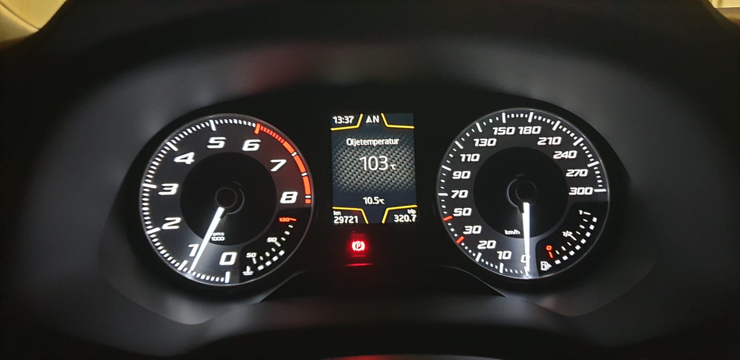

The pictures are from the same ground conditions, my parking lot in the garage.
Cold= 12 c today. About the same outdoor temperature.
Hot =After a 20 km drive just after ignition turned of.
A little less coolant than "cold".
Hot last pic= About 5 minutes after ignition turned of. The electrical circulation pump take 4-5 minutes to shut down. You can see if there is coolant the filler hose on top of exp vessel (pink before it closes down).
Slightly more coolant than "cold". Very little diff..
Thank you for taking the time to do this, so it might be looking like this is completely normal.
